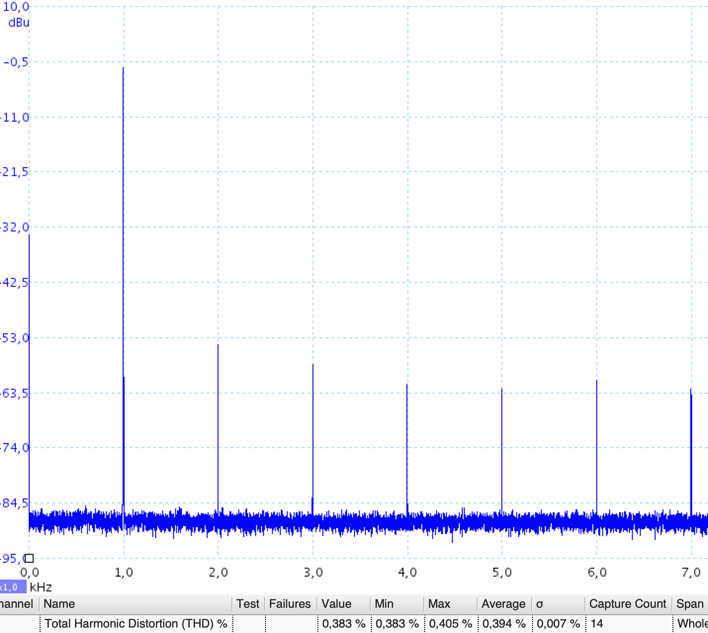

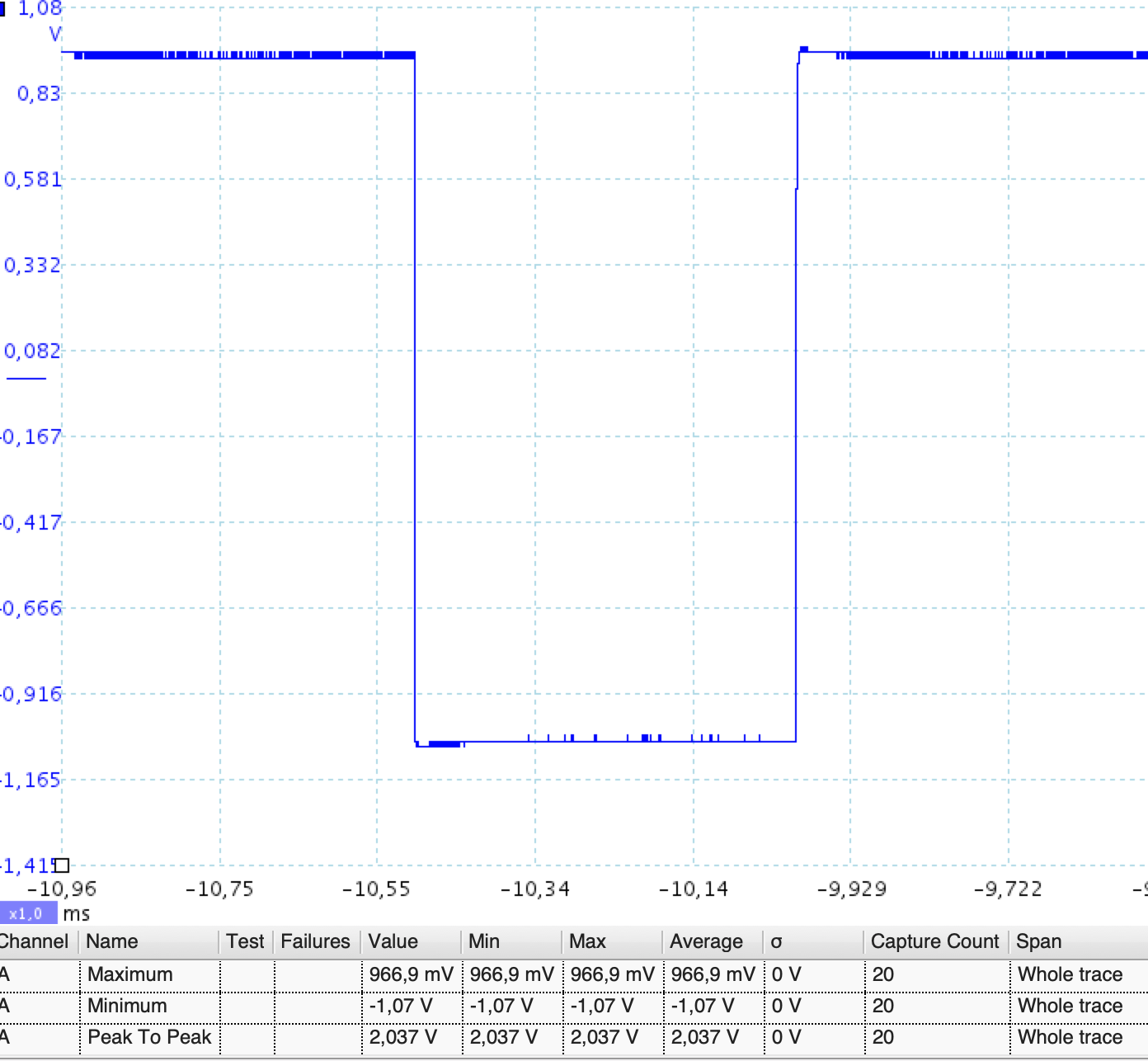

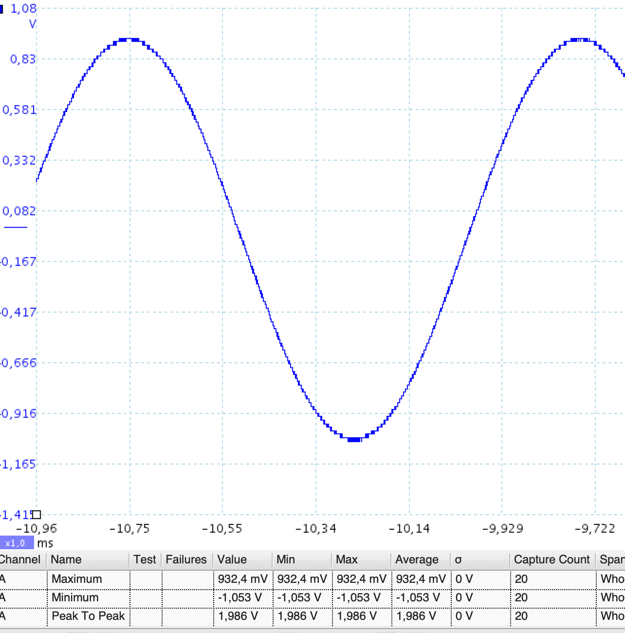

Aiming for 1volt as in the build guide. Is it safe to increase bias?

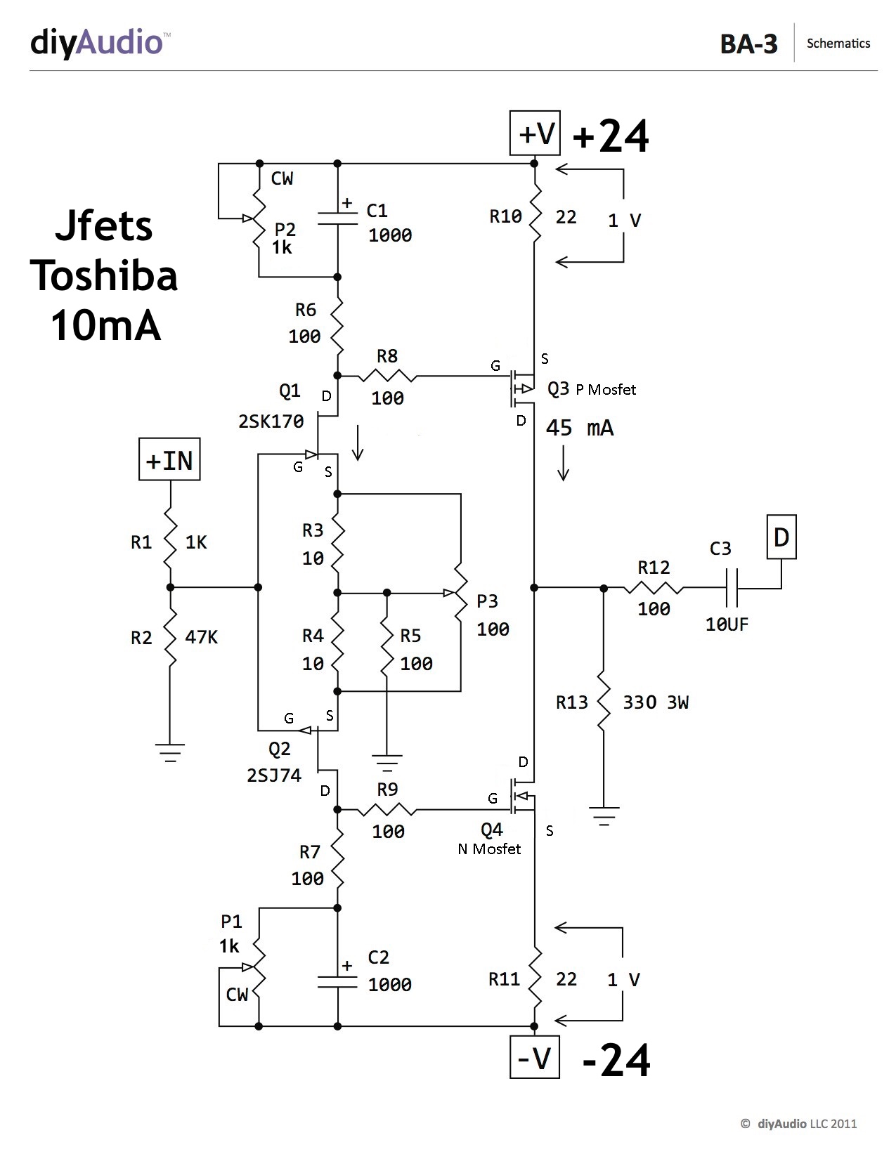

Now my BA3 is up to 1V bias. Output 2V from 1V sine wave. I use original schematic except for P1 and P2, they are 1k. Shouldn’t output be 3V? Without tinkering with P3 I have THD% 0,4. It sounds detailed and controlled but there is some something missing. I can only describe it as ”it’s not B1K”. Do I miss some 2H? Du anyone have suggestions how to tweak BA3 to a friendly tone?
How much 2H is reasonable? The big >3H, are the only in my not so sophisticated oscilloscope?

show me schm your'e using and write what differences in parts are exactly

increase gain simply increasing value of final I/V resistor
you can't change THD Spectra without trying with P3 , and you must do that , to find setting you prefer sonically
if B1 is positive reference to you, you need to find setting with 2nd harmonic dominant and lesser THD overall
