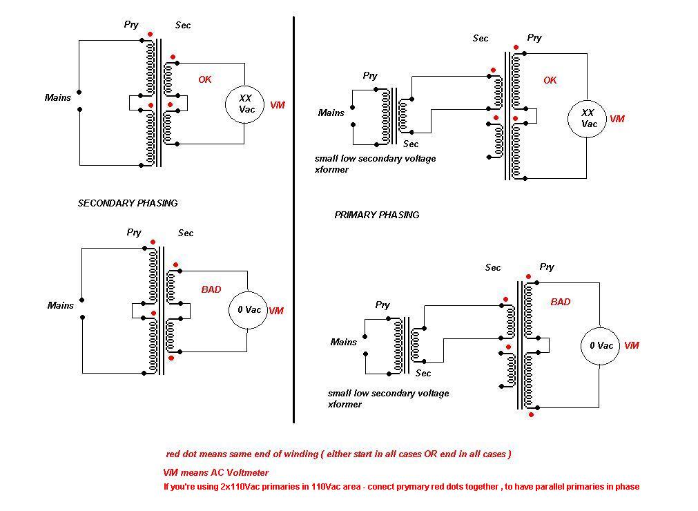

I believe everything should be clear if you read datasheet of xformer
having separate secondaries and connecting them to have CT is much easier that the other way around
here's some help
ignore miss-type here and there
if you have datasheet, post it here

duh
no color info there
what wire colors you have , one secondary, second secondary?
usually, start of winding is one color, end of winding other color
say that you have green and yellow
green 1 : first secondary out (to diode bridge)
yellow 1 + green 2 : Center Tap (GND)
yellow 2 : second secondary out (to diode bridge)
checking is easy , by sketch I uploaded ; connect two wires from different secondaries, put Vac meter across free ends,power up Donut ( taking all safety measures - isolated mains contacts etc.), measure ; if you have double Vac , that's the arrangement ; if you have nearly 0Vac , change place of wires of one secondary, retest
