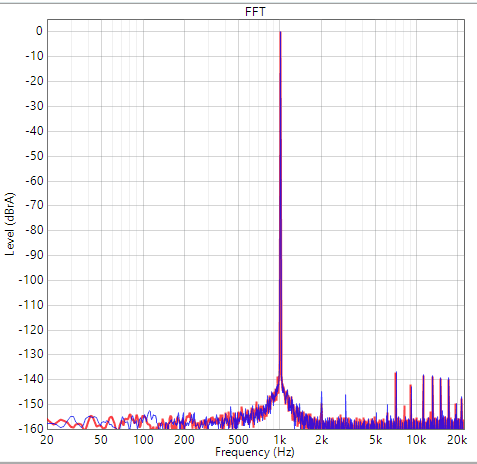

In post 277 Hierfi compared SMSL DO100 and SMSL SU-9n which both have very low distortion and SINAD at 121dB according to ASR measurements. However looking at the FFT of SMSL SU-9n I can easily believe that it may sound different to some other DACs with similar performance numbers. Noise skirts are wide and high and higher order harmonics may even be audible. IMO distortion and SINAD numbers do not tell anything by themselves.However, two DACs that measure stellar and are very close, according to ASR, to my average ears sound very different without any doubt. One has distinctively clearer and stronger treble, more detailed soundstage and more details in the sound reproduction. Jet, they have distortion that differs by 0.00002% and SINAD is 121 for both. All FFT artifacts are more than 130 dB below signal for both.
How is any of that going to be audible? It's buried completely within the noise. The only reason you can see them there is because of the FFT process used to extract them from the noise itself. They are all almost 140dB below the fundamental, this is ~20dB below the noise floor of the DAC.
Do you really believe in audibility of something that is all below -130dBr?? Have you tried to calculate such differences into SPL? What would be the mechanism of hearing such thing? Have you done any DBT to support your claims? Because usupported opinion does not count.
