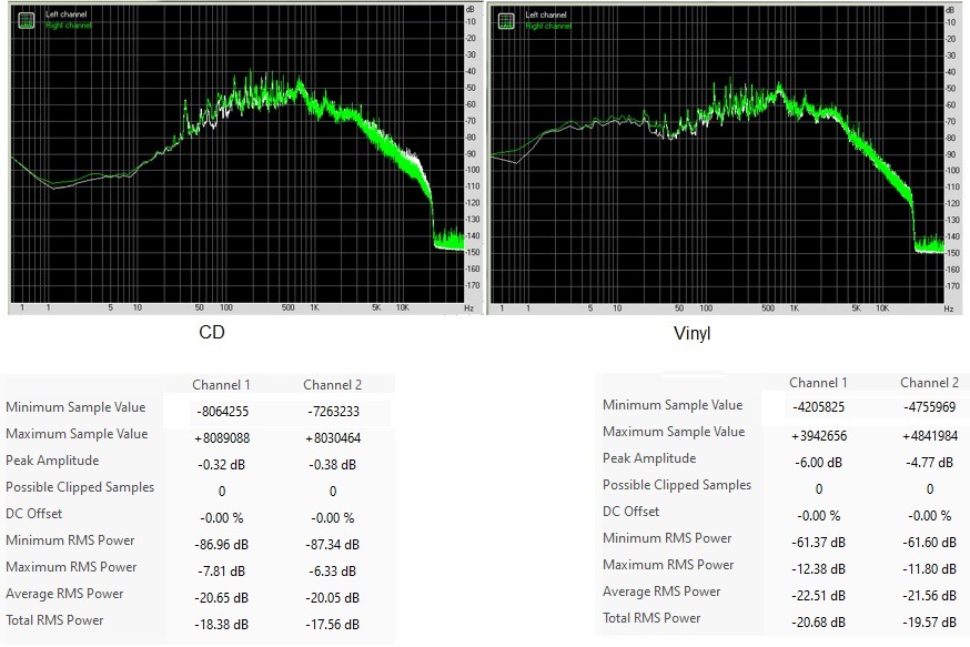

A lot of noise, a lot of distortion with vinyl. But despite of that (or is it due to that?) it sounds OK
So much so that I have the suspicion that digging for lower and lower levels of noise and distortion with DACs is like digging in the wrong place.
I have a few vinyls and their official transfer to CD and some with a later remastering. They are enough in number to allow me forming an opinion that there is nothing wrong with the digitalization but there can be a lot to blame the one who has done it.

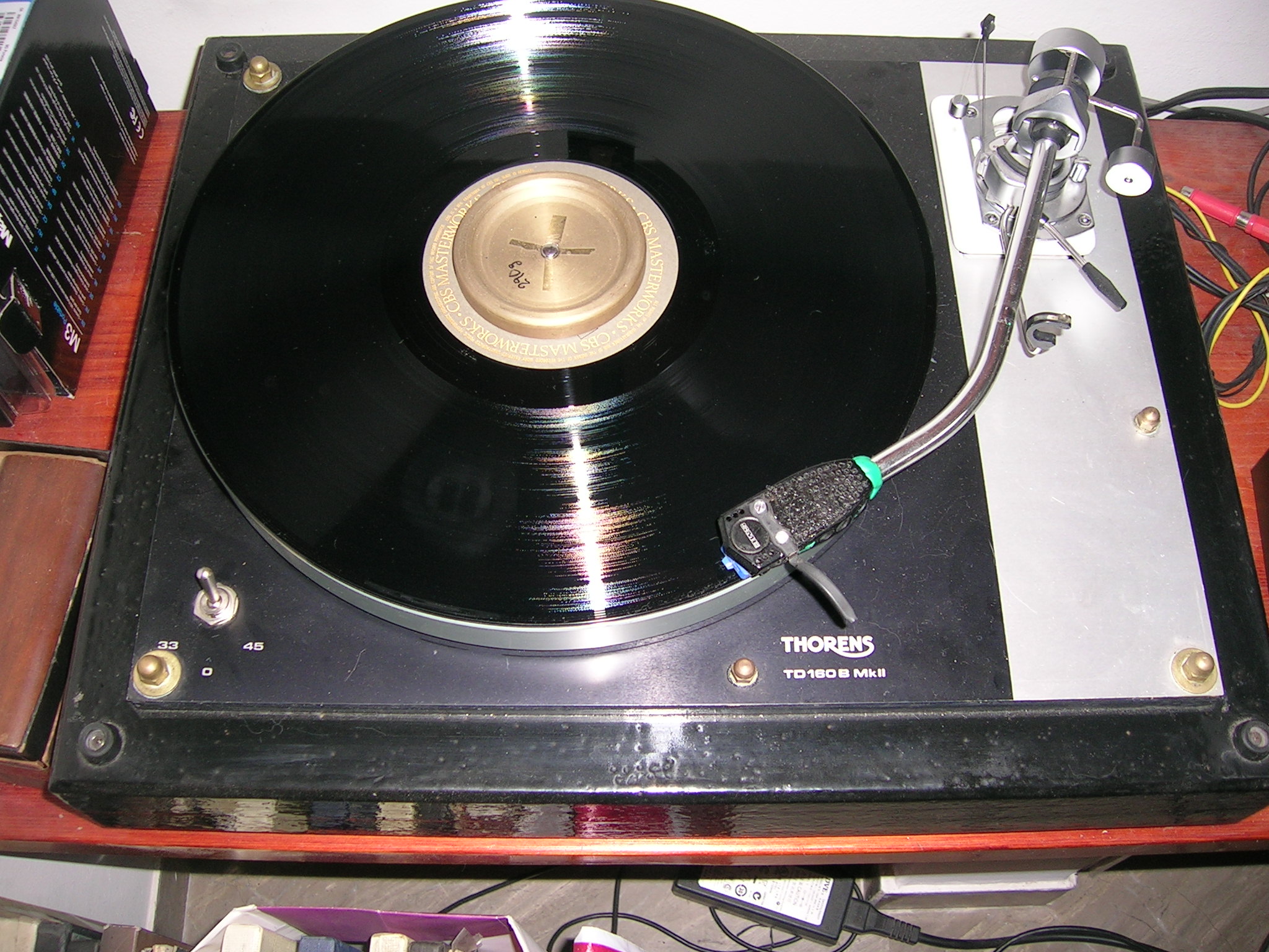

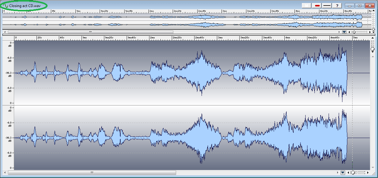

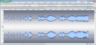

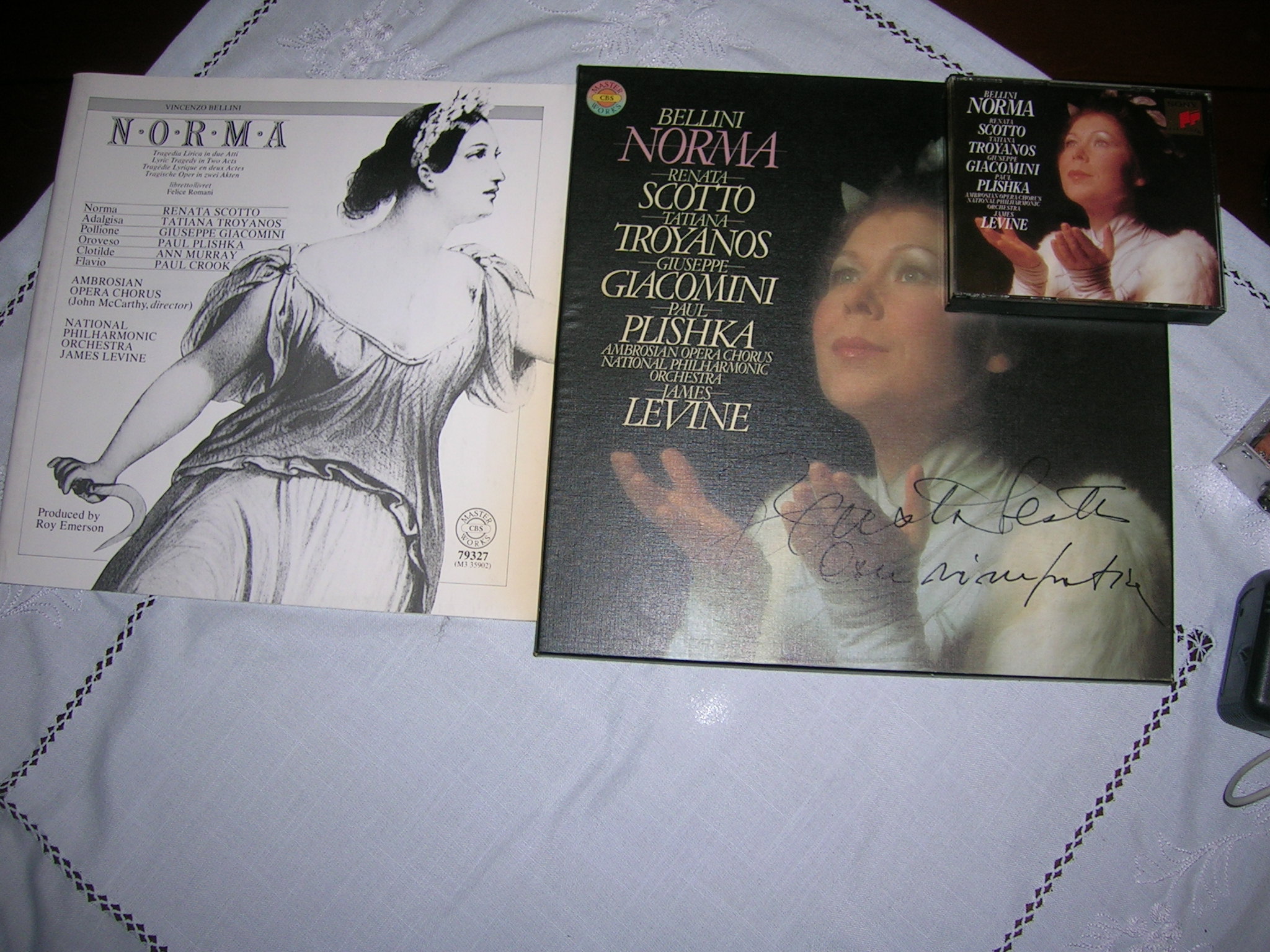

Yesterday I found a file in my hard drive with a vinyl rip I had made for comparison to the remastered CD. Shure M97xE cartridge, Hagerman Bugle RIAA preamp with batteries.
Norma closing act CD
https://www.dropbox.com/s/huje2pjbebjohmb/Closing act CD.wav?dl=0
Norma closing act Vinyl
https://www.dropbox.com/s/r0q44xvrf6vjjxe/Closing act Vinyl.wav?dl=0
Apart from the weaker ending (compared to the remastered CD), do you find the vinyl sounding worse than the CD in the rest of the music extract?

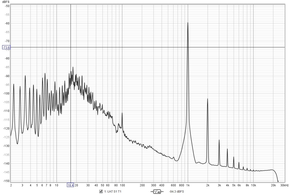

Last attachment is the FFT of 1kHz@5cm/sec from the TT system with which the vinyl rip was made (The Ultimate Test LP. S1, T1).

Do you really believe in audibility of something that is all below -130dBr?? Have you tried to calculate such differences into SPL? What would be the mechanism of hearing such thing?
There is only one pressure wave that impinges on the ear. The idea that spectral components can be linearly separated is based on an assumption of a linear detector. However, we know that if a detector has a certain nonlinearity, i.e. a detection threshold, that in some cases stochastic resonance (the addition of random noise to an input signal below the threshold) can boost the composite input (noise + signal) over the threshold such that the smaller signal can be detected.
Seems to me the burden of proof is on you to show that the ear/brain detector system is linear for complex time domain waveforms, not just for simple sinusoids taken in isolation.

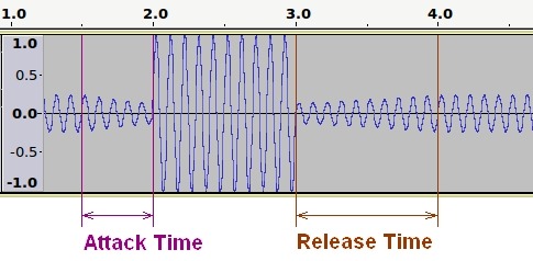

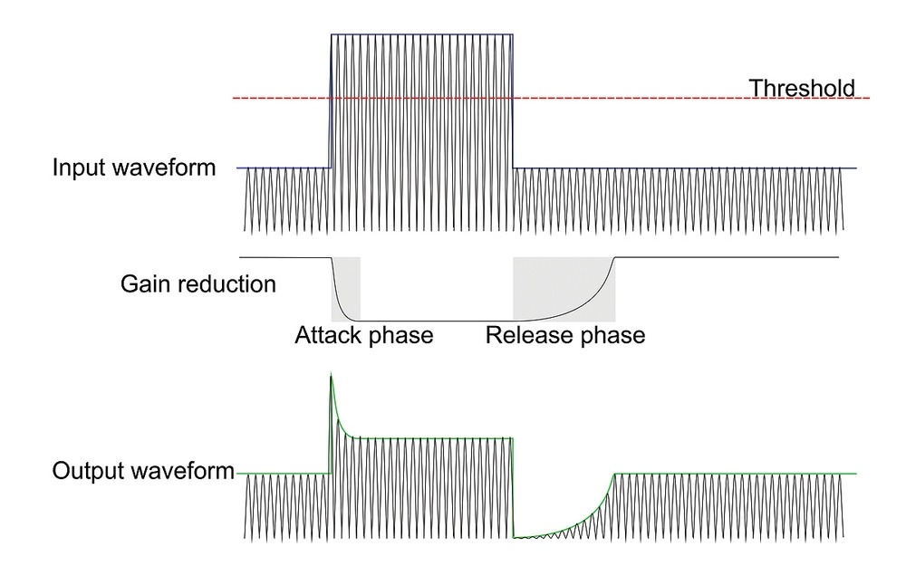

A bit more about distortion. Attached below are a couple of pics showing what a dynamics compressor does. They are pretty exaggerated examples to illustrate a point. The point is that if you feed a fixed sine wave test signal into one and measure the distortion, you will have no idea of what the thing actually does to sound. You will see something that looks like a time-invariant nonlinearity simply because you are measuring it in a time invariant way. You may wrongly conclude that a black box simply produces distortion, so people must like distortion. Wrong conclusion. It isn't that simple.
