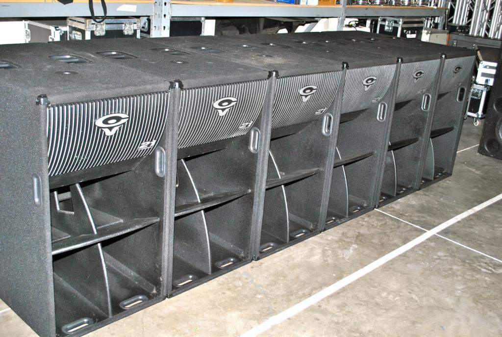

Minimize driver excursion (so horn loading and large membrane area are necessary). DSP, DSP, DSP. Take your time to find with placement in the room. And of course you will use subwoofers, so vocal will be handeled by something else.
Currently I am somewhat happy with 4 RCF LF15N401, push push slot loaded with closed back chambers in a room corner. Baffles touch the walls in a 30 degree angle. DSP to flatten response (measurement taken close up at the exit of the slot), low pass filter to prevent phono cartridge feedback.

Sub placement is crucial, space them around, and you will get peaks and troughs all over the room. Put them together or preferably use one big one. Also look at pro-audio drivers as well as hi-fi ones. This video is about the live environment, however it is valid in any room.
Everything (multisub, other-than-monopole-sources) has been, or will be said on this. I could add the double bass arraywith an F3 extension at least below 30 Hz in anechoic.
Furthermore, it really is pretty easy to acquire sub-30Hz anechoic (...) in 150 litres, the big question is: which SPL? I have simple 8" 40 litre ported systems that do 28Hz at 98dB/1m anechoic, nothing special. It's really a matter of one or more drivers with enough Vd, combined with a large enough enclosure, a decent amp and an active crossover/equalizer. All of these, bar the driver maybe, are ridiculously cheap these days.
I think a "small room" (all normal domestic rooms fall in this category) is completely different acoustic environment compared to a live venue.Sub placement is crucial, space them around, and you will get peaks and troughs all over the room. Put them together or preferably use one big one. Also look at pro-audio drivers as well as hi-fi ones. This video is about the live environment, however it is valid in any room.
It's of course the same physical rules in play, but small rooms will have a distinct and profound number of modes, which will give deep nulls and high peaks. The trick with multiple subs is to hit as many of the modes as possible to get an even low end freq response. Very large rooms have many more modes and will therefore be more naturally even ... few own rooms which are that big
Large concert venues have other concerns like large reflecting surfaces, many ms away from the speakers which will cause ecco even in the low end, making up for a muddy low end.
