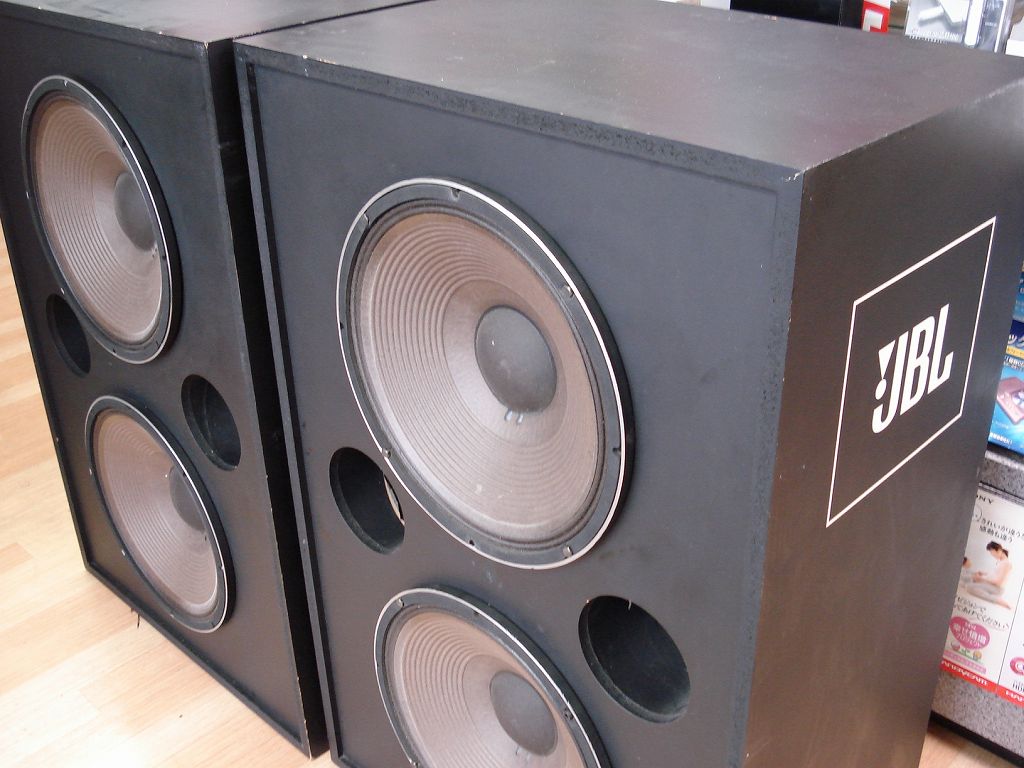

best bass / impact / slam I ever had was double 15" 2-way crossed at 750hz....
And I once ran a quad amp 4x18, 4x15, mid horn, piezo, crossing at 80hz, 750hz, and 5khz.
I prefered the big double 15 setup hands down.
Something about a big 2-way.
The real problem people have is forcing 15's to go higher than 800hz and / or not having a horn large enough to go down to (directivity) to 800hz either.
I preferred versus crossing at 80hz to subs.
My theory is bass/midrange is not going through a time/phase wrap of a 80-150hz crossover.
Ran basically that setup for years.
Still chasing that slam..................
Its F3 anechoic was just above 30hz.
dual Eminence magnum 15lf's in a jbl 4508a cabinet, plugged 1 port for 27hz tuning instead of 40hz.
2384 horn with a 2435hpl.
That thing pounded you.

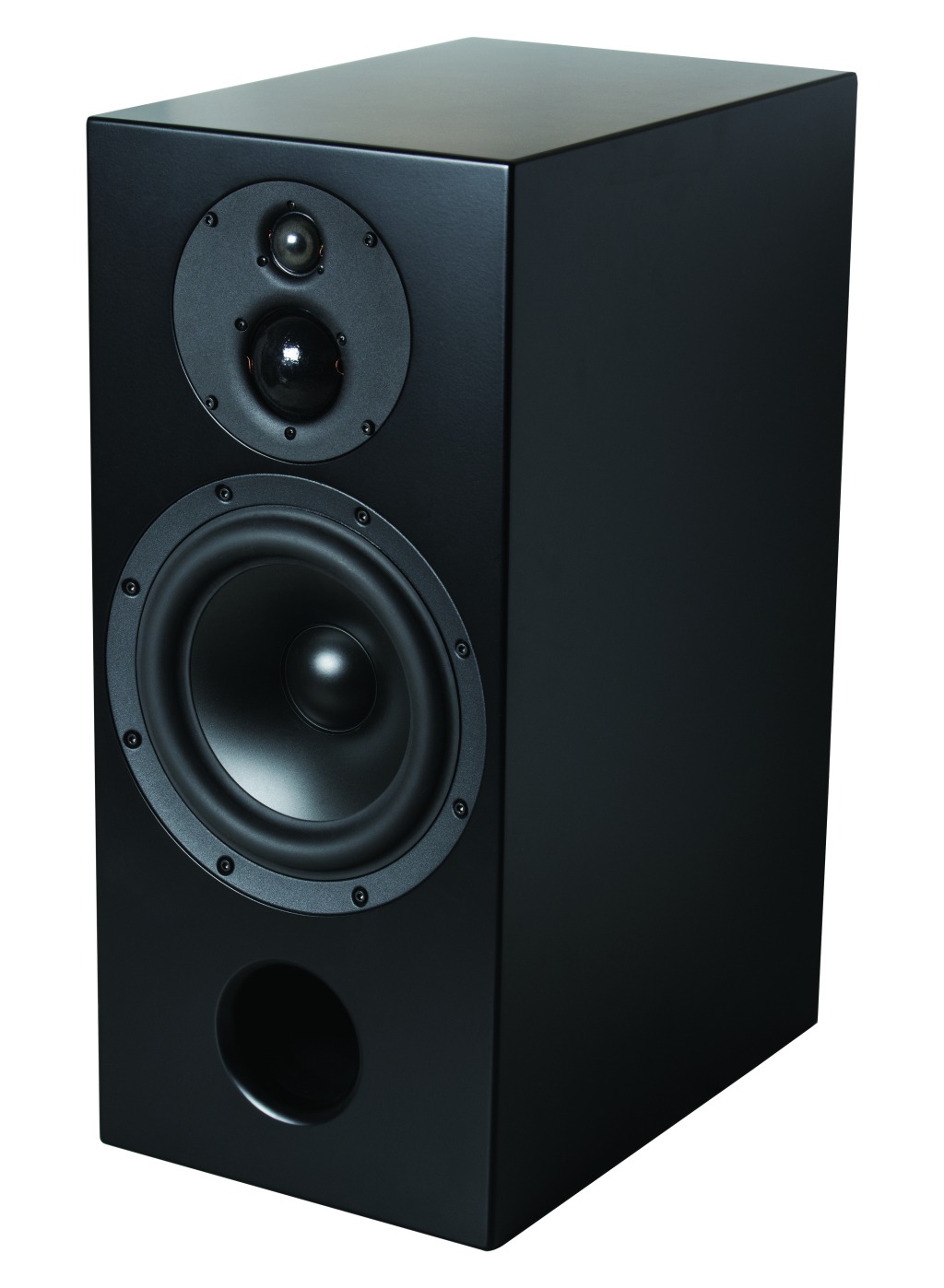

The best value I am aware of in a loudspeaker that can really pump out the bass is Solen's Monitor 9, with a woofer that SBA calls 8-inch, but I measure its Outside Diameter as 9 inches. The Morel Midrange-Tweeter module is very sweet.It's true, of course, I really like the clear and limpid mids, the vocals in evidence and the penetrating brasses, as well as the airy and tinkling high notes, but what I really love and which I can't do without are the BASS, that true, only it makes me come like a maniac. Unfortunately I got tired of searching, I can no longer find speakers with full, powerful, authoritative, defined, deep and engaging, impactful, dynamic bass, with an F3 extension at least below 30 Hz in anechoic. So I'm asking for advice here: which is the best speaker you've ever known with a similar response in the low range, branded or DIY, even large, possibly no more than 150 litres, possibly not costing thousands and thousands of euros and that at least doesn't suck on the rest of the range, especially the vocals? Thank you for even the smallest contribution.
https://solen.ca/en/products/solen-monitor9-passive-3way-monitor
Solen claims "extension" to 25Hz, no -dB reference, and I doubt that is an anechoic measurement.
But, for about USD$2500 the pair--which is what other people charge for a BBC Shoebox, for a professionally built completed speaker, I know of nothing like it. I assume that it is also available from Solen in France, if you are in Europe. NB, at the moment I am working on a review of the active version, which is powered by the Hypex FA 223 module.
ciao,
john

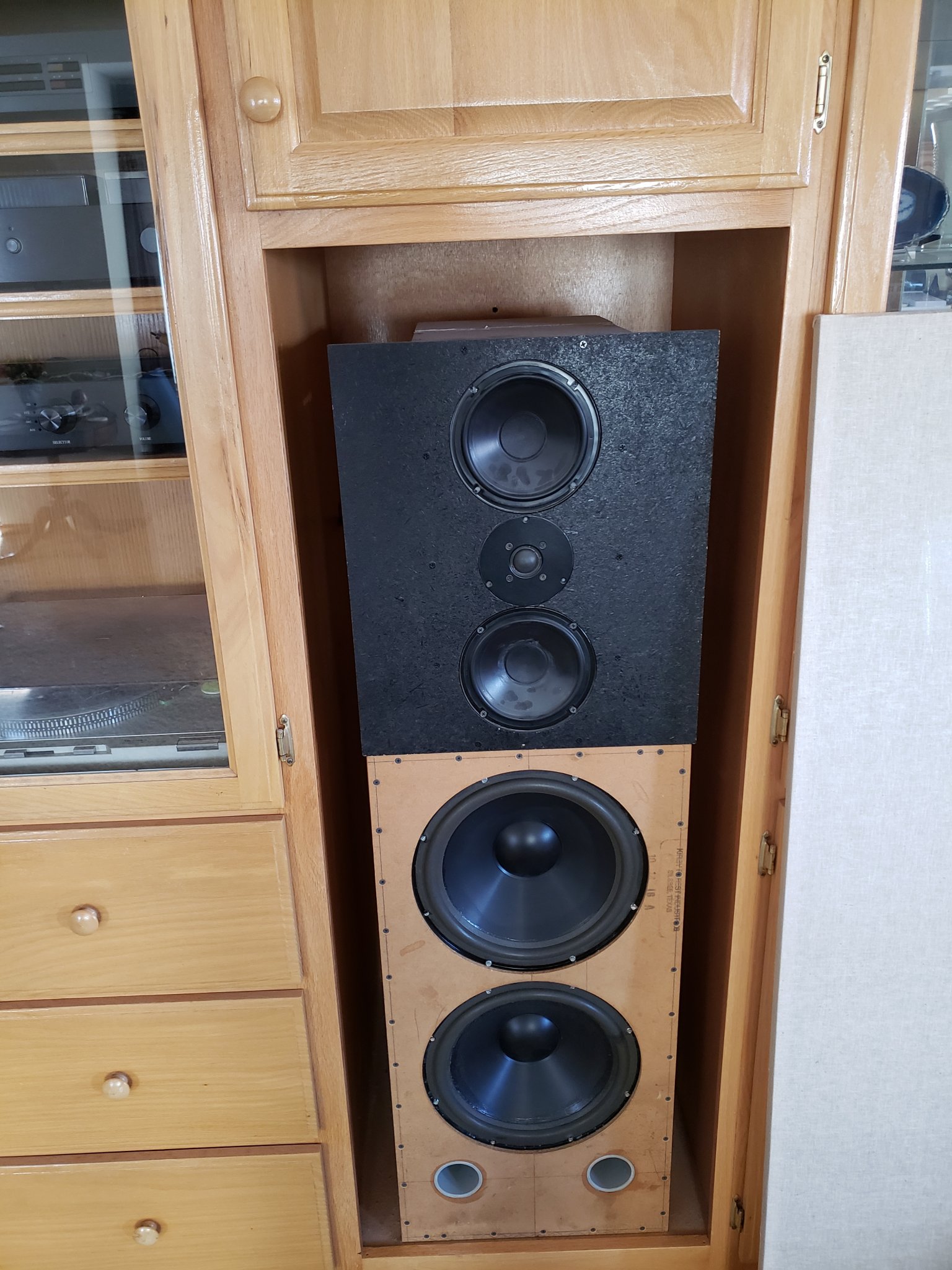

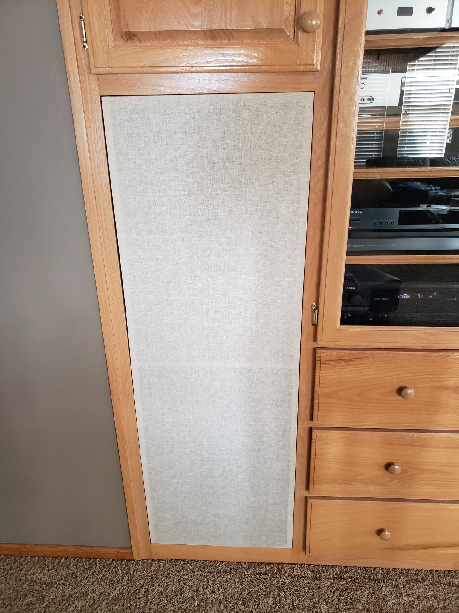

I placed my subs into the wall/cabinet to change the response to half hemisphere instead of quarter hemisphere. Someone with more knowledge may correct this information if I am wrong. I also changed the ceiling height in my living room to 9 ft. when we built our house to smooth out some nasty room nodes. 8 ft. ceilings are not very good in that respect.
![20221119_125444.jpg 20221119_125444.jpg](https://www.diyaudio.com/community/data/attachments/1019/1019270-87c52c23f91538935455c78bc075b8d5.jpg)
![20221119_125431.jpg 20221119_125431.jpg](https://www.diyaudio.com/community/data/attachments/1019/1019269-ced759151b268991da30817f5207f2cc.jpg)
