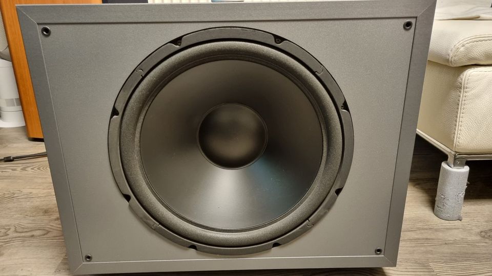

I have had similar issue's. My main speakers can not produce anything below 28Hz. I have searched for a long time for a sub-woofer that could complement them to the absolute bottom. With a small as possible enclosure, and preferably no bass reflex ports. I ended up with the D7 Sub from Jamo. It's a closed case that uses Motional FeedBack (ala Philips MFB) to control the speaker. The D7 Sub complements my speakers perfectly and it goes from 1Hz to the cutoff at 30Hz.It's true, of course, I really like the clear and limpid mids, the vocals in evidence and the penetrating brasses, as well as the airy and tinkling high notes, but what I really love and which I can't do without are the BASS, that true, only it makes me come like a maniac. Unfortunately I got tired of searching, I can no longer find speakers with full, powerful, authoritative, defined, deep and engaging, impactful, dynamic bass, with an F3 extension at least below 30 Hz in anechoic. So I'm asking for advice here: which is the best speaker you've ever known with a similar response in the low range, branded or DIY, even large, possibly no more than 150 litres, possibly not costing thousands and thousands of euros and that at least doesn't suck on the rest of the range, especially the vocals? Thank you for even the smallest contribution.
I am not sure if you can still buy them as they have become a little bit old now, but you should at least listen to one if you find any
(It ain't pretty, but looks where not a requirement for me)
