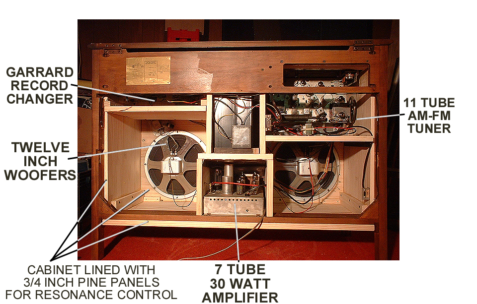

Back in 2009 when I rebuilt and redesigned my 1963 RCA Victor stereo console, I literally tore it down to the outer shell.
Being in pristine shape otherwise (an old lady once owned it, honestly) the side walls were 1/4 inch plywood, laminated with walnut, and it had an open bottom.
Now that construction naturally resonated with a bass boom, not my opinion of High Fidelity.
But that's what sold consoles like that - people were impressed by all that boom from a flexing cabinet.
No, not me.
So once I tore out the guts, I proceded to line the whole inner walls with 3/4 inch furniture grade pine - making the sides 1 inch thick.
The front, along with the interior and bottom, was done in the same pine - braced, interlocked, glued and screwed.
I chose an asymmetrical design for the speaker chambers, one slightly larger than the other.
Why, you ask?
To reduce the chances of both woofers peaking at the same frequency, which would happen if they were in identical chambers.
That results in "one note bass" issues - again, not "hifi".
I wanted to hear what the speakers were offering, not the cabinet.

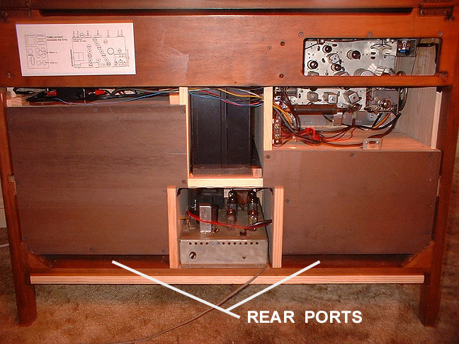

The interior sections were also part of eliminating resonance - the tube amplifier in its own chamber was shielded from woofer vibrations, as is the tuner/preamp, and the amp chamber was designed with enhanced convention cooling, drawing cool air from the cabinet bottom through a screen, and hot air flowing out the back. (no noisy fan needed)

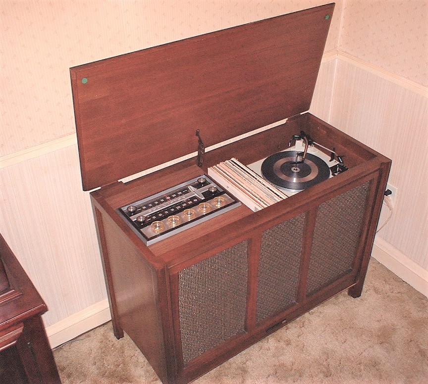

Also, the record storage area directly above it is isolated and insulated from heat to eliminate warped records - and it works perfectly, the floor of the storage area stays room temperature after hours of use.
Even the Garrard record changer is in its own sealed section to limit/prevent feedback issues at high volume.
After all this, and the added weight of the components, this thing weighs about 200 pounds I suppose - a two-man job to carry.
In the photo, please note that those speakers were only temporary, being the original RCA speakers - the current 12 inch woofers, midrange, and tweeters are modern replacements, hand-picked for the best response from this console, along with polyfill and fiberglass stuffing, and added rear ports.
My picky audiophile friends are impressed by the resulting sound quality, as am I.
Introducing the RCA Victor Custom Concertmaster Deluxe.......

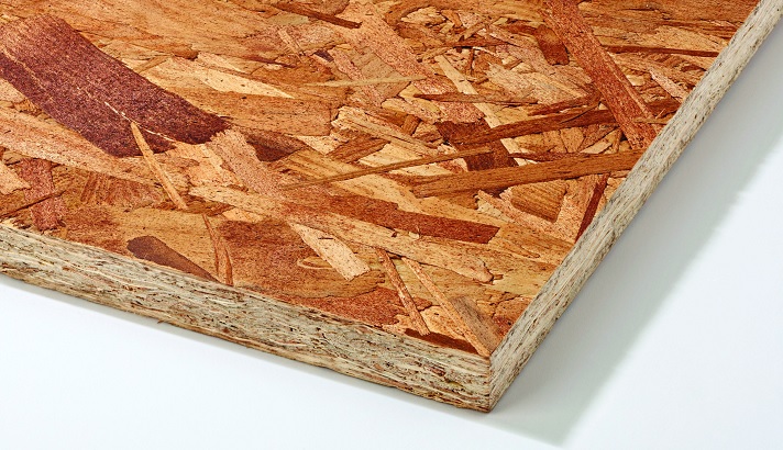

Dr Earl Geddes material choice (Remschape something) is hardly difficult to source for enthusiast... with bambou ply for kitchen desks, I asked myself why not for the woofer a cheap composite like low density polyethylene, or wood osb panel which chaotic structure of glued plys certainly distribute the frequencies reasonance at several frequencies so intensities... not much beautifull that this last but can be covered with industrial dense wool (white or grey).
this front panel for the woofer should be the closest size to the driver to reduce its emiting surface. Of course there is also the choice of a thick rubber between the woofer and the baffle but one has to find ruber insert on the baffle for the screws to let the driver dance : I'm not sure due to the length of wave length of a woofer than micro shaking of its body is problematic... Anyhow there always be resonant frequencies somewhere due to the meeting of the resonance frequency of the cabinets walls outsides with the back wave of the cone at those frequencies ...
