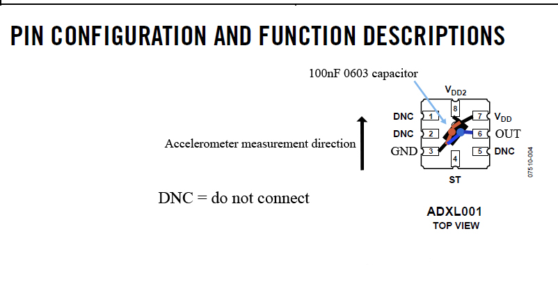

Hi All,
A good evening to you from Scandinavia - hope things are well where you may be
As it is I'm moving in the direction of finishing the accelerometer I bought & mentioned here earlier - and thus actually getting it ready for use (the ADXL001 from Analog Devices - weight 154 mg). To this end I wonder how I may best mount the wires going from the accelerometer so that they influence the measurements to the least degree.
The accelerometer itself is quite small - 5x5x2 mms - and has its pins oriented as shown in the attached illustration. The actual accelerometer measurement direction is indicated with an arrow in the image.
Given a reasonably stable PSU (will be a LiFePO4 battery) the local decoupling needed on the accelerometer itself is a 100 nF capacitor which I intend to be of 0603 size glued (with silicone probably - epoxy or something else better?) to the bottom of the accelerometer. This is the black angled rectangle.
The OUT+GND and the VDD/VDD2+GND (PSU) wires I then intend to be two sets of very thin twisted enamelled wire that are suspended e.g. in a couple of rubber bands e.g. 10 cms from the ADXL-001 and then connected to an ADC.
The two twisted pair wire sets are shown in the illustration as two circles - one blue, the other reddish-brown - going out perpendicularly from the bottom center of the ADXL-001 ... I hope this is reasonably clear ....
In my thinking about it this may be the connections that influence the free movement of the accelerometer to the least extent ... Any of you seeing it differently?
I've also attached an illustration of the rod I a.o.t. am going to measure. I would like to use the accelerometer to measure the rod's vibrations, however, another option is to use a small microphone placed closely to the rod. I already have one of the small Panasonic electret microphones (WM-68 I think) that I may use for this purpose - and actually am a bit pre-disposed towards it because using it would mean practically no influence on the rod's vibrations - something the accelerometer cannot quite achieve.
Might you have experiences with what works best in practice?
Thanks for any feedback

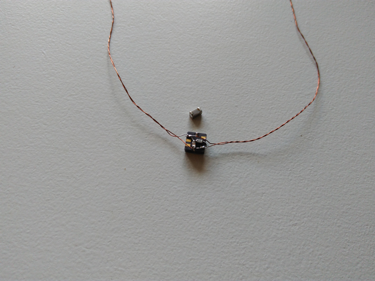

Moment of truth ...
Hi again,
Just a brief feedback on the ADI ADXL001 accelerometer that I've mentioned before ... I finally got around to assembling the accelerometer, i.e. mounting capacitors on its backside, and using it for my first measurements.
It's a bit tricky to measure the accelerometer's actual final weight due to the wires attached but it ended up weighing less than 0.2 grams - quite fine I think from the point of view of not influencing the measurements. Should you be interested I've attached a picture of the accelerometer with capacitors and wires (tiny The capacitor lying next to the accelerometer is a 1206 size).
However, the accelerometer is excessively noisy - so much that even with a quite restrictive band-pass filter I reckon that it will only be marginally useful for (any) measurements that does not involve major excursions and fast accelerations. I've had this high noise level confirmed on ADI's webpages so, well, "moment of truth" this time was not too useful.
Just would like to mention it should one of you consider such an accelerometer.
Jesper

Hi George,
I would say that it is white noise - the twisted pair cables appear to be quite effective in terms of 50 Hz attenuation. The ADXL001 in itself is quite noisy as discussed in this thread:

Could you tell us, what kind of noise you measure?
Is it noise from the 50 Hz power line or just white noise ?

If it is white noise, I don't think that there is something to do.
If it was 50 Hz, I have found that a very effective solution is to wrap a very thin aluminum foil (like the one used in cooking) around the accelerometer and connect this to the ground.
Of course in your case, first you should use something (like a thin plastic membrane) to isolate the active parts from the aluminum.
The added weight is not much and you can measure without the disturbances from the 50 Hz line.
Jesper
You might want to look into one of Measurement Specialties' AH-01 piezo accelerometers. Broadband, high output, has internal FET buffer (like an electret mic uses). Not too expensive.

Hi George & bwaslo - thanks for your replies & suggestions ...
@bwaslo: I've actually already looked at the ACH-01 but I will be measuring structures that are microphone/headphone sizes so I assessed that it - due to its weight - would influence the measurements. As it is I think I will go with a measurement microphone - I already have a couple of B&K 4133 capsules which should be usable for this.
