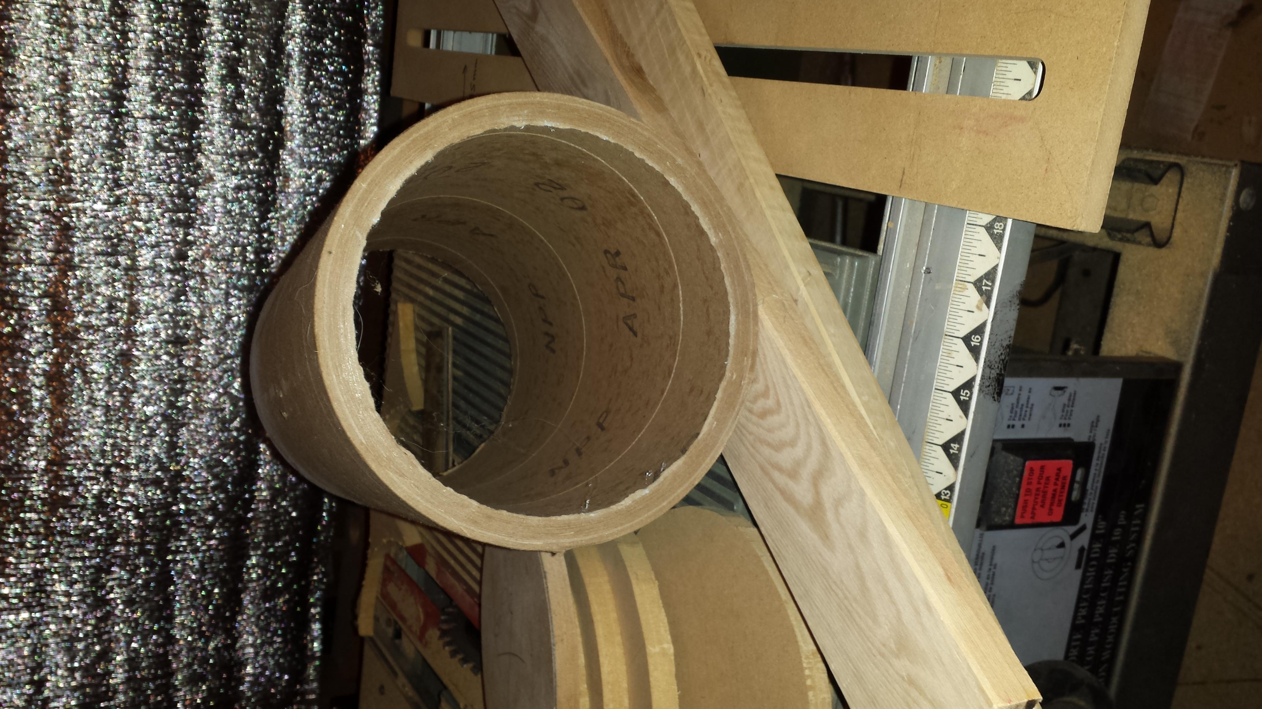

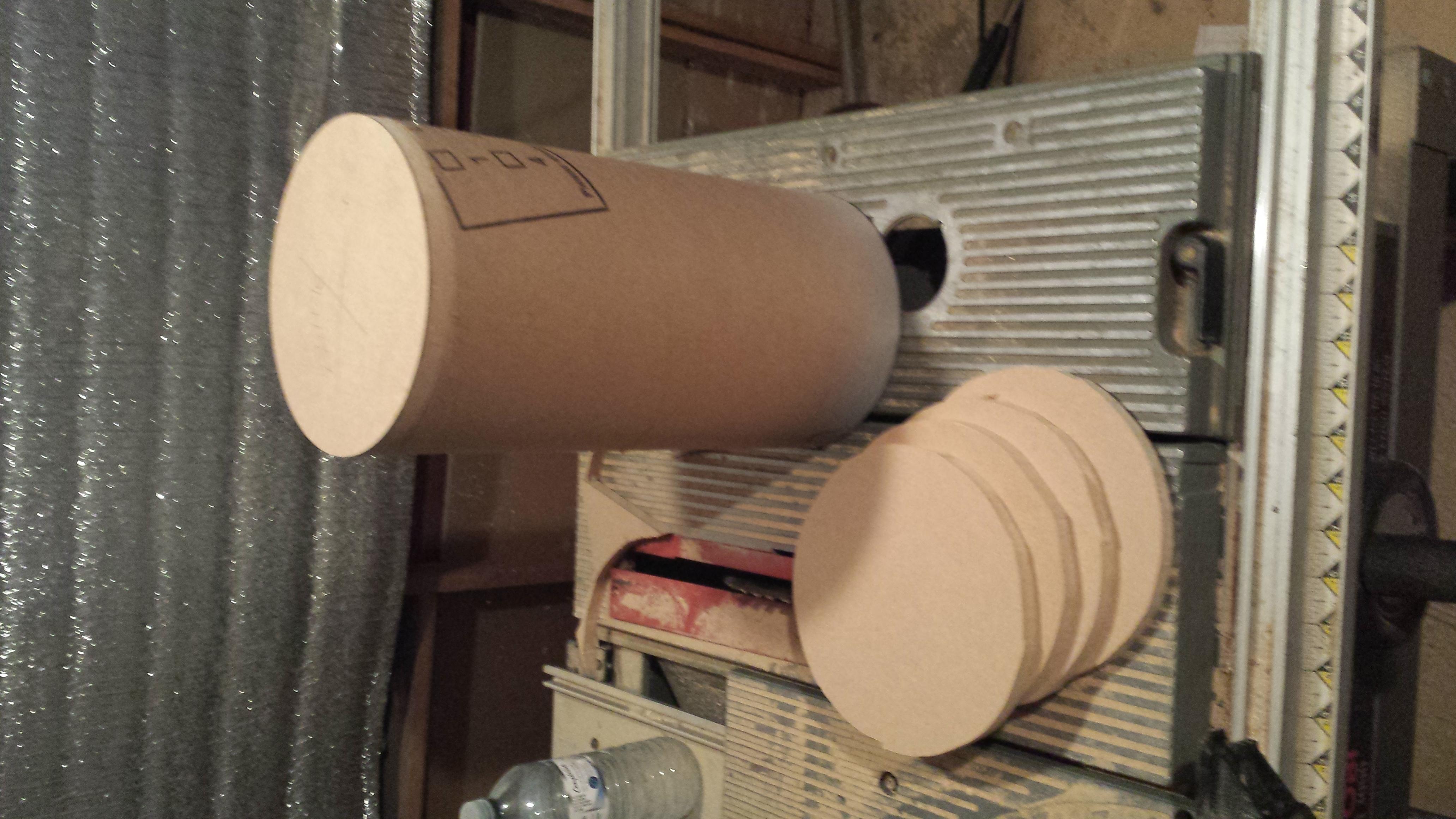

This dense paper roll doesn't ring like MDFs or plywood. It seems to have very good acoustic properties. Too bad it didn't come in sheets. But then if it did I'm not sure how I would go about cutting it. The standard method is on a lathe cutting machine with a circular razor wheel that gradually slices through as it turns at high speed. Ive tried the usual methods, saws aren't very effective. Its difficult to cut cleanly that way and it also starts to burn. Im in the process of making 5 inch subs, but its great for mid range cups too. I might try making a 2 or 3 way with it housing one driver per tube. The other available size is 3" inner diam. that could house the HF's.
No wonder I just said FI & used a truck for bonding psi to laminate Mdf.
