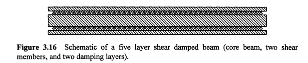

https://www.google.com/#q=integrated+approach+to+damping+marsh&spell=1
while about beam bending it looks like a mostly relevant read - later in the thesis "5-layer" CLD is mentioned
by using a isotropic thick core for the structure and then laminating damping and constraining layers to each surface the structural core "free" surfaces extend/compress and shear the damping layers which respective outer surfaces are constrained by the stiffer and thinner outer layers
with 2 equal isotropic structural layers relative shear would depend on edge conditions - if both are clamped then there is less shear between their inner surfaces - if only one is structural, the other a constraining layer then you are adding way more mass, lowering the resonant frequency and only have one shear layer worth of damping
it really looks like the 5-layer constraint-damping-structural-damping-constraint with thin but stiffer constraining layers on both surfaces of a thick structural plate/beam is a win

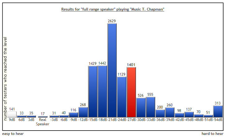

Very interesting to look at the results, it appears there is a huge difference in listeners ability to perceive different types of distortion evident in the test, although obvious that most listeners could tell when music was distorted.Has anyone taken this test to see where their perception of distortion audibility is?
Listening Test
Although I was able to hear distortion better than average in a few of the tests, tinnitus and noise induced hearing loss at 4kHz has reduced my ability to hear low level detail required to discern distortion.
It is interesting to see that many of the listeners are able to detect distortion as low as 45 dB below the music level, a huge difference from my average of detecting distortion at -10 dB, 32% distortion compared to 1/2%.
Makes me realize my old philosophy of "use well braced void free plywood" is not good enough for everybody who might be listening.

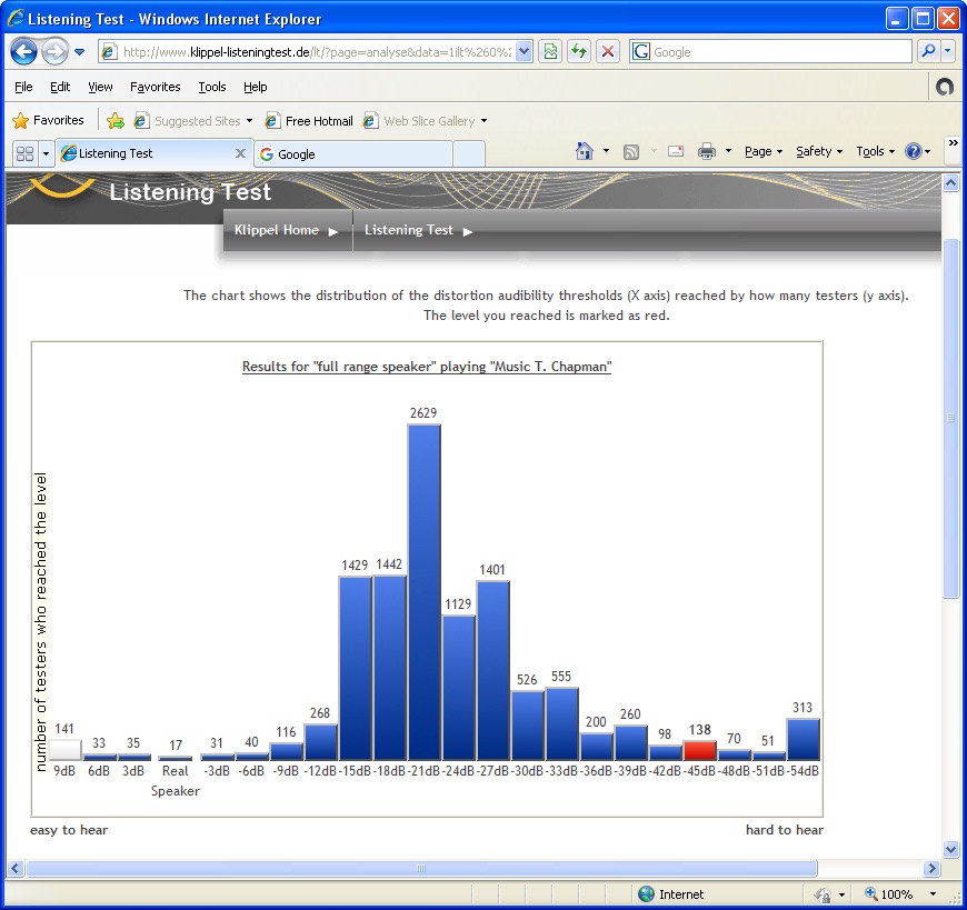

Thanks for taking the test. I did it with my MDRV6 headphones and a Behringer UCA202. Nothing fancy but I can detect distortion down to -45dB. It may be why I prefer low distortion systems and why the Trynergy sounds so special to me.

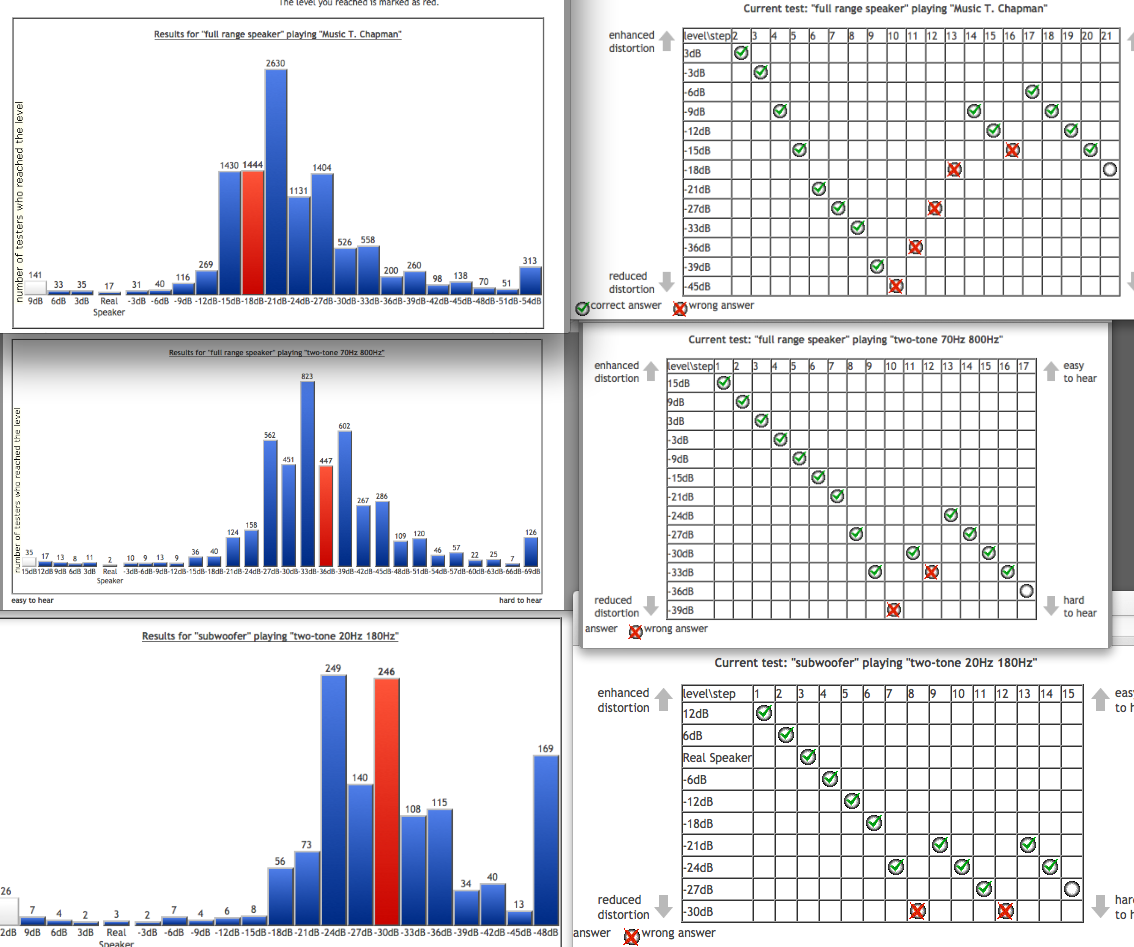

Participated Klippel Listening Test yesterday few hours before xrk971 did reveal his high sensitivity for distortion and nice score.
Site settings was "full range speaker" "Music T. Chapman" and hardware was Behringer HSP5000 headphones and UMC204HD USB sound device, picture 1.

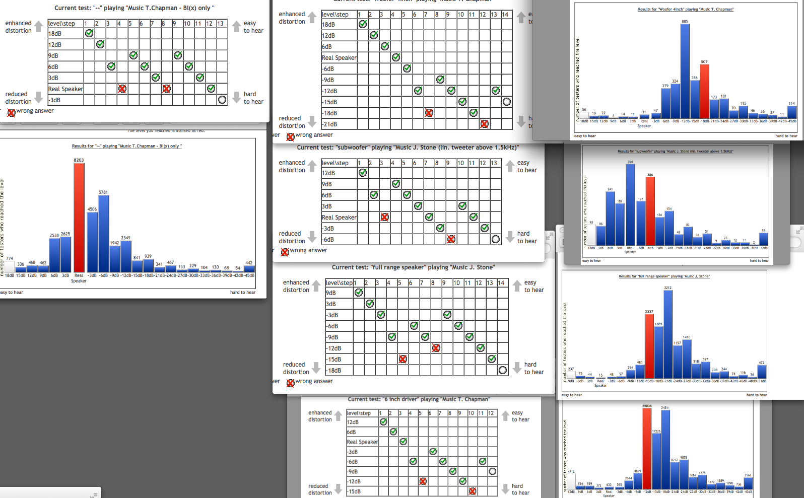

Today same settings and headphones but via a UCA222 USB sound device tried again, picture 2.
Nice improvement Byrtt. One thing that probably affects our ability besides the gear is our state of mental alertness. I did mine late at night when my mind is sharpest and the house is dead quiet. I hope more people try the test - but the results show that distortion is audible to some more than others even at levels below 1%. Although this topic is tangentially related to the best cabinet material - it may deserve its own thread to keep from going too OT here.

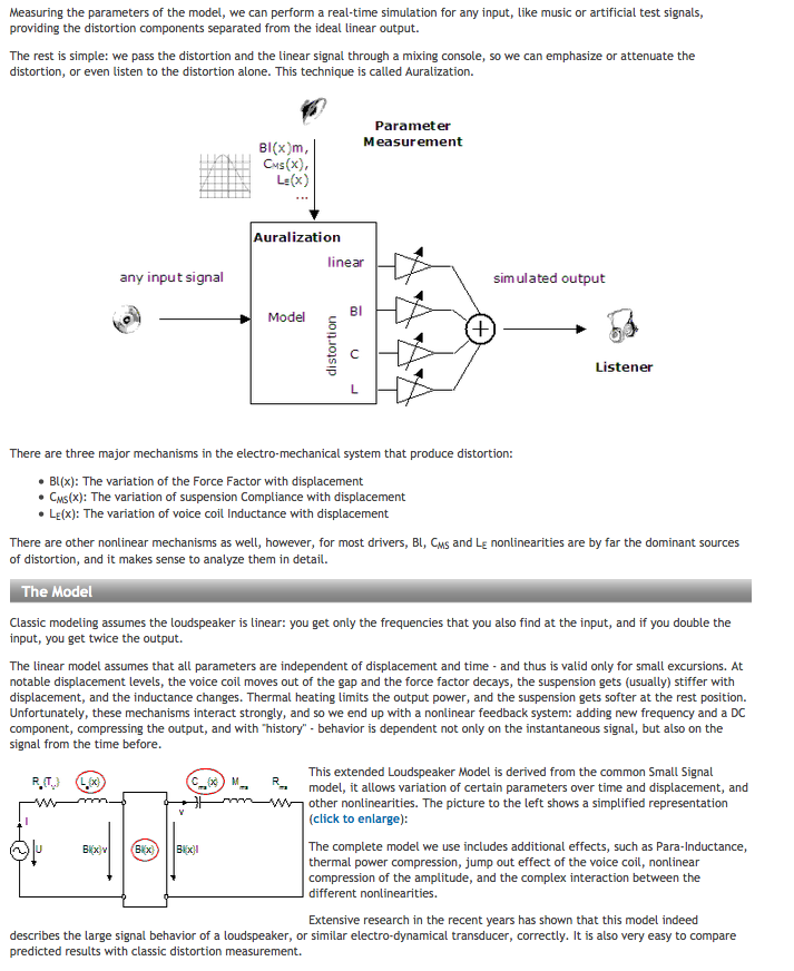

Klippel's test is contrived to show nonlinearity in its worst case (inductance nonlinearity). These results cannot be inferred to mean that the same level of distortion would be audible in another form. It must also be noted that if loudspeaker nonlinearity is not audible - and clearly it can be made so - then he is out of business. He has every reason to show nonlinearity as audible and it is in some badly designed drivers.

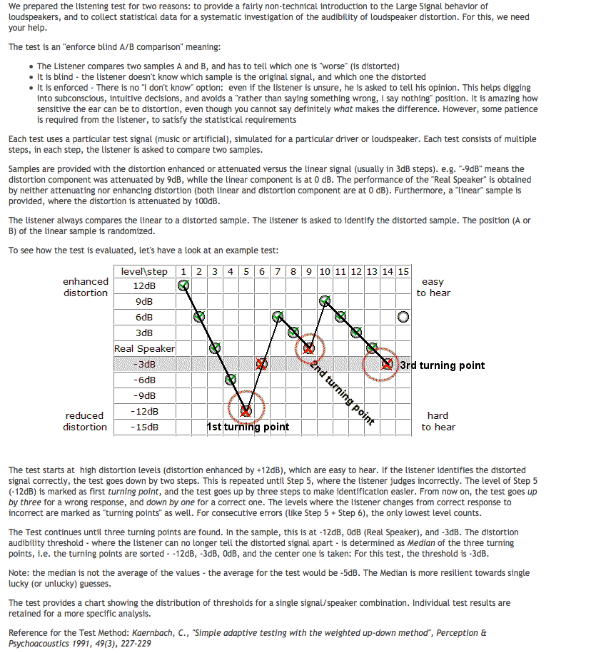

The Klippel Listening test does not show show nonlinearity only in its "worst case", it compares the multiple interactions at various levels allowing anyone to determine their own ability to hear those various distortions at a progressively diminished contribution to the signal.
The Klippel Listening test includes more than four nonlinearities in the electro-mechanical system that produce distortion:
Bl(x): The variation of the Force Factor with displacement
CMS(x): The variation of suspension Compliance with displacement
LE(x): The variation of voice coil Inductance with displacement
The model also includes additional effects, such as Para-Inductance, thermal power compression, jump out effect of the voice coil, nonlinear compression of the amplitude, and the complex interaction between the different nonlinearities.
