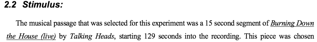

Having heard the Talking Heads live recording of "burning down the house" through speakers with low distortion,
Art
I believe we used the studio version and it has always sounded clean to me. And even though we did not do a comparison of modified versus non-modified in our protocol, I did such a comparison and had the difference been obvious I would have changed the protocol.

Earl,1)I believe we used the studio version and it has always sounded clean to me.
2)I should point out that your test is not blind and as such would fail even the most basic rules for psychological testing.
1) I just reported what you wrote in the report under "Stimulus", I couldn't know if you changed it from "Live" to the studio version, but both have plenty of distortion, though probably less than the level of distortion in the drivers the music was played through.

1) My mistake on the recording.
