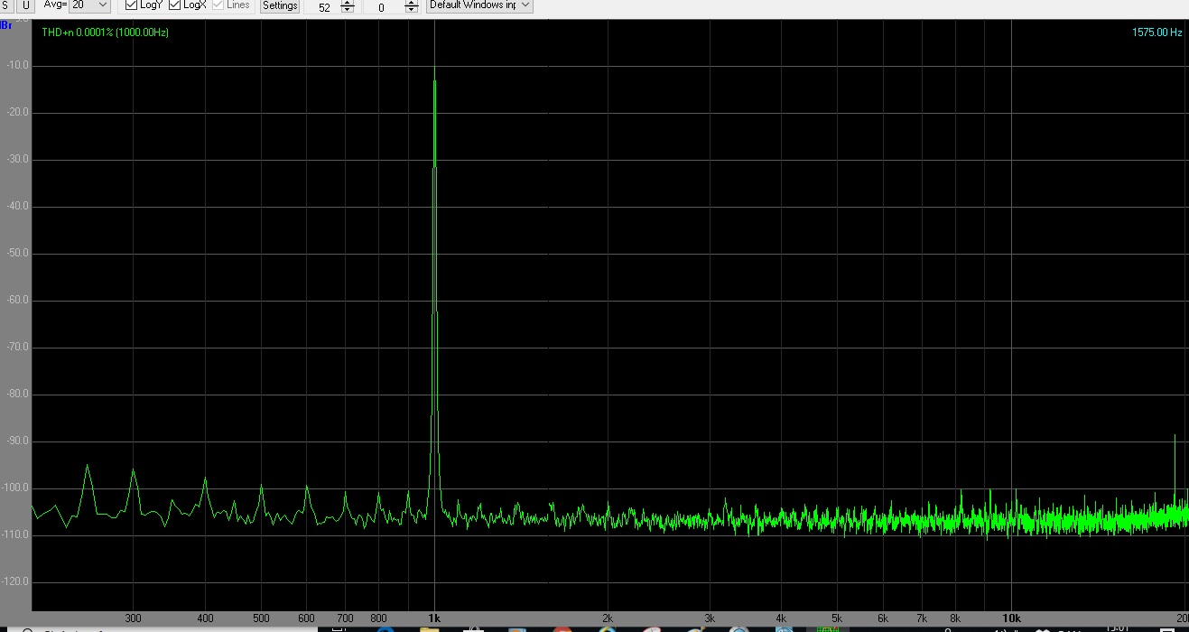

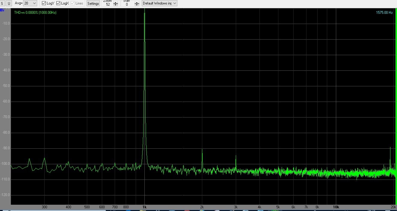

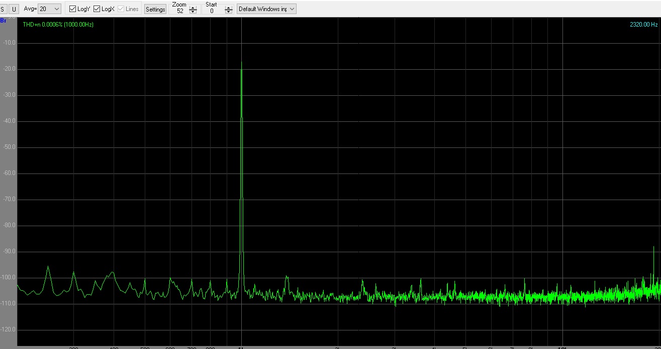

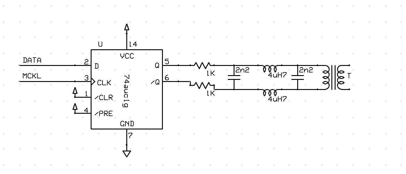

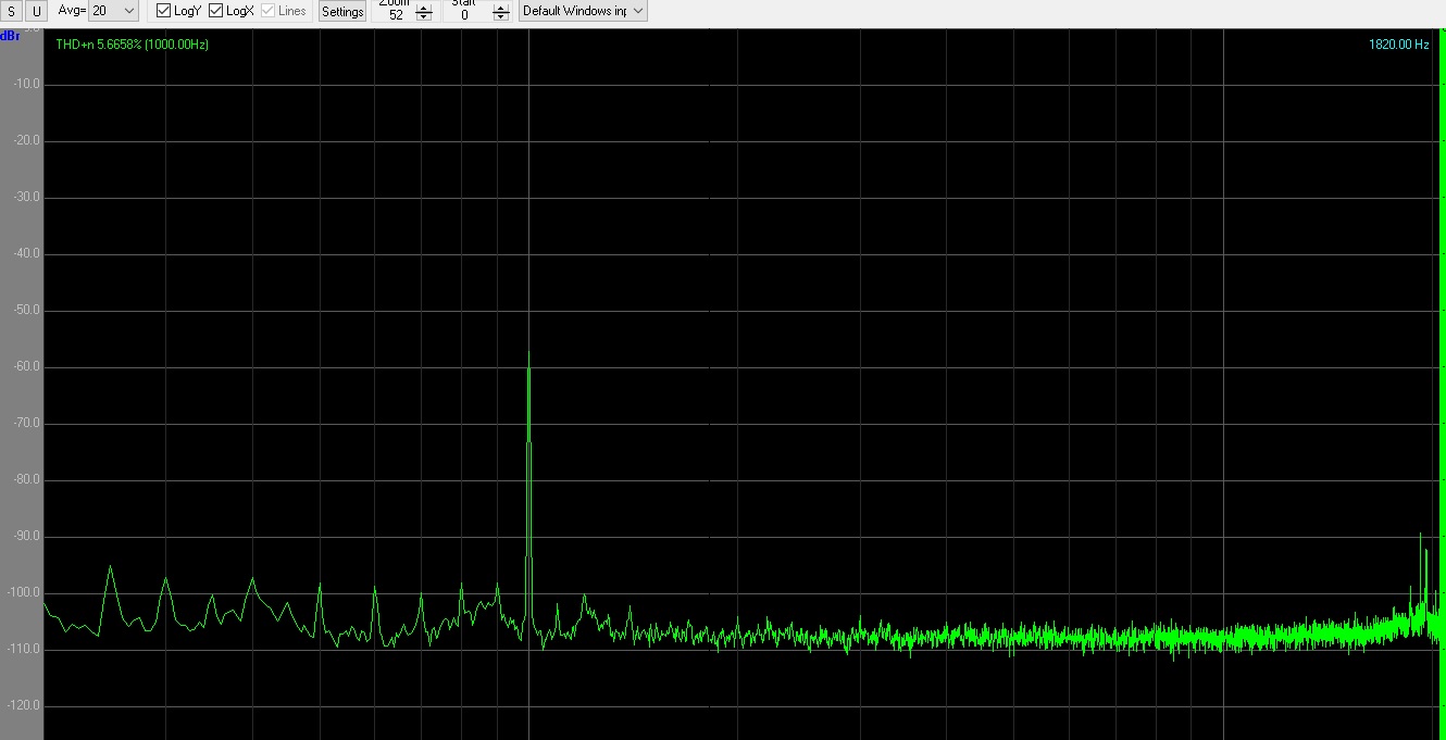

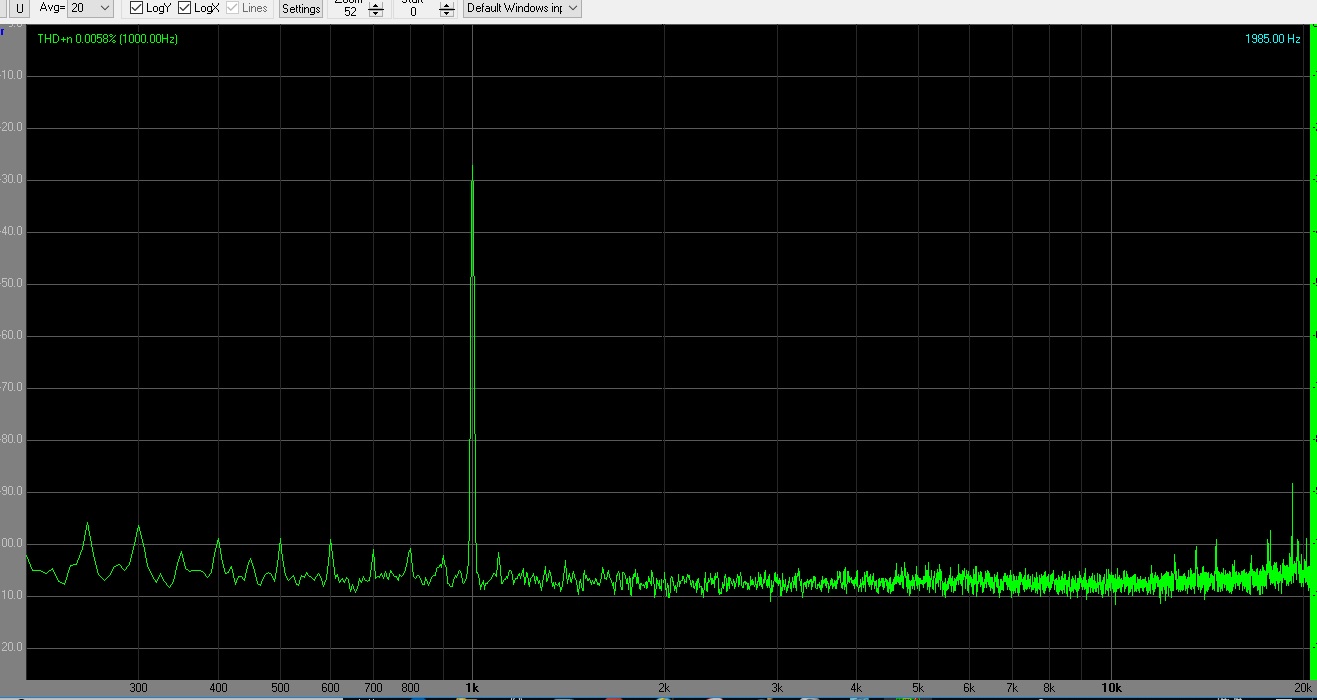

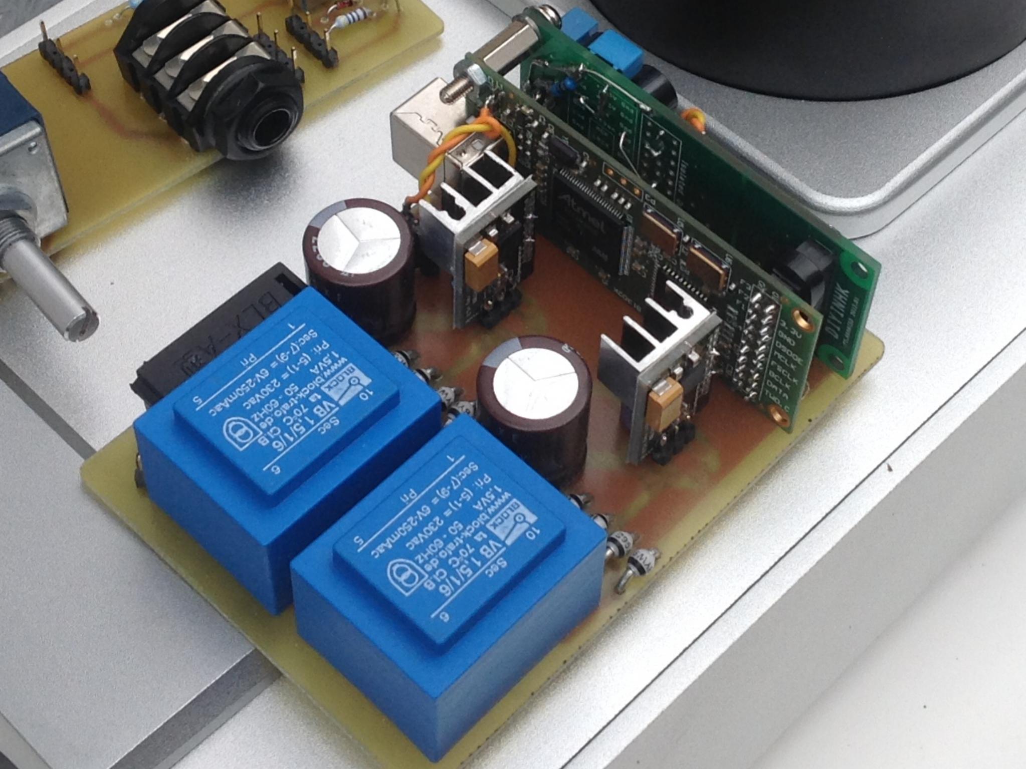

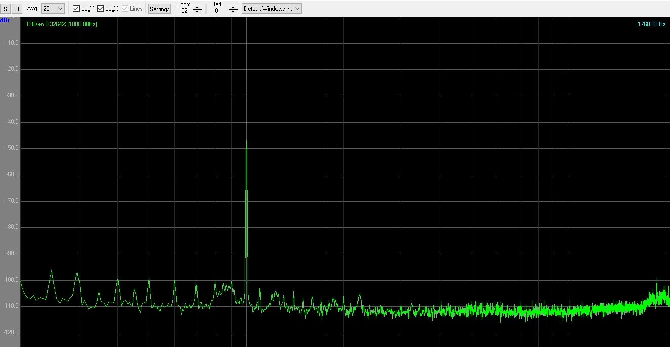

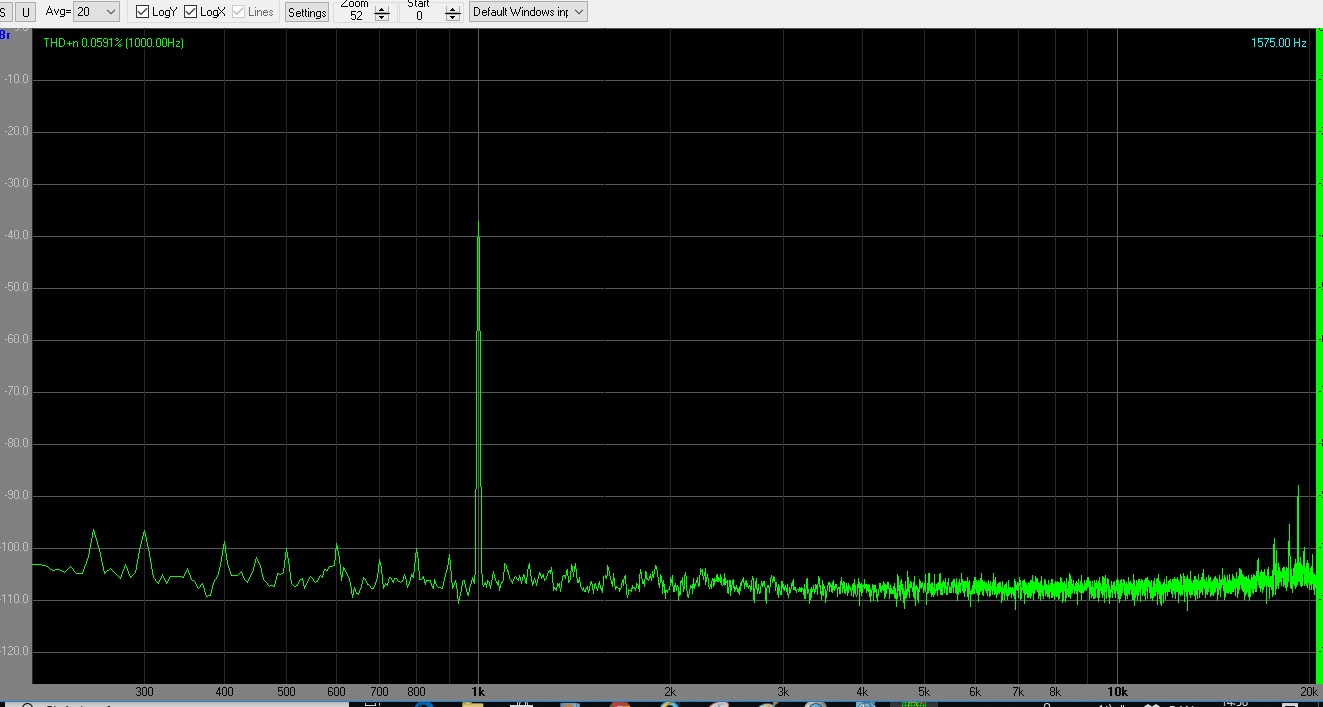

Hi Guys
Here is the best result so far from a simple NoDac.
Amanero with ISO7640 after into a 74AUCiG flip flop and balanced out to C-L-C filter and trafo . Trafo has a 10K resistor as load.
Power supply is one LiFePo4 cell (3,3V) so the output is not very high, and that is one of the reasons for the relatively high noise floor.
Have only made it in the lab, quick and dirty, but with equally long mini coax cables from ISO7640 to Flip Flop. No sign of distortion in the -50 -60 levels

Koldby,
Decent results for a simple solution :)
Your not returning to Zero, so I suspect the conversion error will take the form of white noise - maybe one of the reasons you have a high noise floor.
Whats your clock like? are you feeding your clock directly into the FF then the USB interface (so you Master clock is on the side of the FF?
Also the THD readings aer incorrect for the higher output levels, not sure whats going on there...
I am not sure I know what return to Zero means. The high noise floor is there even when the NoDac is turned off. My clock comes from the Amanero USB interface. The THD readings have never been reliable on this software FFT analyzer. The thing is, I have measured with the same equipment on quite a few NoDac solutions and they ave all shown high levels of harmonics @ -50 and -60 dB, but this in implementation the harmonics are all gone.
I have not been able to listen to it yet, so I don´t know if the noise is still at an annoyingly high level.

Can you upload the measurements?
As I see it, the pics I showed had, besides some hum and harmonics of that , noise more than 100dB down.
But I agree with you , that maybe I could get some better figures if I supplied the Amanero (and that side of the isolator) with a seperate battery. Of course the PS for the DAC (and that side of the isolator) and the Amanero should not have the same battery. The isolator would have no effect otherwise.
One more thing, you have a very nice and clean layout , whereas my setup is a dirty and quick setup just to see how the 74AUC1G would work with an isolator board and differential output. The way my measure setup works also leaves a lot to be desired.
The main reason for uploading the pics, was to show , that the -50 and -60 dB measurements were MUCH cleaner than any of the other NoDac I have tried before.
