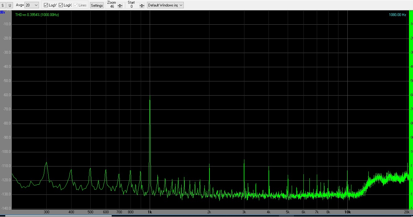

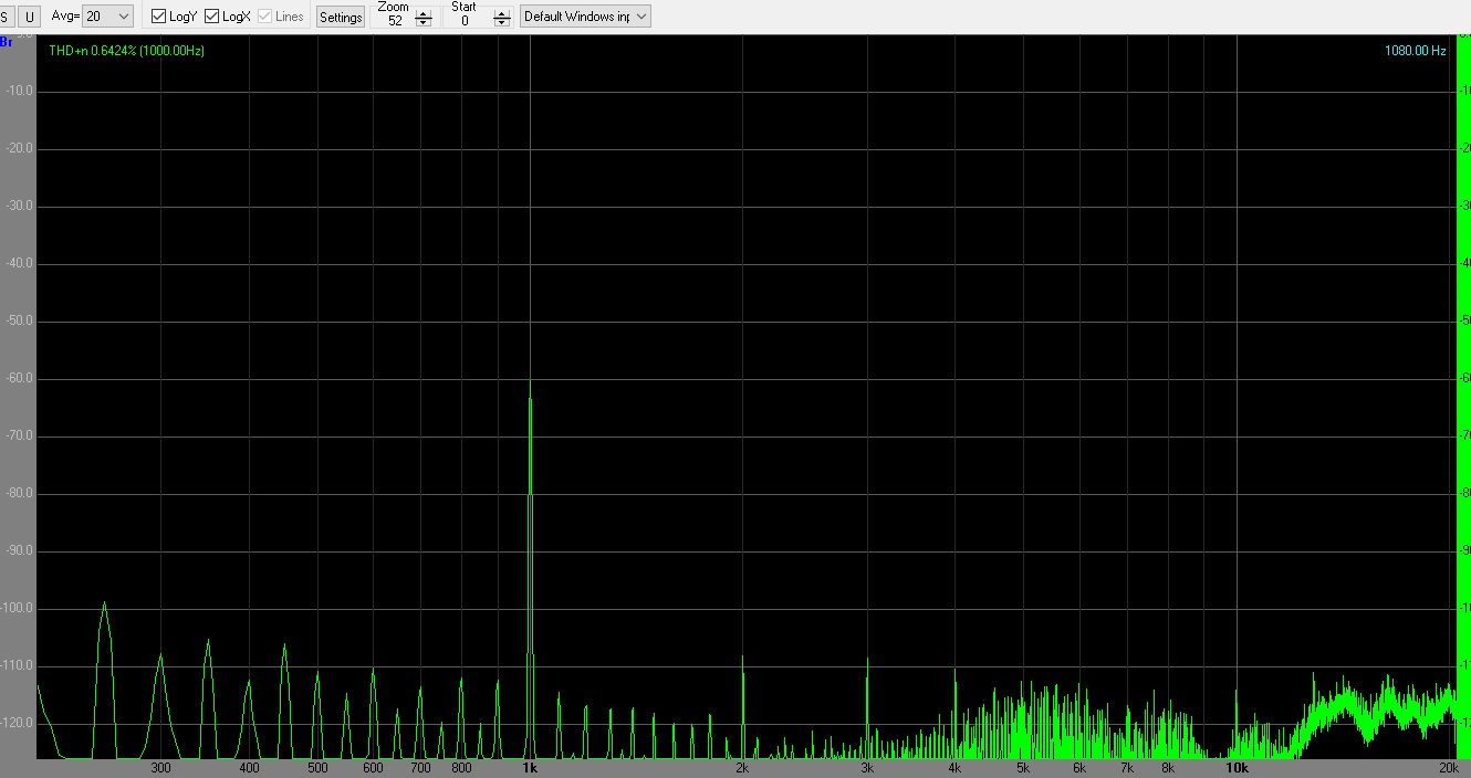

In order to be able to see more clearly the harmonics and noise and where the noise comes from, I made a x100 amp with a LME49710 and the -60 dB result can be seen in pic.1.
The harmonics are not buried in the noise here, but pretty low anyway IMHO
I thought the noise spectrum looked a little strange, so i looked for places where airborne noise could come from. Turned out that the inductors I was using was indeed picking up a lot of noise so I removed them and now there is only a simple R-C filter (1K- 2N2). The result in pic. 2.
NB!
The dB scale is different in pic.2. in order to see the noise floor.
Any comments?
NB!
Any comments?

Probably I am, but again, my main reason to show the graphs, was not to show noise performance, but the absent of harmonic components in the -40 to -60 dB , as this has been the biggest issue in my former measurements. The noise is for a large part from my poor measure setup.

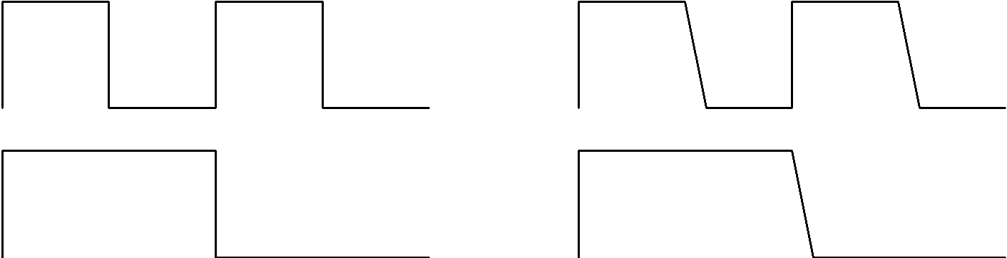

When rise and fall times are not exactly the same, RTZ ensures that each and every 1 has exactly the same weight, independent of the bit that comes before it. Hence, it eliminates a cause of intermodulation between the signal and itself that could convert out-of-band quantization noise into the audio band. The only problem it causes is an increase in the sensitivity to jitter, but you can solve that again by making a FIRDAC.
(The plot shows that with unequal rise and fall times, a 1010 sequence has a different average value than a 1100 sequence when the rise time is 0 while the fall time is not.)
Thanks.When rise and fall times are not exactly the same, RTZ ensures that each and every 1 has exactly the same weight, independent of the bit that comes before it. Hence, it eliminates a cause of intermodulation between the signal and itself that could convert out-of-band quantization noise into the audio band. The only problem it causes is an increase in the sensitivity to jitter, but you can solve that again by making a FIRDAC.

If you can come up with a method to get exactly equal rise and fall times without complicating the circuit, make sure you apply for a patent before telling anyone!
With return to zero, the 1100 pattern changes into 10100000 and the 1010 pattern into 10001000. In both cases you have precisely two rising and two falling edges, so the average values are the same, even when the rise time is different from the fall time.
I see, thanks for the explanation.If you can come up with a method to get exactly equal rise and fall times without complicating the circuit, make sure you apply for a patent before telling anyone!

Yes, the idea is to RTZ for EVERY clock cycle irrespective of the input Data. In the case of a simple NOR / NAND arrangement your "Gating" your DATA pulses via the clock so you have a 50% "On" Pulse (so the results is 50% "integrated" energy from your PSU rails).
There are many other methods to generate a RTZ scheme - so a 50% pulse energy reduction is not a given - the design I'm currently working on I've reduced the RTZ "Zero" state to 1/4 of the pulse "On" period as 'm aiming for an improved SNR.
With good clocking, PSU and design I've seen 130dB+ DNR Atwd (DSD256) even with a 50% RTZ "blanking period"...
