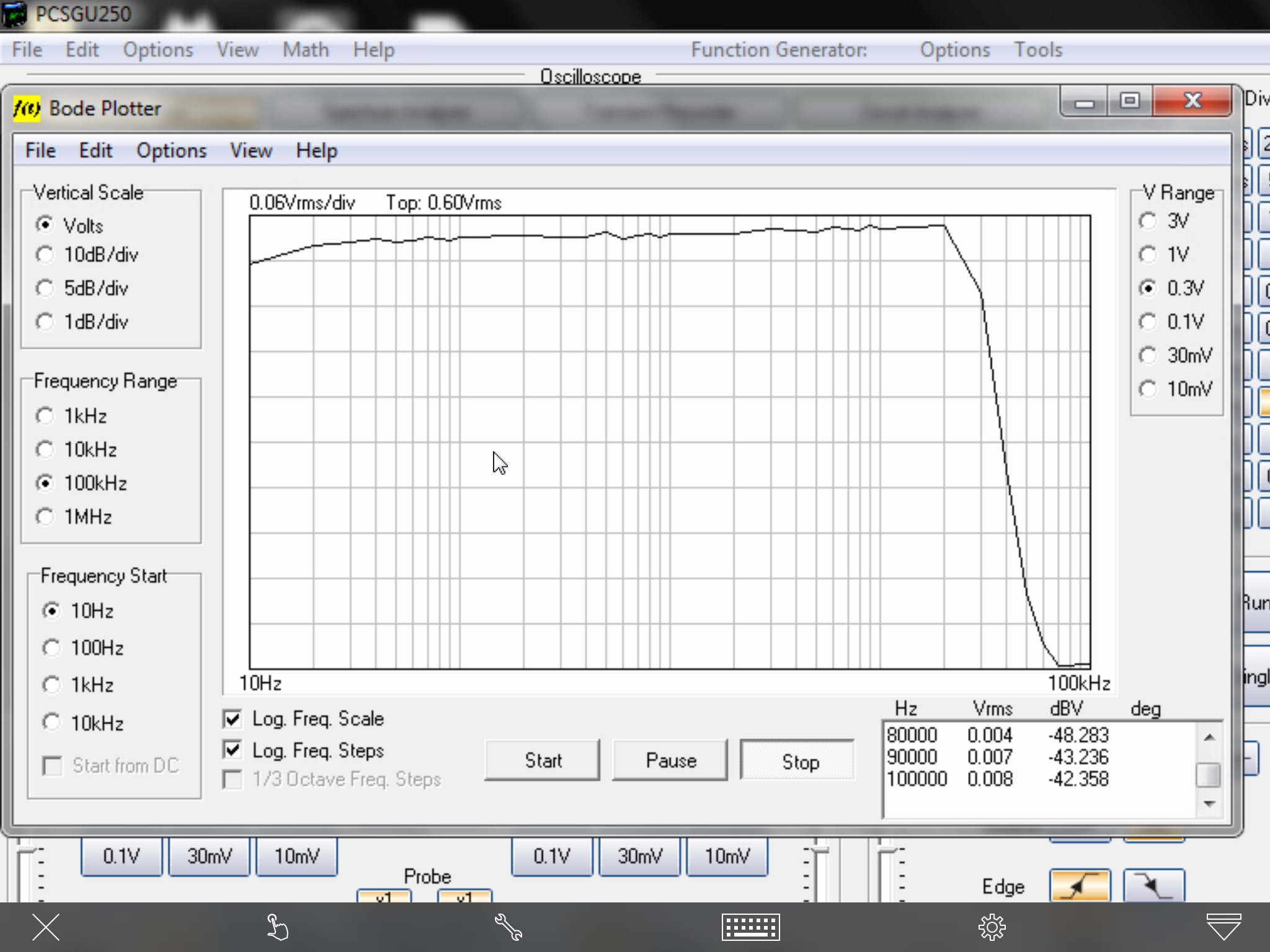

Last week i listen to my first DSD player. Windows 7 with foobar and the plugins you need to drive the amanero board. i used power supply from usb and first order filter with lundahl transformer. I did not like the sound, it had no dynamics and no detail. it was also very difficult to get a flat frequency respons with the transformer.

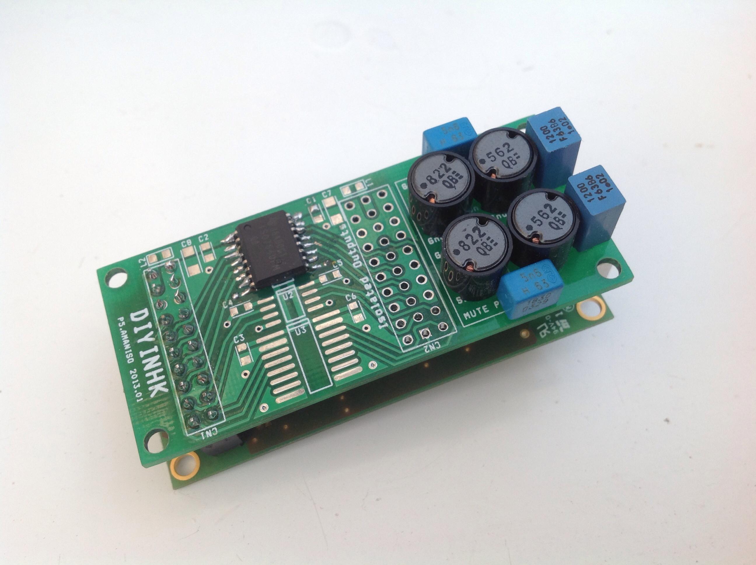

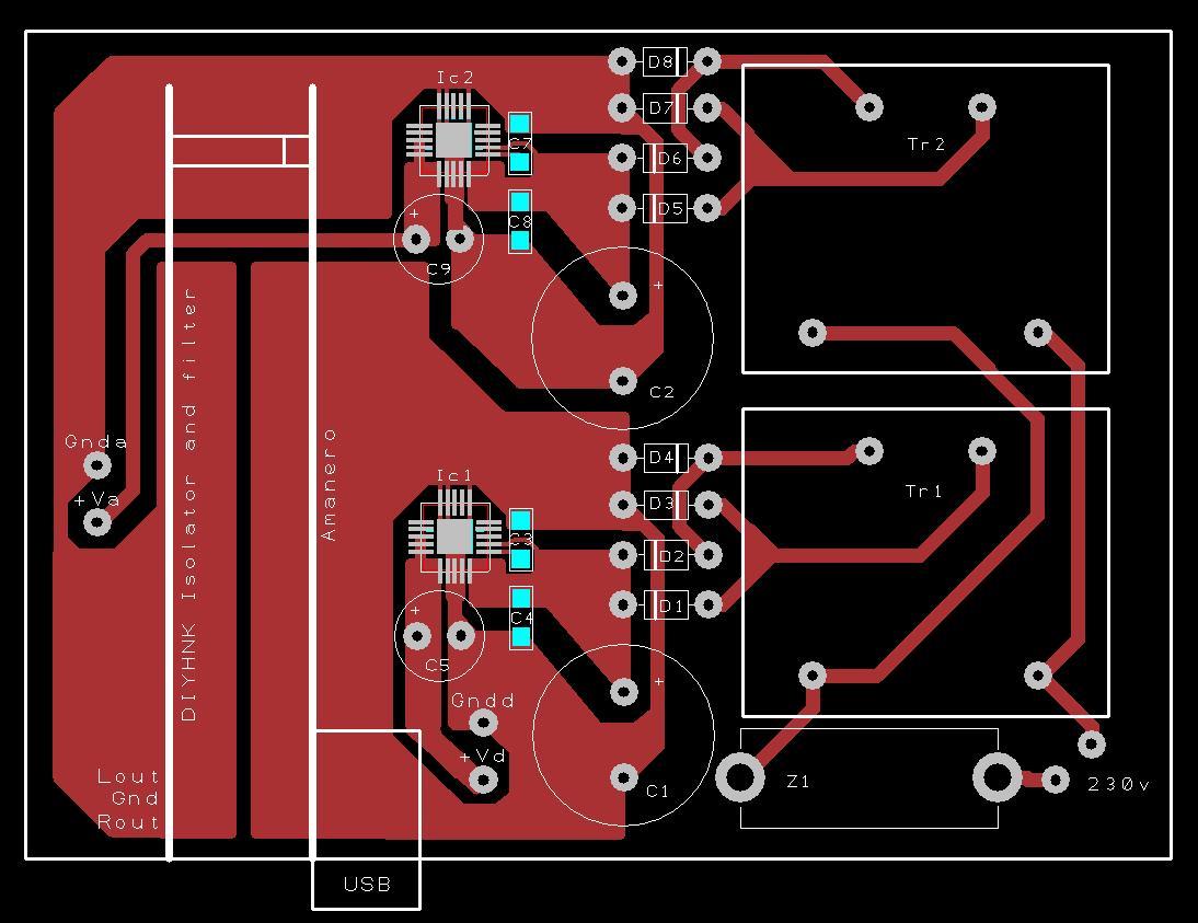

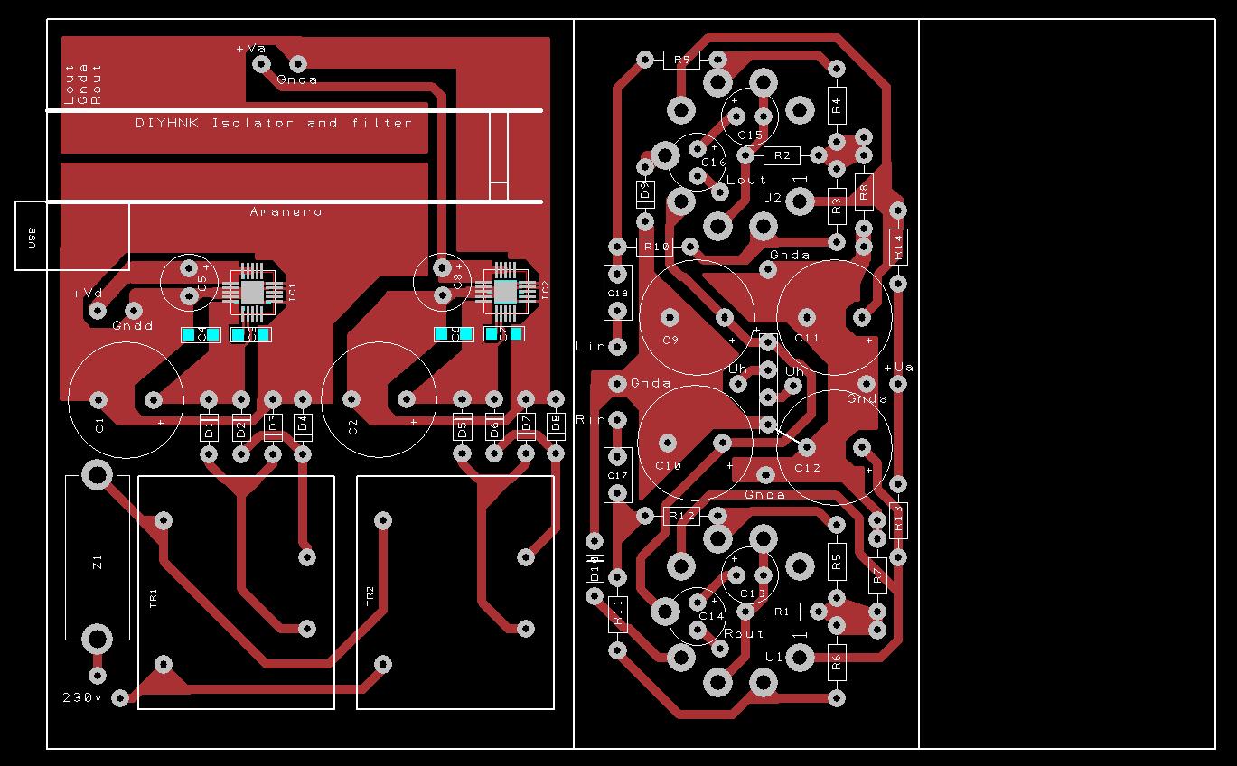

This week i build a isolator for the amanero board with iso7640fm ic. After the isolator i use a fourth order filter. Because of little humm problems in my first setup, i try in this setup , salas shunt 5v for amanero, Salas shunt 5v after isolator. Just waiting for some smd parts for the isolator board, but below a photo from the isolatorboard and filter.
As mentioned before is the power supply very important. I have made a PCB with seperate low noise supply for USB/Amanero and Isolator/Filter. Analoge output is about 3.5Vrms at 2.25V dc level. You will need to ad a capacitor in the output to filter out the DC.
