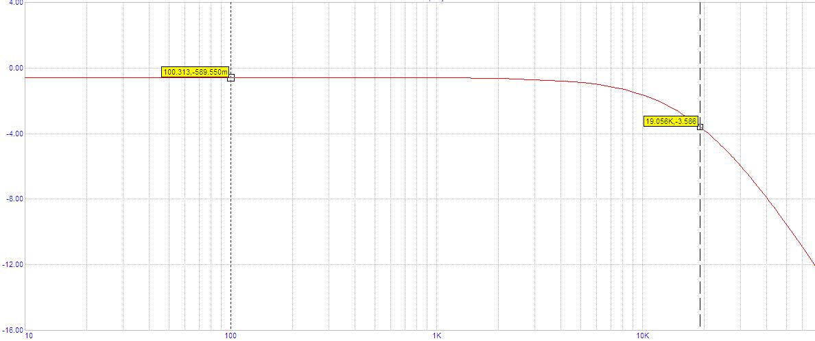

FILTER OF NAUTIBUOY
sincere compliments for your good work.
Very well for this filter, also if me to always avoid every condensers in the passage of the signal.
This filter have attenuation of -3dB to 20 Khz ... very limited in high range !!! ... but I resolve this problem directly with lift the lack of frequencies from the valve, inserting a small capacitor among cathode and ground of around 1.5 nF.
With this small capacitors the linearity is around 40 Khz to -0.1 dB.
JEDY
JEDY

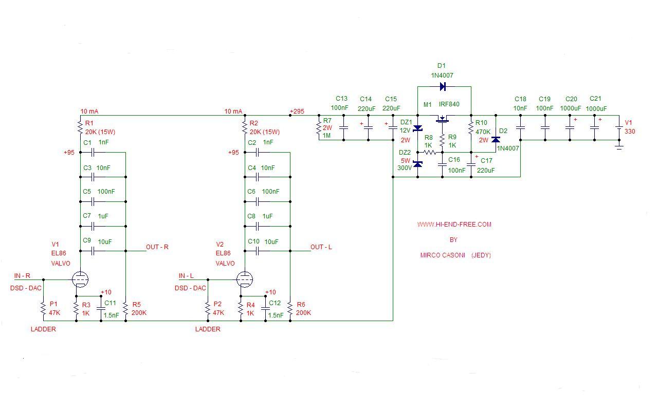

PREAMPLIFIER FOR DSD DAC
I'M SORRY for all.
I give this my special preamplifier with EL86 for your DSD DAC.
I with this preamplifier win a lot of competitions of HI END CAR (of special quality).
I adore the sound of 6H30, but the EL86 offer best musicality.
I make to you this my personal gift for your constant work and good result.
Sincere compliments for all and good continue work.
JEDI

I'M SORRY for all.
JEDI
No need to say sorry for anything jedy and thanks for sharing your design with us. I will have a look at it tomorrow (it's late now).

Dear Mr. NAUTIBUOY,
I'M SORRY for all.
JEDI
