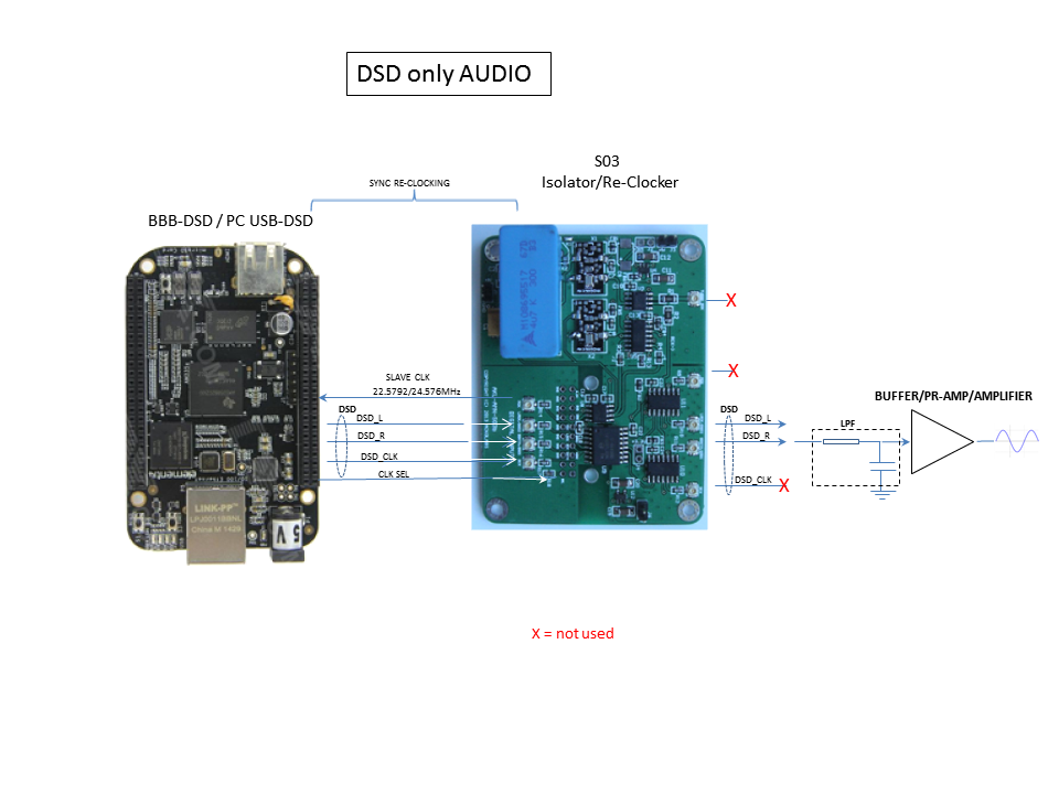

I looked at the other thread that you are heavily involved in. This diagram I found there is interesting. Question - why can't we take DSD from the BeagleBone directly to LPF? What exactly does the reclocker do - actually why is it important?

.. why can't we take DSD from the BeagleBone directly to LPF? What exactly does the reclocker do - actually why is it important?
This is going off topic a bit, but using de DSD from the BBB would work.
However a reclocker does several nice things, it provides much better clocking to the BBB (see arrow in the diagram going to the left), this works when using Miero's "Botic" driver (http://www.diyaudio.com/forums/twisted-pear/258254-support-botic-linux-driver.html). & the reclocker then reclocks (with the same clock) and provides ground plane isolation.
All this will be quite the learning curve, but well worth the time and effort, if you enjoy this sort of thing. :)

I think Stijn001 has answered your questions as well as I could;
but I would add a little more information (not completely related to this thread but still important);
  • Not only does the reclocker improve the clocking of the BBB but it also gets around its shortcoming of only having a single clock that works with 48KHz data family sampling rates. A stock BBB will have to resample 44.1KHz data rates to 48KHz and that may be audible. By disabling the BBB's onboard clock and using the two reclocker clocks native data sample rates are preserved.
and a little more emphasis;
  • The key benefit of the reclocker module is less jitter and I believe that is fundamentally important to DSD. In fact, the reclocker isn't just about devices like the Beaglebone, it will bring similar sound quality improvements to many of the USB devices that have been mentioned in this thread (you may note that Acko originally developed his reclocker board for use with the Amanero USB board).
