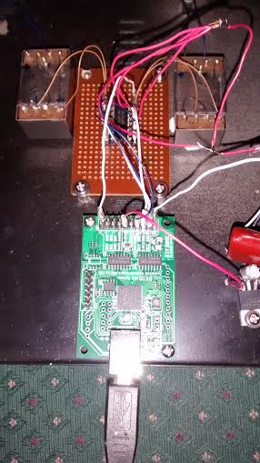

Well I have had some good results today. I bought a 74HC74 flip flop. It cost me $1.98
. I have connected the output of the DIYINHK USBtoI2S board to the flip flop, and the complementary outputs of flip flop are connected directly to my Lundahl 1527XL transformers. I have a filter on the secondary of the tranny (15nF in series with 1k). And that's it. Sound is going straight to my balanced amps. Thanks to peufeu for the advice about the flip flop.
And .... its sounding good. The flip flop has adressed the problems I had when the USB board was trying to drive the transformer directly. ie the bass is now at the correct level, and the overall output level is much higher (I had to turn amps up to 11 before, to get a normal listening volume).
I am listening to some recordings my audio buddy made through my Tascam DSD recorder. We have been recording LPs at DSD128, and playing these back right now -- wow, sounding very good.
The whole thing is only prototype and far from optimised. The power is from a computer SMPS, 5 volt output is going directly to flip flop and I am using a 3.3V reg between the 5V and the USB board. And the wiring - well I grew up wiring point to point, which is OK in valve amps maybe but in high speed digital circuitry - I am getting a fair bit of noise. But that's all OK, now I have something that works I can fine tune it because there is heaps of potential.
So I set out to build a DSD play back system without a DAC. I think that this is now working albeit with a flip flop instead of a DAC. I'd like to think that my way is better, but is this cheating? Is there an easier way to do this?
For now I will re-build my USB/DSD player and enjoy it. I'm sure I will think of some way to improve it, next week. In the meantime, I will start experimenting with Linux. And for something different I will play some records on my modified Lenco (which is waiting for even more modifications).
Oh, here is picture. You can see the DIYINHK USB board (green PCB) and then the flip flop (brown vero board). The Lundahls are on either side of the flip flop. AS I said, this is prototype only!!

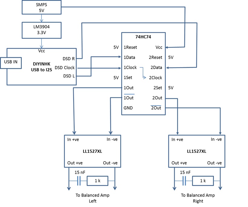

Wow great result! Can you handscrible/draw up a diagram of what you've build?
I suspect a lot of how this thing is going to sound is based on the power supply.
If the flip-flop is wired to divide by two then you may be corrupting the DSD signal, but perhaps in a way which is not immediately obvious to the ear.hazard500 said:So I set out to build a DSD play back system without a DAC. I think that this is now working albeit with a flip flop instead of a DAC. I'd like to think that my way is better, but is this cheating? Is there an easier way to do this?
If the flip-flop is merely passing the signal on, then a single logic gate would do instead.
In either case you need a good supply rail for them, as you are listening to the supply rail modulated by the final gate and then low pass filtered (either explicitly or accidentally).

Certainly, I have drawn this up and attached the circuit.
Yes, power supply is critical. The 74HC74 can take up to 7 volts Vcc, I am thinking of a SLA. I use SLAs for my phono pre-amp and a 6 volt battery should do the job here. As for your other questions - I'm afraid I don't know enough about digital electronics to provide a definite answer. As far as I can tell from the spec sheet, output on the 74HC74 follows the input. I don't know why (or how) it would divide by 2. So as far as i can tell it does just pass the signal on. Would a single logic gate work? No idea. I don't know anything about logic gates except for what i have learned in the last 2 days!! But the critical thing is that 74HC74 has complementary outputs (in a digital sense) - in an analog sense, this means balanced output which is ideal for me. Would a single logic gate have complimentary outputs?If the flip-flop is wired to divide by two then you may be corrupting the DSD signal, but perhaps in a way which is not immediately obvious to the ear.

I must say this is a neat circuit. (presumably the battery replaces the "SMPS" in the diagram which would be about the worse thing to power this with.
I'd also add a little (more) R/C filtering at the output, to prevent the ultrasonic and RF noise from going into the amp. Well, okay, in the earlier post you said these are going through transformers, and they will likely not pass much of the above-20kHz stuff.
In some configurations such a flip-flop circuit will divide the frequency of the input clock by 2, but not in this circuit.I use SLAs for my phono pre-amp and a 6 volt battery should do the job here. As for your other questions - I'm afraid I don't know enough about digital electronics to provide a definite answer. As far as I can tell from the spec sheet, output on the 74HC74 follows the input. I don't know why (or how) it would divide by 2.
If there's any concern, I'd want to see the timing of the DSD R/L/Clock signals from that other chip. It's possible for there to be a "race" condition where several things change at virtually the same time and an erroneous latch could occur. If so, fixing it would only need a 74HC series inverter between the DSD Clock output and the 74HC74 clock inputs.
You could make complementary outputs just using an inverter, but it has a delay and thus it would be different from the uninverted output. With a flip flop, the inverted and uninverted outputs change at the same time, after a small delay from when the clock input changes.So as far as i can tell it does just pass the signal on. Would a single logic gate work? No idea. I don't know anything about logic gates except for what i have learned in the last 2 days!! But the critical thing is that 74HC74 has complementary outputs (in a digital sense) - in an analog sense, this means balanced output which is ideal for me. Would a single logic gate have complimentary outputs?

As far as terminology, the 74HC74 as used is arguably a "dual 1-bit DAC", and indeed a good power supply is critical because the PSRR here is 0 dB. Any variation of the 74HC74 Vcc line directly modulates the output.So I set out to build a DSD play back system without a DAC. I think that this is now working albeit with a flip flop instead of a DAC. I'd like to think that my way is better, but is this cheating? Is there an easier way to do this?
You're forgetting that it's a "digitally balanced" output. The signal is differential and across two outputs - one is always at ground while the other is always at VCC, and the amplitude is always the difference between them. The output gets modulated whichever state it's in.
Yep I hadn't picked up on that - I was only considering a single output pin of the HC74. So then the PSU noise will be added to the +ve phase for half the time and to the -ve for the other half of the time on average. So it looks to avoid noise modulation, assuming that the PSU noise is free of any correlation with the signal.

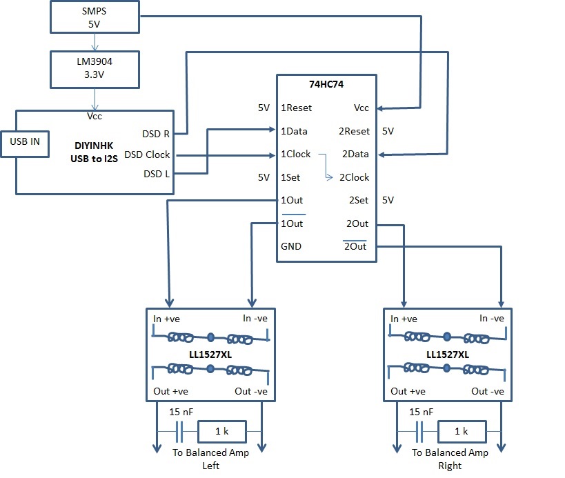

Can you add a little something to your diagram - the pins you're using on the LLundahl transformers. I'm assuming you're still using 1:1 series connection but would be good to confirm.
Are you still contemplating the Silk attenuator transformers you linked to back on page 1 of the thread? Volume control would be really handy.
If I can lay my hands on some suitable transformers I'm tempted to have a go with your circuit.

yes, tx is 1:1. Circuit diagram updated.Thanks hazard500, appreciate your sharing this and it'll be interesting to see where a more considered build takes it.

Sorry, I jumped to a conclusion: that someone messing with digital electronics and choosing a flip-flop would know enough digital electronics to know what a flip-flop does (and what a logic gate does).hazard500 said:As far as I can tell from the spec sheet, output on the 74HC74 follows the input. I don't know why (or how) it would divide by 2. So as far as i can tell it does just pass the signal on. Would a single logic gate work? No idea. I don't know anything about logic gates except for what i have learned in the last 2 days!!
No, a logic gate has one output. However, it is trivial to arrange two suitable logic gates to get complementary outputs.Would a single logic gate have complimentary outputs?
You will still get noise IM, as it is the supply rail which sets the voltage gain of the output stage. The rail must be very clean, probably cleaner than usually required for normal analogue stages. Normal analogue stages have their gain loosely set by the supply rail; this analogue stage (yes, it is an analogue stage even though it uses 'digital logic') has its gain set directly by the supply rail.abraxalito said:So then the PSU noise will be added to the +ve phase for half the time and to the -ve for the other half of the time on average. So it looks to avoid noise modulation, assuming that the PSU noise is free of any correlation with the signal.
