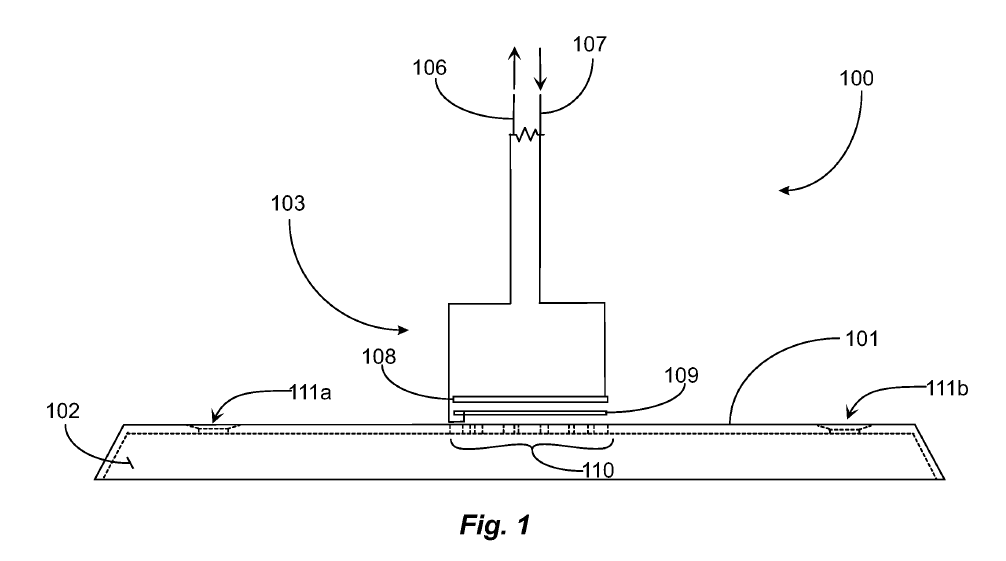

Final version still not available on uspto.gov
However, the application is downloadable; it is attached below. Although it looks to me like cover plate 102 is drawn backwards (!). The chamfered bolt holes "111" belong on the front of the plate, not the back. Similarly the stampy bendy 45 degree corners belong on the back of the plate, not the front.

Actually the mic is just on the wrong side! Next application I will be sure to have you review it, as no one else noticed! (Not my sketch!)
However the claim is the hole size and spacing, so that drawing would still work! Just would look really stupid.
I have orders coming in for about 6,000 units this year!

The claim is using a diffraction lens to widen the coverage angle of a microphone.
The only prior art claims to use diffraction to narrow the coverage!
So of course I showed actual measurements of the off axis frequency response.
