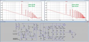

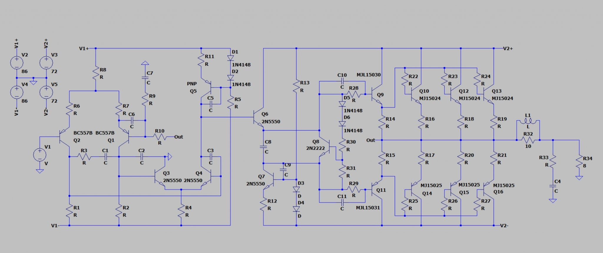

Howard,
I have entered your amp's essentials in LTSpice with a 8R speaker load, but without the short circuit protection.
Also the power supply caps are missing, because in LTSpice power supply is rock solid and adding caps doesn´t improve anything.
The same for paralleling caps, it´s just the bigger one that matters because they are ideal caps as long as no serial inductance is specified.
The Cap in your situation is C8 that I will vary for several values.
However since the circuit diagram is hardly readable, I have left the task to you to tell me the resistor and capacitor values as specified in the manual.
This would take me too much time.
Once defined, I will run LTSpice for THD and IMD.
Hans

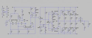

Hello Hans,
I have updated the .asc file with the actual values from the PCBs other than the semiconductors, it is attached. I was unable to find the models for the output semis you loaded, so I had not tried a sim yet. The Spice models for the MJ21193 and MJ21194 output devices in this amp are here, for some reason I could not attach them, very odd.
Thank you so much once again, I look forward to some data!
Howie

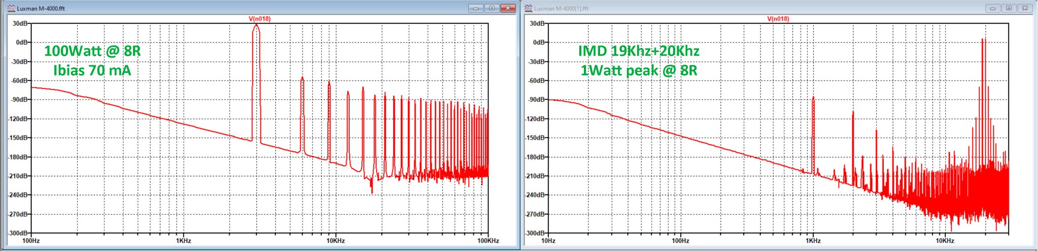

Hi Howard,
Here you are, two things had to be changed:
1) R4 into 610R to equalize the DC current through Q3 and Q4 and
2) C3 from 47pF into 1nF. This 47pF must definitely be an error.
But for the rest everything you did seemed to be O.K.
There is no difference whatsoever to find in all sims when varying C8 between 440nF and 440uF.
In the first attachment I have simmed THD with both 35mA and 70mA per output pair, so in total between 105mA and 210mA at 1Watt@8R output power.
It's obvious that with the transistors used, 70mA per output pair or 210mA in total is the better one, but in your case it may differ.
The second sim shows at the left side THD at 100watt@8R and IMD 19Khz+20Khz at 1Watt peak at the right side.
So, the answer to your question relating the Cap on the bias spreader, being independent from the used transistors, has been given with the simulations. 440nF is adequate and anything larger is not adding any benefit.
It's a bit unusual circuit diagram with lots of caps, but it still performs perfectly with relatively low distortion.
Hans

An often mentioned "scary monster" is clipping. When playing the 1812 Overture beyond the clipping point, does the bias spreader end-to-end voltage change? How badly does this affect the output stage bias { for believers in "the Barney Oliver criterion" } , increasing crossover distortion? How long does it take to recover to the correct end-to-end voltage? I.e. how long does it take to charge or discharge the capacitor in parallel with the bias spreader?
When clipping would happen without load, voltage on the Cap remains practically constant.
With load attached, long before the above clipping, the max current protection comes into action, also leading to a controlled clipping.
This will indeed discharge the bias spreader cap on the negative going slope, but this has to be a severe overload condition where discharging and recharging with the 440nF takes place between 50 to 100 usec.
When using a larger Cap, voltage fluctuations on the spreader will become smaller but it will also take longer to recover.
But I think this is what we call in the Netherlands "searching for snails on salty water".
When music played that loud that clipping occurs with this very amp, I would be more concerned for my eardrums.
Hans
