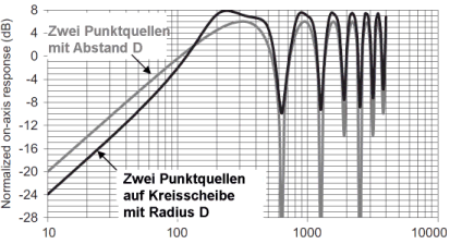

Next pic comes from Tim Mellow, at Rudolf Finkes's homepage Dipolplus - Alles über offene Schallwände
![mellow_1.gif](/community/proxy.php?image=http%3A%2F%2Fwww.dipolplus.de%2Fimages%2Fmellow_1.gif&hash=65f70d17199b6faad68c94c5b38986fa)
Yes, we need more tests and measurements, also off-axis...
And I am focusing on SL's bolded and double underlined "2d1=D"
To me that says that virtual baffle of compound radiators is same as H baffle with same pathlength (which determines axial dipole null)
This means that compared to a single nude driver, compound gets a virtual baffle which gives more spl to low frequencies and shifts axial null lower.
