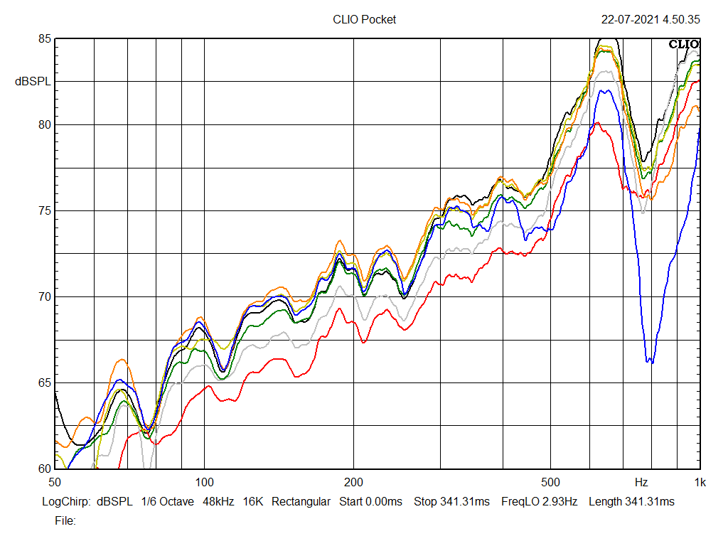

I wanted to explore the nude clamshell arrangement a bit more to figure out what was going on so I did some measurements. It's cold out today so I scaled down the size of my test rig so I could do it indoors. Drivers were 15W/8530K01 There was always the magnet of one driver facing the mic. Its mounting flange was 500mm from the microphone.
First plot is a single driver (Red), two drivers with ~2mm surround spacing (Grey), 25mm spacing (Green), 50mm spacing (Yellow), 100mm spacing (Orange) and 200mm spacing (Blue)

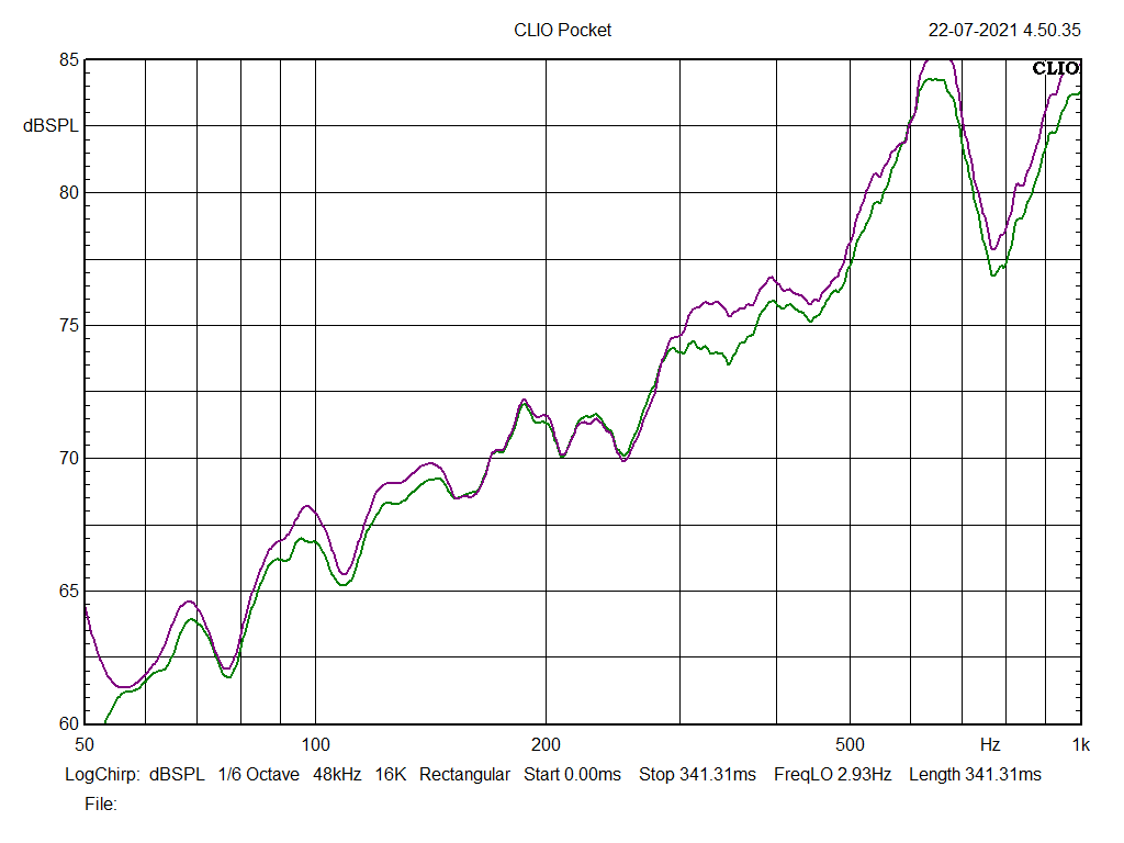

This next plot shows the two drivers with a 25mm spacing (Green) vs the same with the chassis taped together to seal them up, effectively puting them in a tube (Violet).

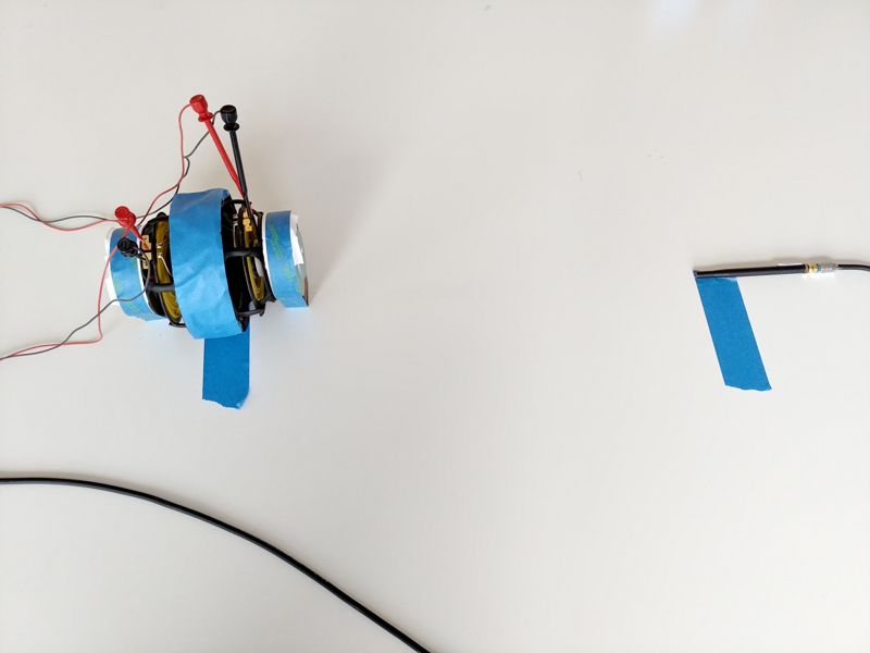

Here is the test setup for the second plot:
The plot with the drivers sealed in a tube vs nude suggests to me this arrangement is behaving as though there is a slug of air simply moving back and forth between the two drivers, when they are mounted reasonably close together, not two different to b. in this image:

The top plot also suggests this is true up until it all falls apart around when the spacing aproaches the chassis diameter.
OK, trying to get my head around these really interesting results - so it is great you have confirmed and validated my measurements - with the 6dB rise in output with this configuration versus a single driver.
But how do we explain the similar results with the sealed isobaric configuration?
My second thought is - the difference in your outputs apart from the grey measurement (2mm separation) are all actually not that different given your scaling, and therefore could be explained by a change in the acoustic source distance from the mike - given you are measuring only 50cm from the mounting flange of the front woofer?
