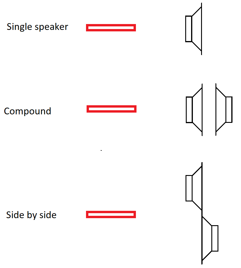

So do you think that the measured peak and valley are due to the magnet being between driver and mic?
I believe it’s reasonable to think that you start getting effects from basket structure and magnet from 500 Hz and upwards on a 5-8 inch driver. Everything (almost) I’ve learnt about dipoles comes from SL. Look at measurements of the Phoenix (main panel, p3) System Test
We are squinting at these charts - William has shown a 4.5-5dB increase in output.
I have shown an ~6dB increase.
There is 1-2dB differences here that we are drawing conclusions from.
I am the only one to use two separate amps with the same power and output with the same ohms per amp - a proper, like with like comparison.
Can someone please repeat my measurements with two amps and the same loads per driver?! Please?
I think William used the same setup and kept constant distances between mic and speakers as I did. So, the higher distance of the 2nd speaker to the mic could have some impact? Second, apparently the distance between both speakers in the compound have an impact on the output.

We don't know if we are dealing with a 'virtual baffle' of sorts, an isobaric set up with the 'slug of air' loading both drivers, or the two drivers behaving individually and summing as they would if side by side.....
We have at least confirmed the increase in output beyond that to be expected if there was no summing of the drivers (i.e. an increase beyond the expected 3 dB of increased amplifier power).
Even if this is just behaving as an isobaric set up - as I have previously said - this finding could save people significant costing and labour - no requirement to create an air tight, sealed volume between the drivers.....
Perhaps your smoke idea might also be useful - this would demonstrate if the 'slug of air' is indeed contained between the drivers.
I still cannot see how the two drivers can be 'linked' by this 'slug of air' without containing said 'slug' in a sealed enclosure to pressurise it - I think that the drivers will still create pressure and rarefication waves from the spacer gap - i.e. acting as two separate dipole sources.

I don't think so. There was no sign of pressure or vacuum acting on the tape. Indeed the test sounded exactly the same whether the tape was there or not.
I'm quite sure the back of driver A saw the back of driver B as the return path and not the front of driver A. There was no low pressure zone in front of driver A when driver A was moving backwards. The nearest low pressure zone was the back of driver B. A seal around the drivers was not required for this to look like an isobaric pair.

Actually this would be a great way to prove you are right - can anyone see any issues with me laying a sheet of toilet roll over the top 180 degrees of the spacer gap, and then firing up the subs with a 40hz sinewave?
If the toilet roll doesn't move - I am proven completely wrong - correct?!

I think this will need more explanation for me - if the toilet paper flies up into the air, or is instantly sucked into the gap - how do we explain this without concluding there are sound waves emanating from said gap?
You said the tape didn't move at all - so there must be virtually no pressurisation or rarefication in the gap given this was just tape?
I can restrict the toilet roll to literally just the gap - my spacers are 15cm.
So all isobaric constructions to date have been based on a falsehood!?
That's an incorrect oversimplification.
Picture the operation of a pair of 6" drivers 1M apart, vs the same pair with a connecting tube. The behavior would be very different. The latter would behave like a dipole with D equal slightly over 1M, the former would be an acoustic mess.
A pair of 6" drivers 25mm apart vs a pair on each end of a tube would be quite similar.
