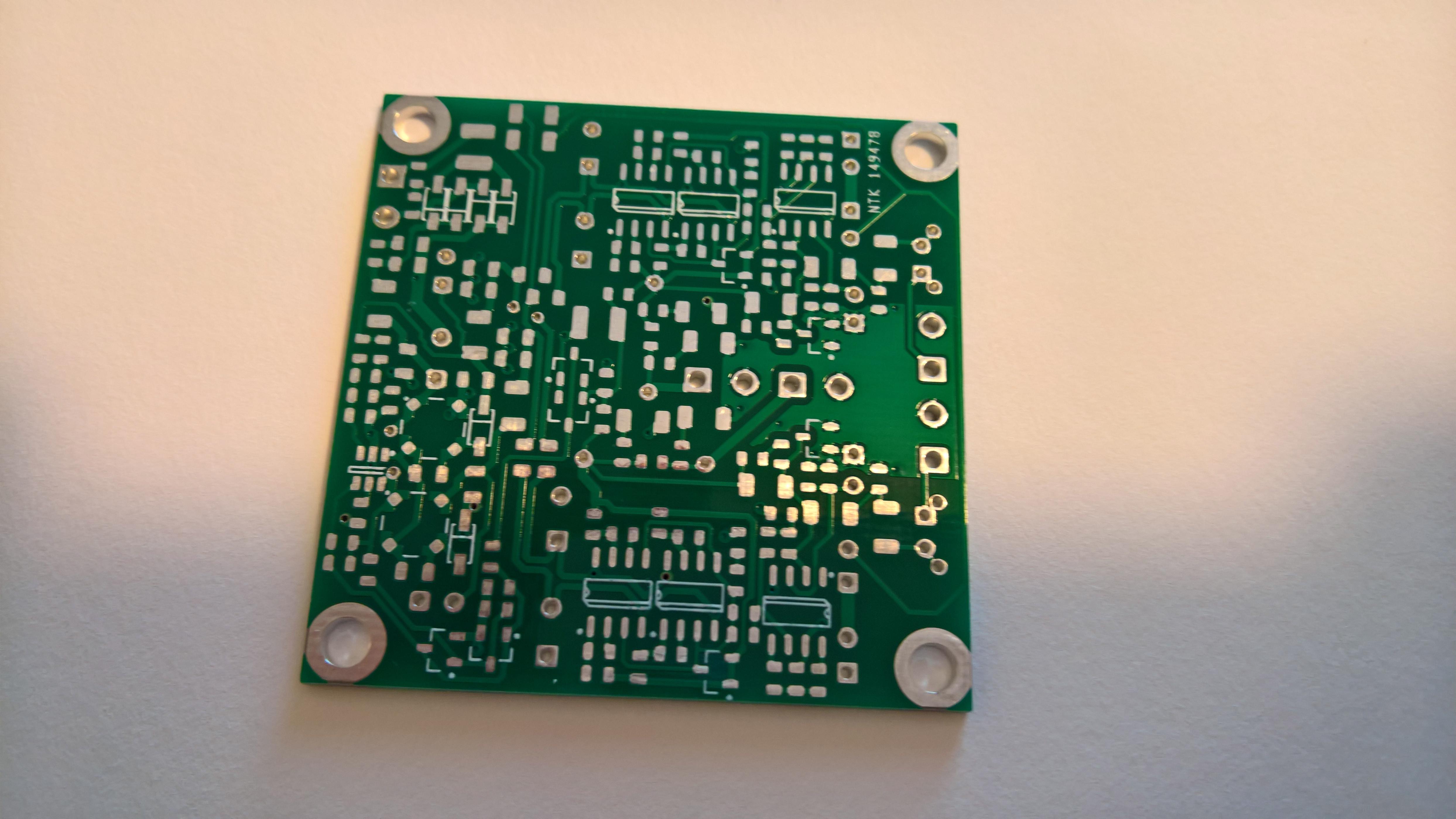

Give me a bit of time, I'll make a proper drawing for you.
Thanks! A BOM would be helpful too, just whatever parts you used.
Here it is. A little bit messy because of long names, but should do the job. BOM is coming shortly.
That works! I see the other side by scrolling down in the PDF. So that photo in post #1 actually IS the bottom. This will be a fun build.
Here is the BOM.

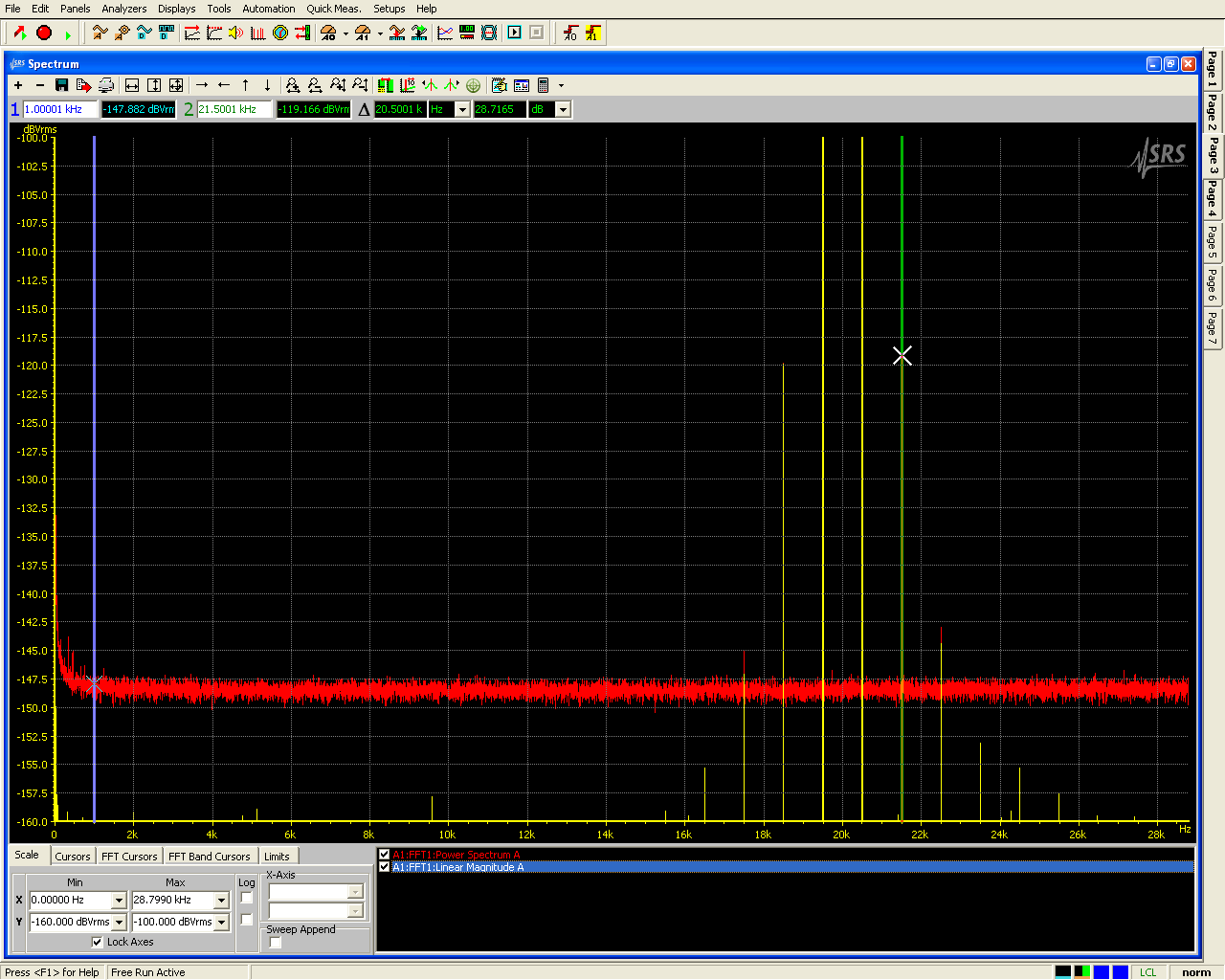

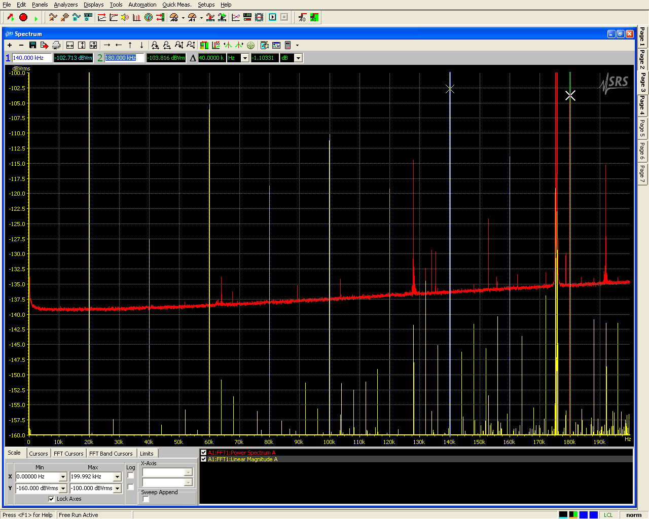

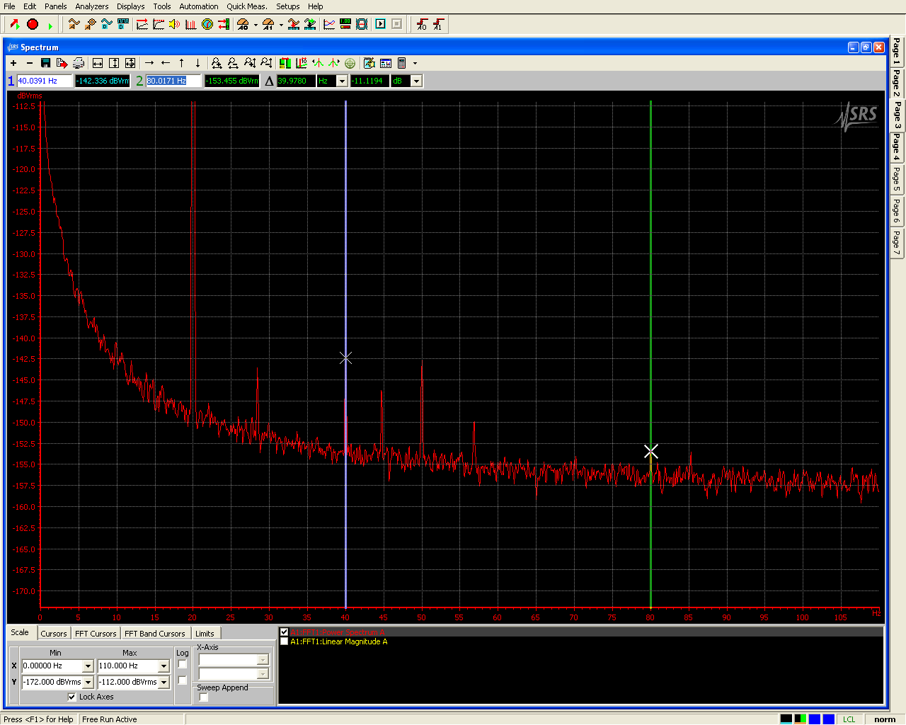

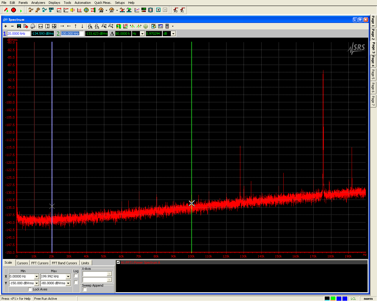

Best bang for b̶u̶c̶k̶ milliamp of the idle current - used two OPA2172 (OPA1688) in the output stage, leaving OPA1611 at the input.
Configured to G=-1. For G=-2 distortion scaled ~6dB (which is a good sign).
Output voltage was 2Vrms (+6dBVrms) in case of 20Hz, 1kHz, 10kHz and 20kHz test tones and 1Vrms + 1Vrms for the mix of 19.5kHz and 20.5kHz tones.
Load purelly active, 16.4Ohms.
Supply voltage is +/-6V
Have used a bit of a vector averaging in IMD test to reveal 18.5kHz and 21.5kHz components.

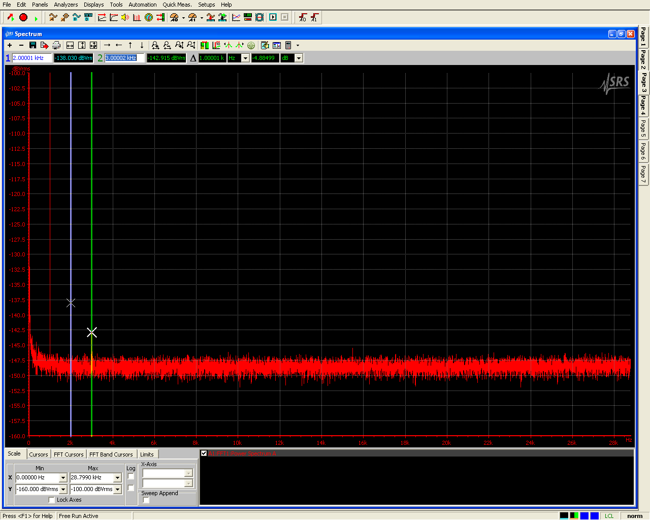

So, just briefly, for the 1kHz tone the second harmonic is ~-144dBc

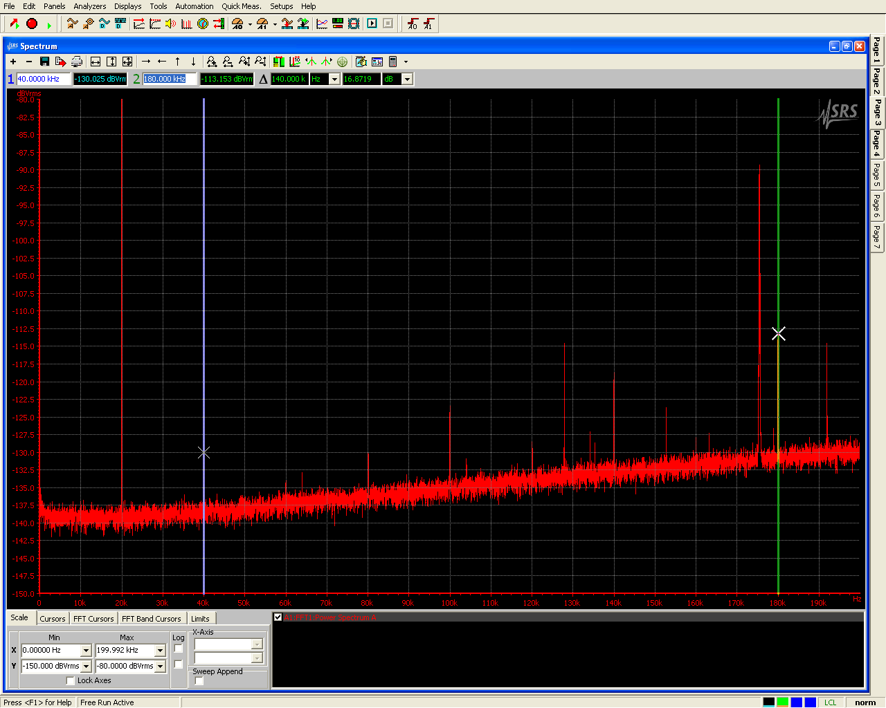

for the 20kHz signal there are some higher order harmonics visible. 9th (180kHz) is on the level of ~-118dBc

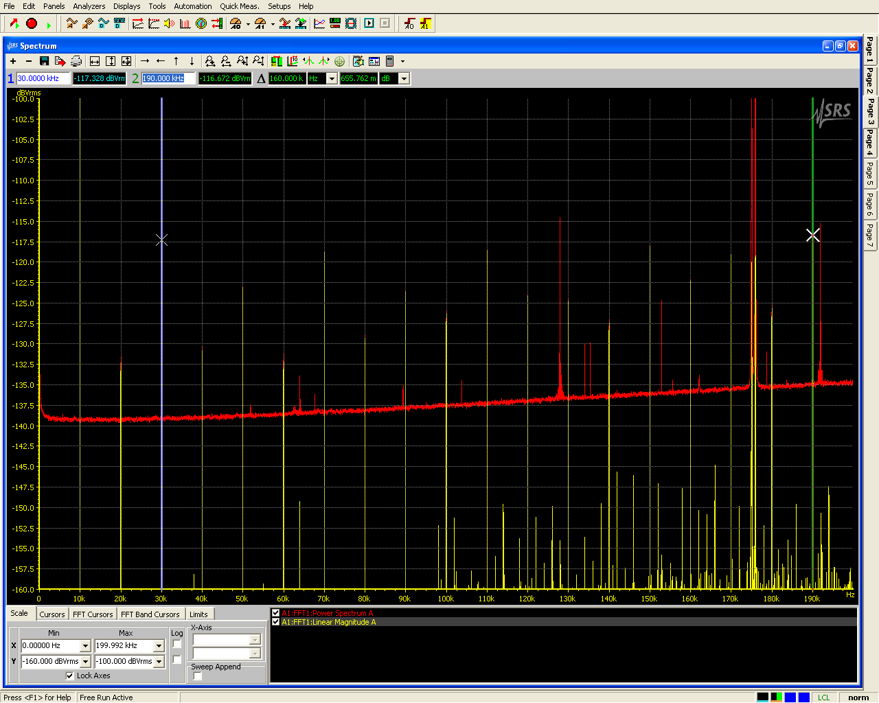

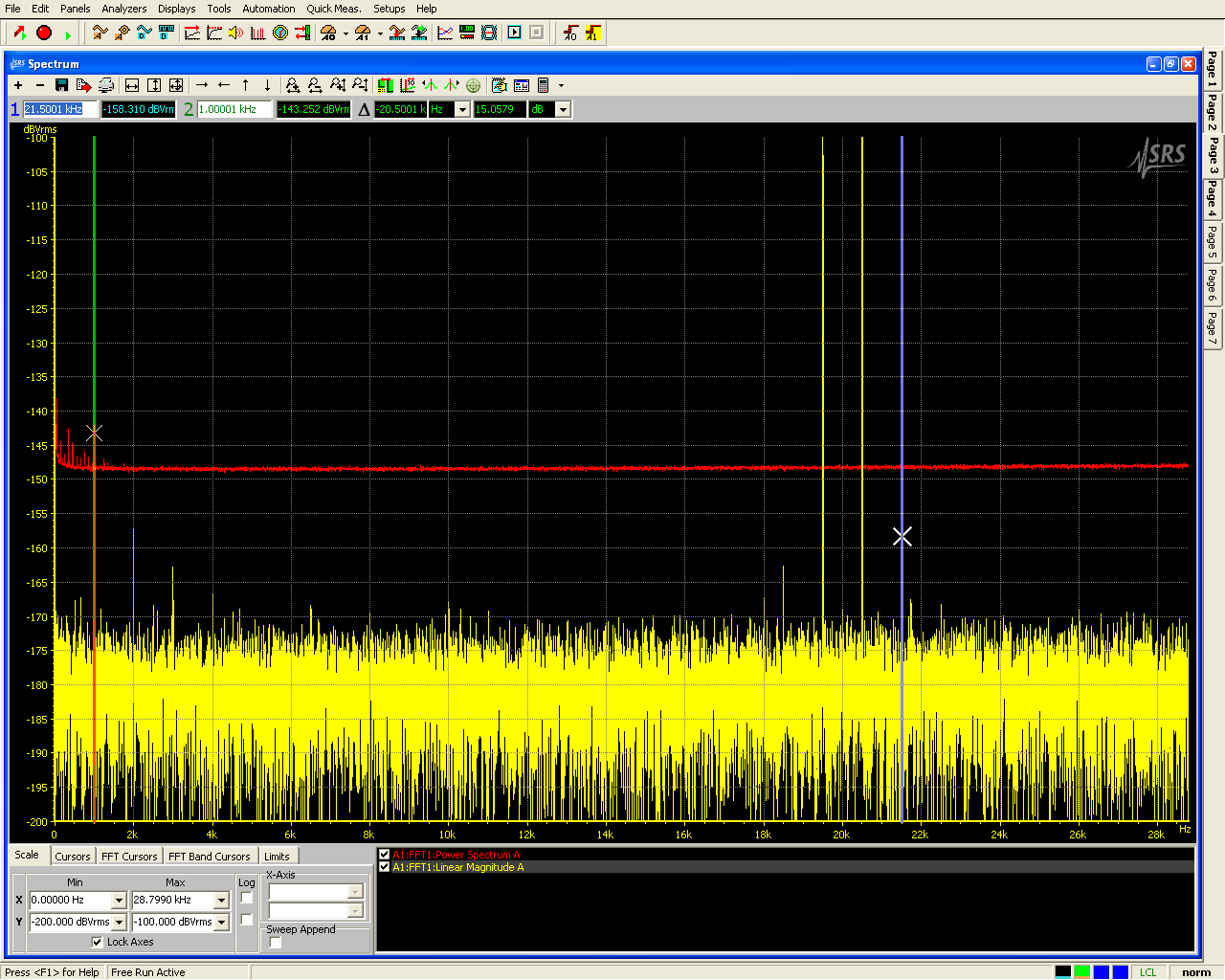

"Best bang for a milliamp, episode 2" or "what it would look like if I substitute OPA1611 with OPA(2)172/(OPA1688)"
Conditions are exactly the same - output signal is at the same +6dBVrms. Used vector averaging during some measurements to get rid of interference.
20Hz and 1kHz spectra look quite clean, there is hardly a substantial difference, but it is obviously lover GBW opamp. It gives up much earlier - even 10kHz spectrum look quite contaminated with harmonics.
Is it really that bad? Perhaps no, since even tallest 7th harmonic for 20kHz signal is almost -109dBc and all these harmonics are far from audio frequency range. IMD spectrum has much wider skirt around the main tones, but it is still 119dB down.
