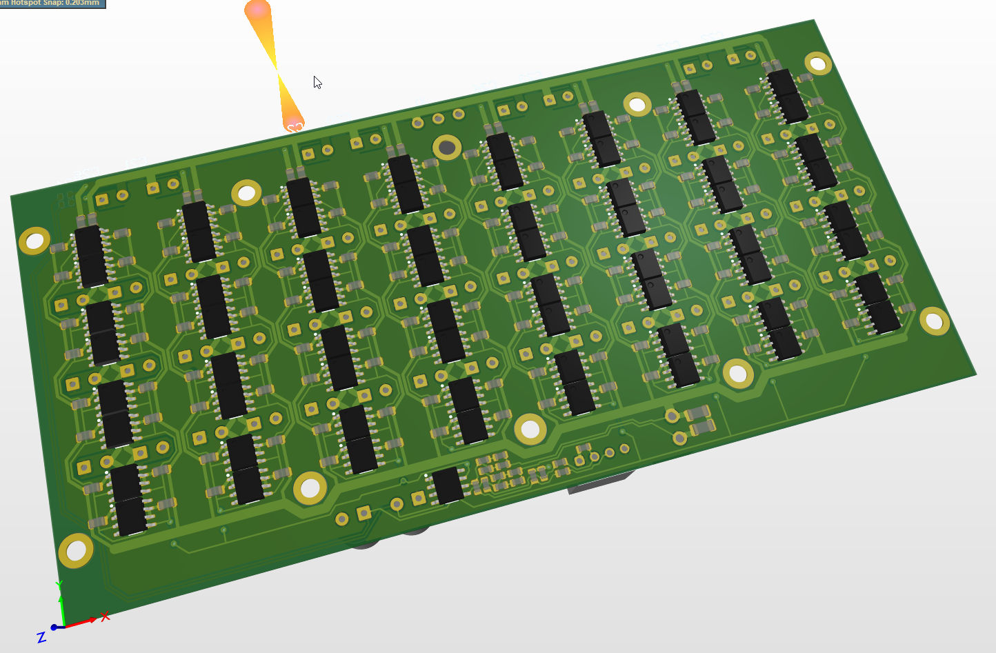

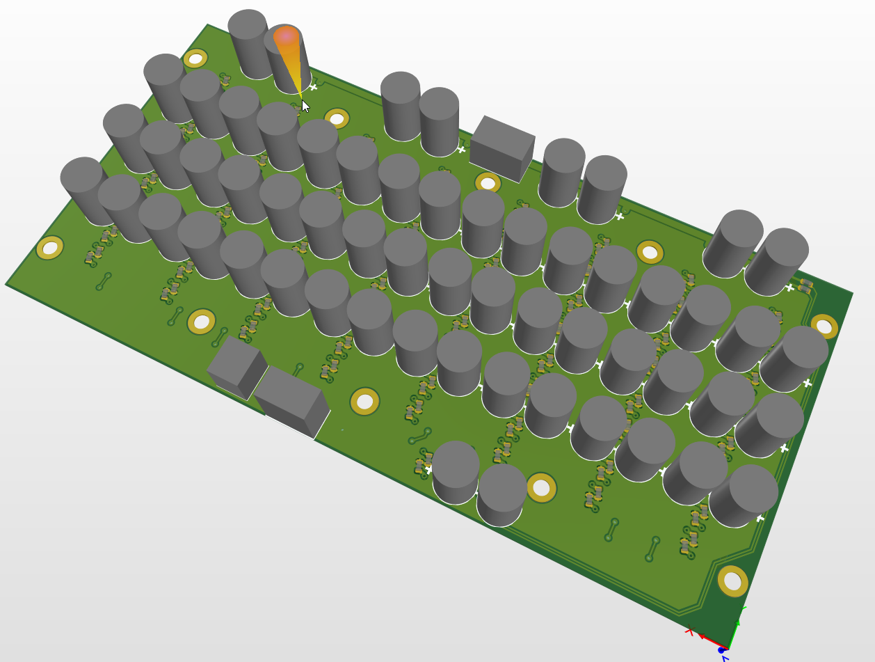

Finally found some free time to put those spectra from opa2156 distortion measurement into a document. There are mistakes for sure, so please open with caution

This is the distortion of opa1656 alone with gain = +/-1 right?
OPA2156, but yes, one half of it by itself.
Oh, thanks for correcting me. So opamps these days are really good at driving heavy load. I thought that opa1622 is already the best but there are many other opamps have similar performance.
