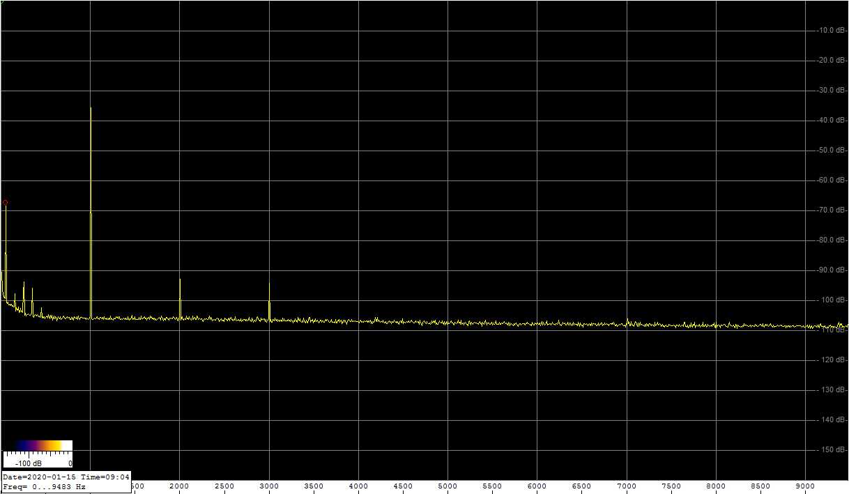

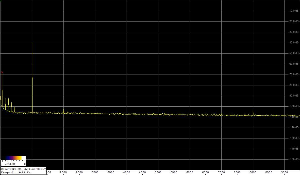

THD of Crocodile #2, a DIY measurement attempt
I ordered the PCBs a couple of months ago, but only now came round to start soldering. My first 0603 project, not easy at the beginning, but I've got it under control now.
The PSU worked at once, no visible switching artifacts on the rails; with the components from the BOM, the voltage is 10.3 Volts.
Having soldered one channel, I listened a little with the headphones. Without the input signal, the amp is dead quiet.
Time for measurements: I don't have a commercial distortion analyzer - my DIY system consists of Victor's 1kHz oscillator (THD < -150dBc), adjustable notch filter (Hall topology, PCB design by S. Groner), and a 60dB LNA, also designed by S. Groner and described in Linear Audio Vol. 3 (volumes | Linear Audio).
The audio interface is a modified Motu Audio Express, the data acquisition & analysis software is Spectrum Lab (DL4YHF's Audio Spectrum Analyser).
Repeating Sergey's test at the output voltage of 3Vrms into a 33 ohm load, I got the results presented in the first attachment. Only two harmonics are visible above the noise floor, the 2nd at -102dB, and the 7th at -103 dB. Taking into account that my notch filter attenuates the 2nd by 10dB, and that the LNA gain is 60dB, the estimated 2nd level is about -152dBFS, i.e. -147dBc (3Vrms vs. 5Vrms is -4.5dB).
For the fun of it, I tested the amp also at 5Vrms into the same load (2nd attachment). Without going into details, THD can now be estimated to be about -145dBc - note the power of 0.75W at the load!
I repeated the measurements with another LNA (by Scott Wurcer, My version of the G = 1000 low noise measurement amp (for Ikoflexer).) and got similar results.
Now I'm not an audio designer, but I must say that I've never seen such THD values, not even at a line level.
My thanks to Sergey for sharing such an excellent design!
