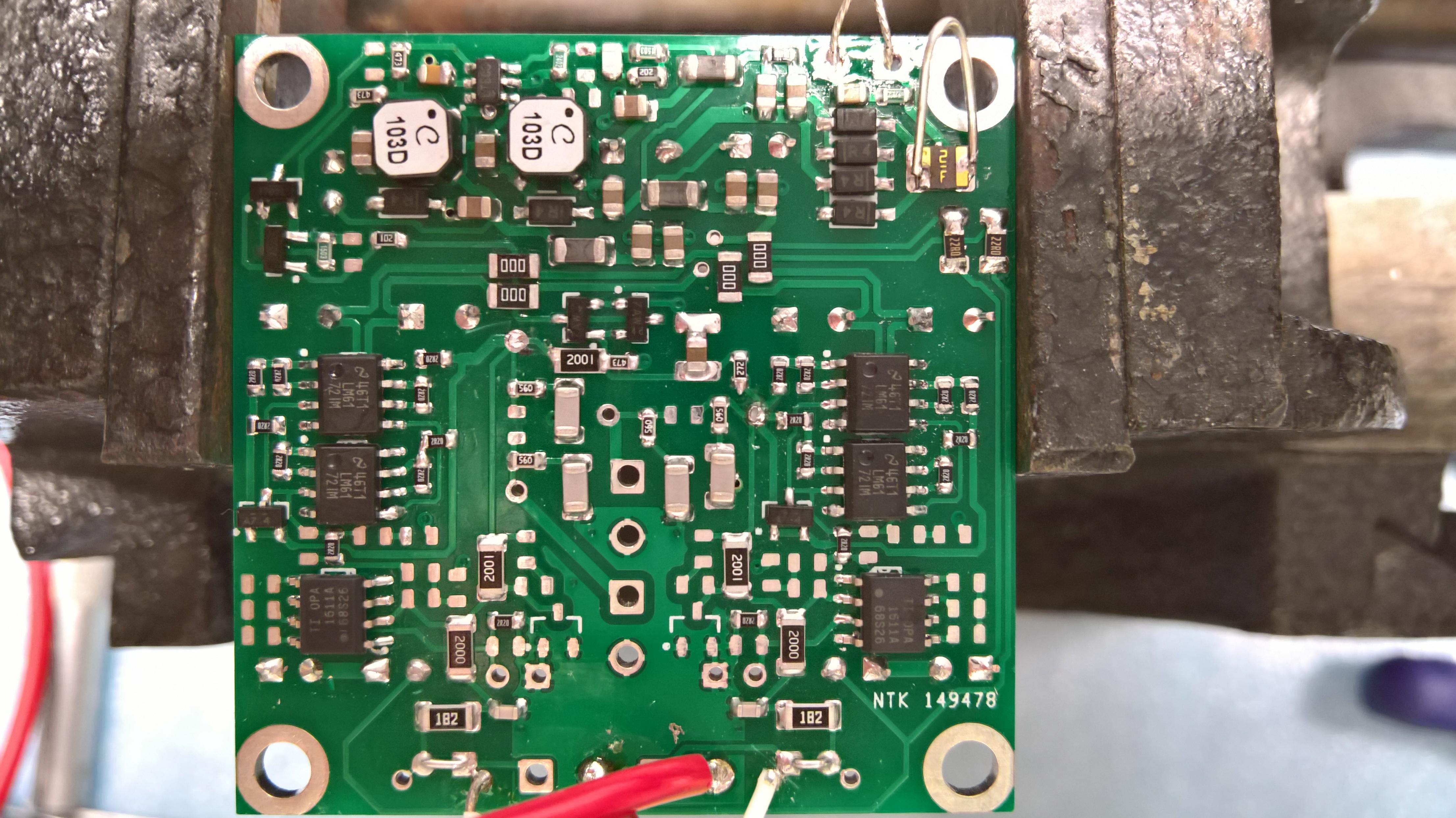

Ok I got the three power circuits soldered down....found I am missing the two of the transistors, a few caps and 22 ohm resistors, I do have some 22 ohms but again they are just too small to bridge the pads....
Will start on the two channels and then get a master whats missing and needed to include a vol pot, a headphone jack, input I/O connectors..

ok I attached a 9vdc battery to P66 and nothing popped or burnt up!
On U1300 Pin 1 I read 6 vdc
On U1300 Pin 4 (enable) I read 4.9 vdc
On L1 and U1300 Pin 6 , 6vdc
On FB pin 3 I read .45vdc
C50/C63 5.62vdc on the U1300 side and on the other side it was 0vdc.

Note this is with L4,5,6,7 installed.

I hooked up a 10K stereo linear pot, wired in RCA jacks for the dac input and wired a headphone jack to the outputs.
I dont have those air coils in yet but wired to the other side of it for the outputs....to see if any music comes out etc..
With a 9vdc battery I hear sound, but garbled and really strange...I removed the battery power and noticed what I am hearing is coming from the dac without any power !!
This is strange, but I think the power supply is not working....need to start troubleshooting..
