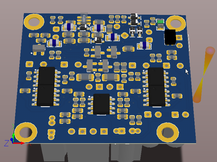

BTW, after I got I running on the small board, I made a new PCB design, where I ditched unused components etc, and it was under 40x40mm. Never sent to to production though 🙂

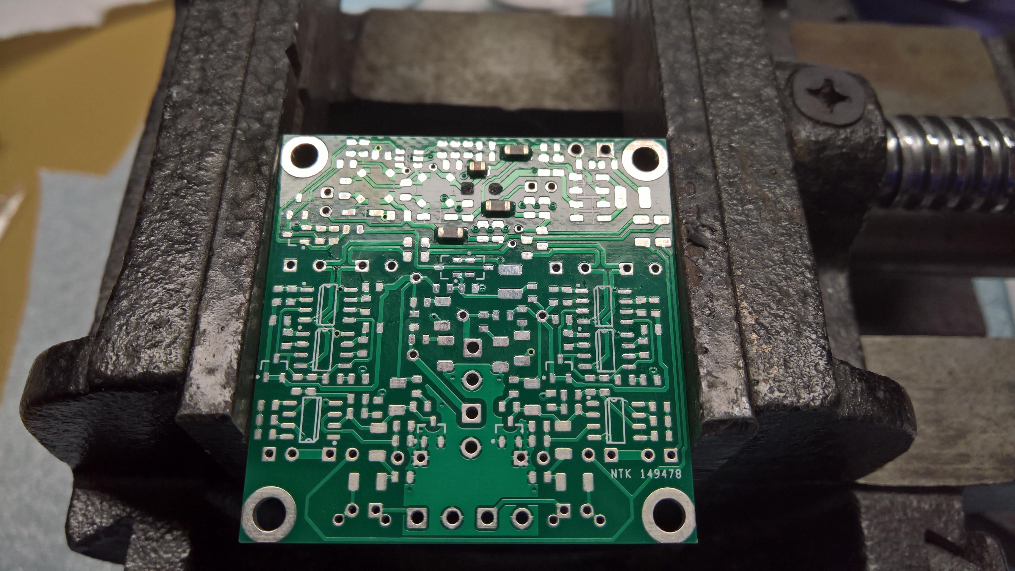

I got a YIHUA 898D+ hot air gun station for less than $50, a genuine YIHUA model and it works well with the SMD parts, and this was my first time using these really small OPA1622's etc...with another DIY's design.
I was intimidated at first, worrying about damaging and getting the parts on the board soldered without shorting stuff out underneath the 2mm x 2mm parts....but it was a lot easier than I thought....
The hard part is getting the dang things placed on the board correctly .....just have to be careful and take your time...the solder paste makes the parts stick to the pcb rather nicely, then just make sure you dont turn up the air too high and move the parts around!! lol..
I hope to start this crocodile later this week and will post pictures etc..

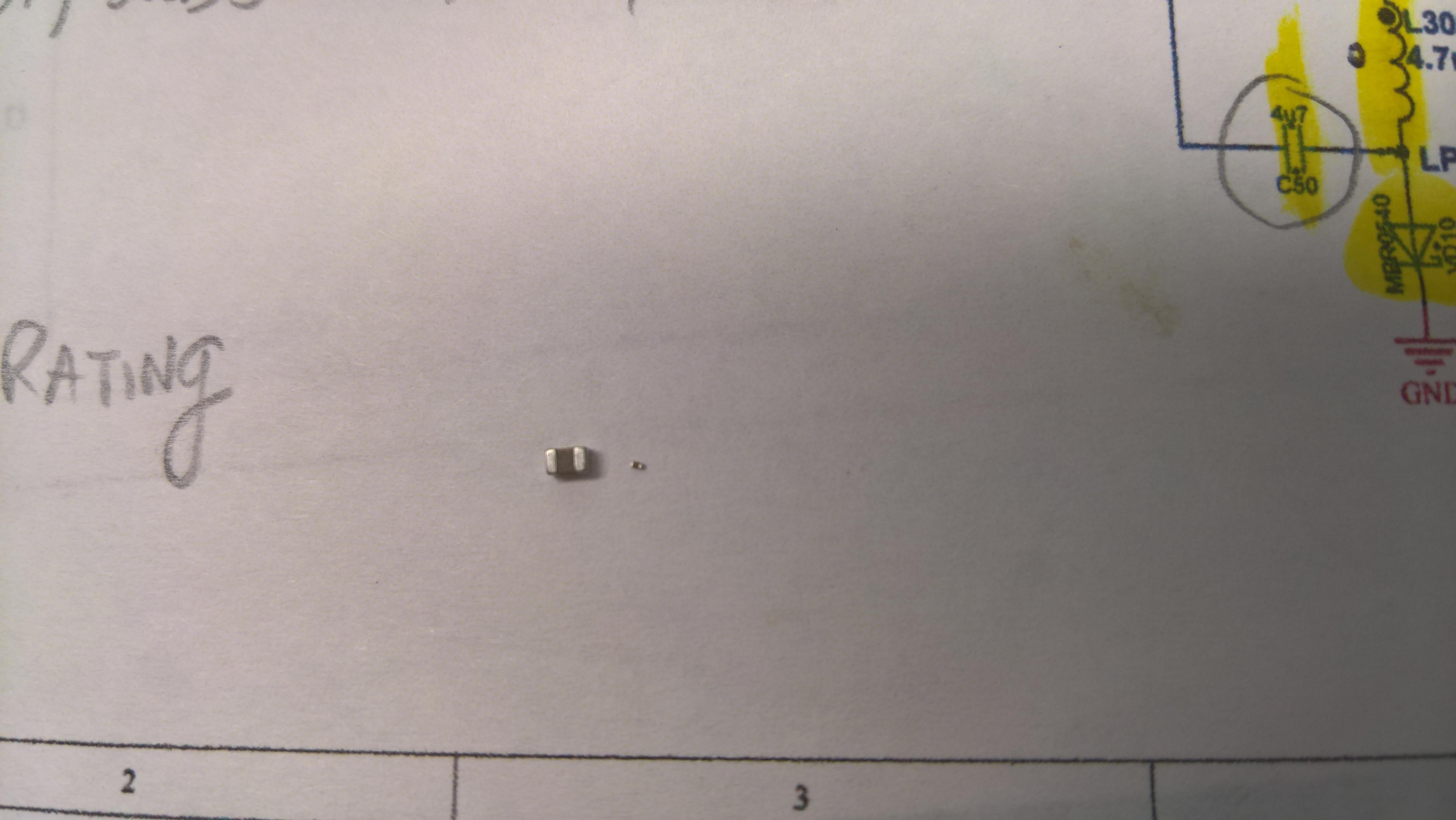

Ok I was just going to put C1 on the pcb, its a 0603 part 100nf (.1uf) part.
AGDR sent me his parts and when I pulled them out of the bag here is what I saw:
The cap is soooo small it makes the 805 4.7uf cap look like a giant!!
There is no way I can tack this one down!! Ha! LOL!
I will order a 805 part....must be a error in the BOM Sergey.
Alex

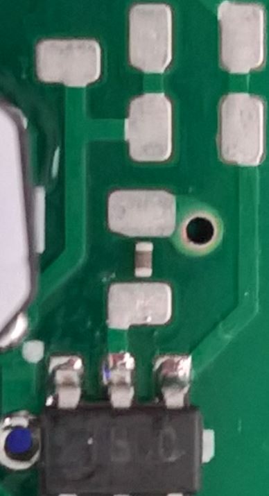

Sergey, this C1 part doesnt even span the 805 pads.....I could bridge it with solder but the part is really too small for the way the pads are layed out...these parts are the size of a pin head...
Here is a pix of the part we have...it may be incorrect in the order??
