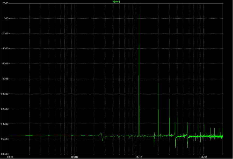

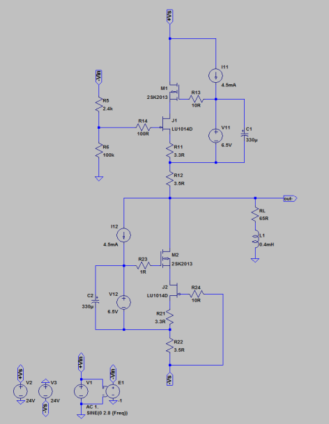

I've been trying to simulate this and not getting good results. With a typical 1khz fft it has a ton of distortion I am sure it is me. Has anyone had any success with LTSpice?

Been thinking about a classic all DHT SET-OPT but it would make much more sense to build a DHT gain stage and use this for the buffer, but I like to run simulation to get a feel for how much power it can deliver into a ~40 ohm headphone. I am also thinking this would give a good bit of 2H & 3H cancelation when driven by a tube "preamp" since it essentially behaves like a triode.
I need the simulation I think because running single ended probably makes most sense if using an SET gain stage so I would have to push the limits a bit for these dam ortho headphones I adore.

We don't realise our Spice models, but I can show you our results, just to prove.
We also use our own simulation tools which allow us to use actual measured data in the calculations.
-90dB for 2Vrms output I consider quite decent for a ZGF circuit driving 65R output.

That is good ! However see that AudioNote just released a headphone amp specifically for the HifiMan HE6. These are the headphones to be striving for design wise. May want to look at increasing supply rails and bias as an option, you want low distortion up to 8Vrms into 40-50 ohms. Just a suggestion.
You mean this Audio Note Kits -HE-6 Headphone Amplifier ?
Isn't it essentially a 9W Class A Tube Amp adapted to drive a 50 ohm load by matching the impedance of the output transformer ? I cannot find any THD spec. But I guess if it can drive a small loudspeaker to 9W Class A, it can also drive a 50ohm load with low enough distortion at 8Vrms, when it is impedance matched. It is perhaps worth noting that it has a output transformer in the signal path (without feedback ?) and without feedback. I don't know transformer enough to use one of those, but I wonder what the open loop distortion of the transformer might be at 8Vrms ?
Of course if you use a low-power F5 (2SK2013 / 2SJ313) to drive a 50ohm headphone, you will also achieve very decent performance, at least very decent THD figures. But a mini power amp is not what I intend to offer here.
The DAO will drive a 30ohm load quite happily, but not to 2W output. However the basic circuit is published. And you are most welcome to experiment with increasing number of devices, bias, voltages, etc.

I didn't mean to compare your elegant design to AN, just to point out that if they are marketing an amp for HE-6's its a bit of a big deal, MHO is the new hard to drive orthos are a game changer in the headphone world so if we could experiment with your buffer design it would be beneficial to you and those of us with orthos.
I like to start from a sim before I build, I'll spend some more time on it and see how feasible it is to get more power but you certainly know more about these power jfets than me

You have only seen 2 parts of the document, and there are 4 more parts to come.
But already you can seen that per JFET, the useful current range is probably not more than 100mA before distortion increases.
So if you want to drive 50 ohm to 8Vrms (although I also cannot understand why you want 2W next to your ears), your current output has to be about 240mA.
That means 3 pairs of FETs in parallel.
Your bandwidth will drop by a factor of 3, because of increased capacitances.
You can increase voltage slightly to say 32V.
The 2SK2013 that cascodes each LU1014 will do OK with that.
Else you can also use 2SK1529 with slightly different component values.
And of course your dissipation will go up to about 76W for two channels.
Then I expect you to get THD below -80dB.
Hope this helps your specific wishes,
Patrick
