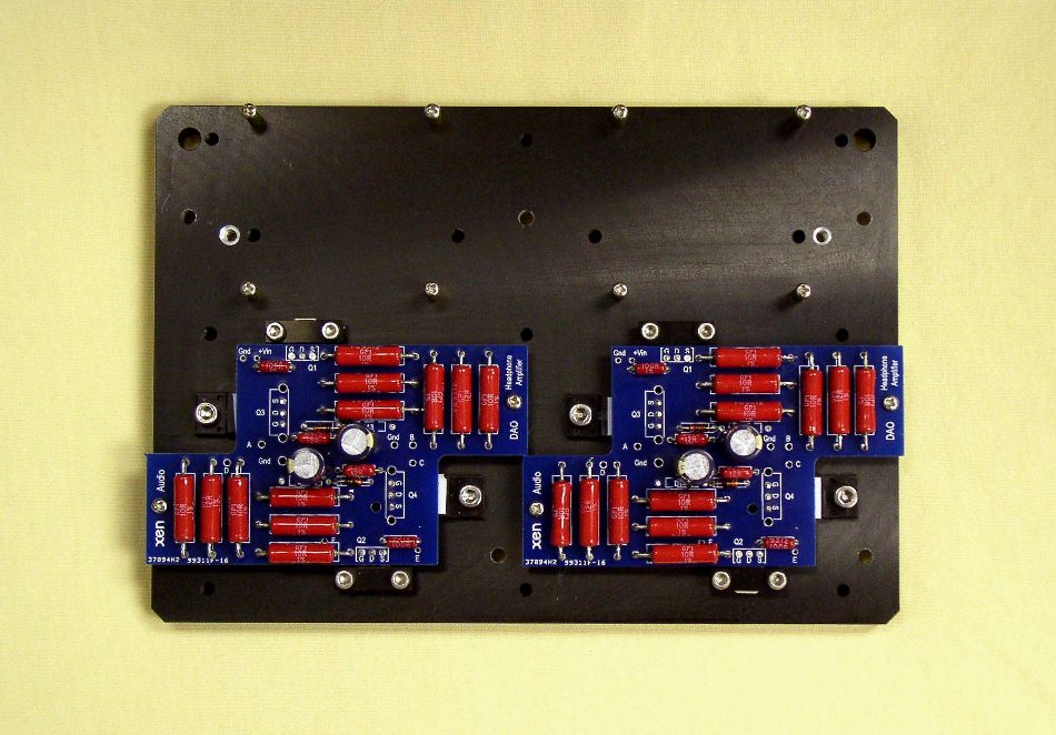

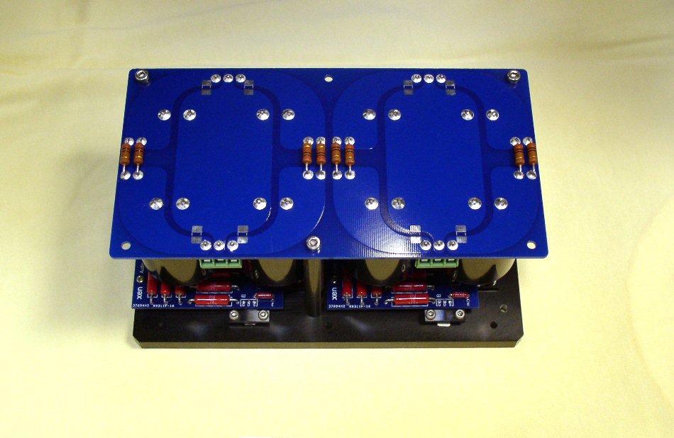

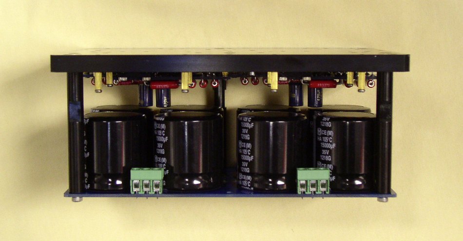

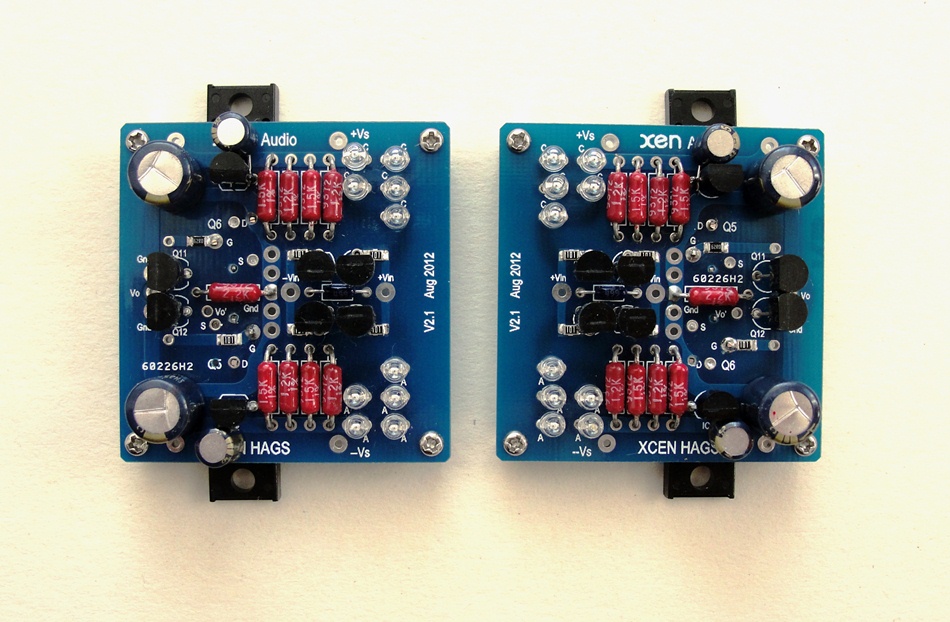

At last some further progress to show. Tests to follow.
Space on top is reserved for the HAGS which is still waiting for PRP resistors as well as FETs matching.
Patrick
Patrick

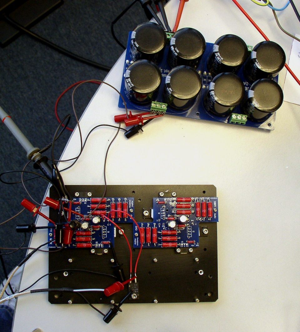

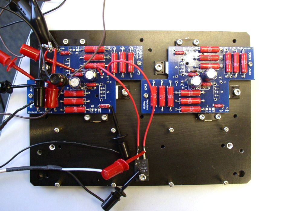

Some test results :
Current configuration is DAO standard, bias 195mA.
10kHz square wave with 56R load is perfect without any overshoot.
Gain is 0.876, in line with expectation (Load = 56R, Zout = 7.8R, of which 6.8R is pure resistive.).
DC offset 4mV.
Also as expected some load is required for stability.
For headphones with high impedance, especially at HF, a Zobel of 27R 10nF will ensure perfect response.
Next steps would be to add TCs and HAGS module.
Patrick

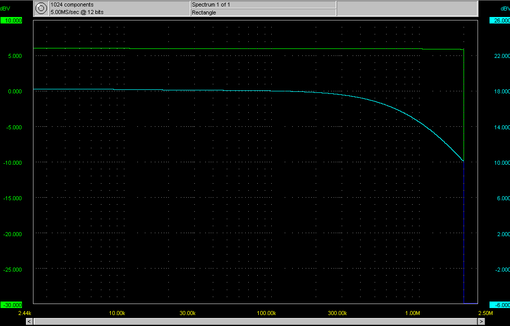

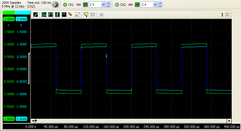

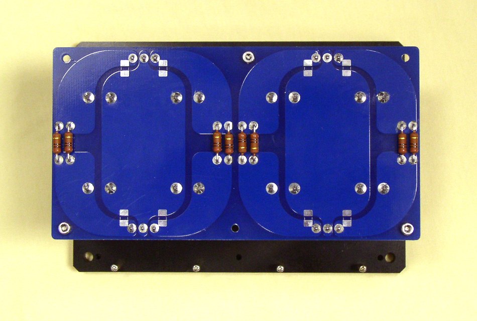

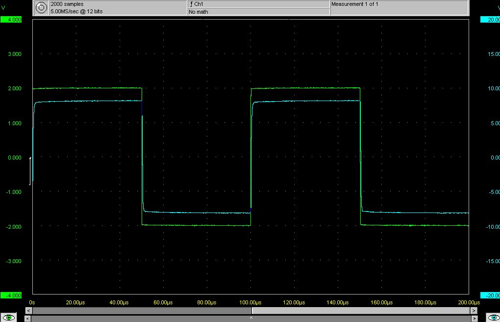

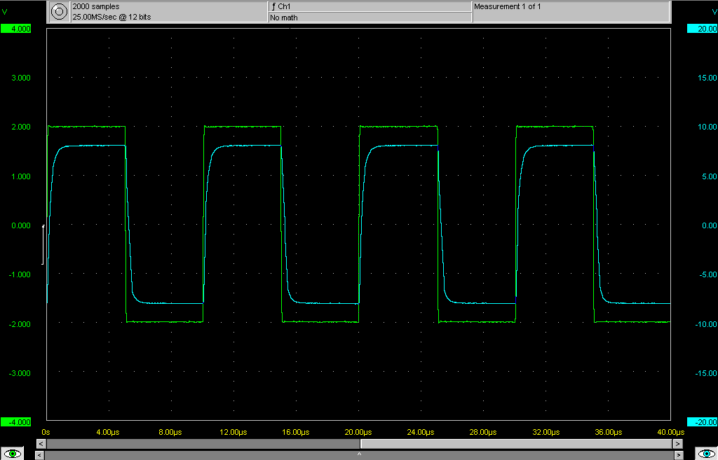

Took a bit longer than I wanted, but HAGS is finally tested.
Without any trimming, initial DC was 160mV.
After one trimming resistor (calculated value), DC was down to less than 4mV at steady state.
Cold start value was about 15mV, but this settles to near zero after 3 minutes.
Bear in mind that the DAO following the HAGS is unity gain, and 10mV is 1.5µW for a 65R headphone, I do not consider servo necessary.
Attached also square wave response for 10kHz and 100kHz, as well as frequency response to 2MHz.
-3dB is at about 1MHz. So performance meets expectation.
(Green is input, cyan output.)
