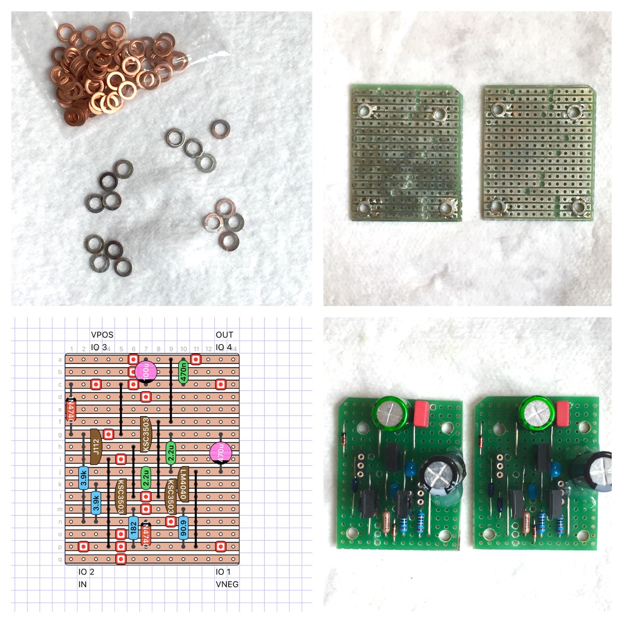

Mtn View tweaks
I posted this a while back to show how I built my own IPS proto boards. The Mtn View was the first platform for my experimentation with the M2x.
I was initially looking for an alternative to the red LED, which seemed to be difficult to obtain outside of N. America. I built my original Mtn View PCBs using the recommended LED, then went off to play a little. First, I substituted a 2.048V voltage source for the LED, and adjusted the current setting resistors accordingly. I allowed more total current supply for the voltage source, and the two current sources that are used for the input and output transistors. With the original J112 still in place, I somewhat preferred the sound of my proto boards to the original PCB build. Once I started playing with substitutes for the J112, I happened to like the Linear Systems 2N4416, and left that in the board.

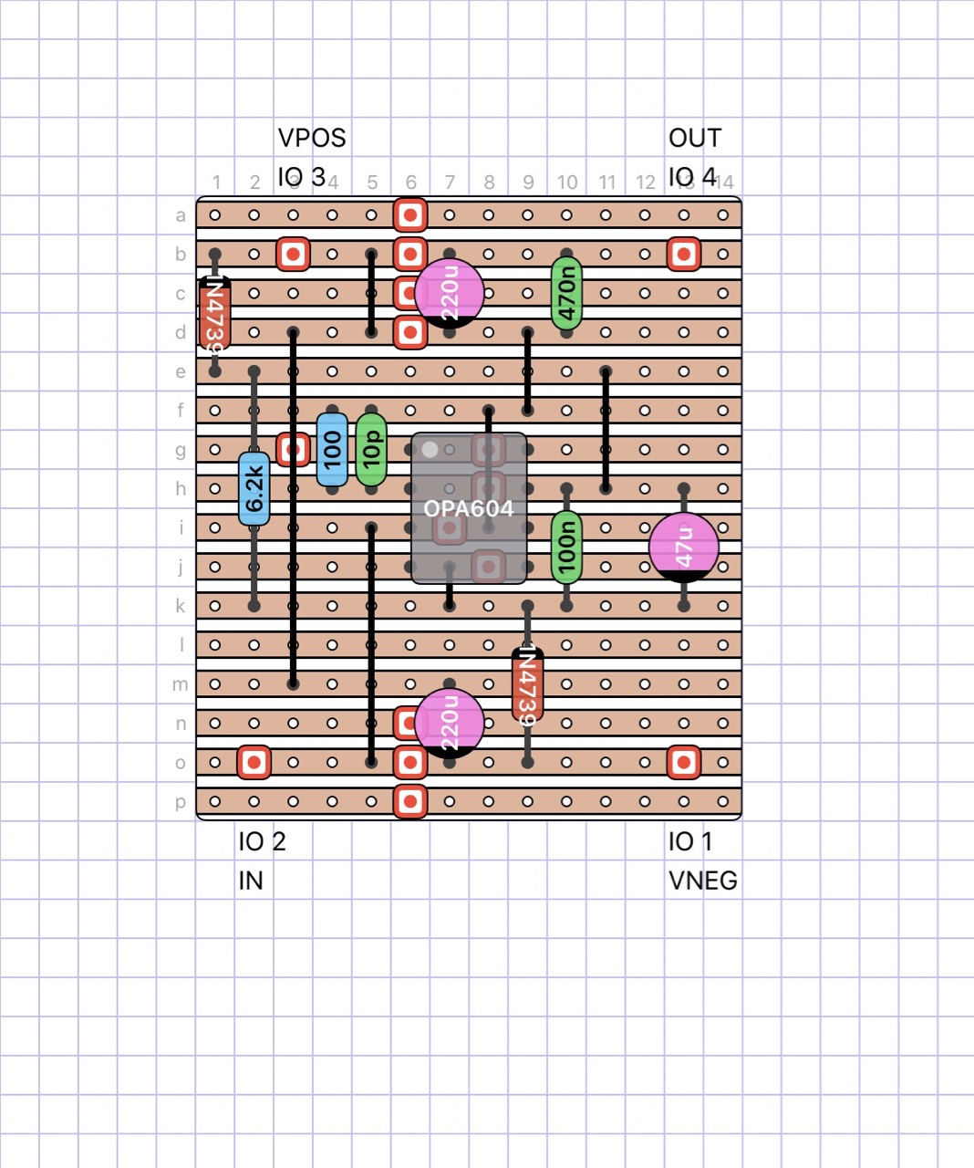

Perhaps other diyAudio members have a few spare Tucson boards they would be willing to trade to you in a fair exchange.
Whether you'll find anyone willing to solder your SMD chips for you, remains to be discovered. _
I picked up a few of these boards - if people are looking, just shoot me a PM. And for those not comfortable with SMD work, I would be happy to use my hot air station and set their opamp in place.

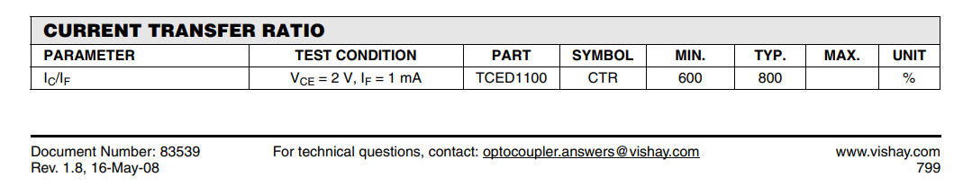

In case there are readers here who haven't yet seen it, I attach Nelson Pass's US Patent on optocoupler bias of audio amplifier output stages. Filed 33 years ago. You may enjoy reading his explanation of his circuitry.
Also, I would point out that even in the narrow domain of thru-hole packaged, phototransistor output, optocouplers ...
there exist models with substantially larger Current Transfer Ratio (Icollector / Iled) than the venerable 4N35 used in the M2. The larger the CTR, the smaller the LED current, thus the smaller the "error term" introduced by siphoning LED current from only one of "N" parallel output transistors. Here is one example, with 3600 parts on the shelf ready to dispatch, at a price of USD 0.79, and 6X higher CTR than the 4N35. If it matters.
_
