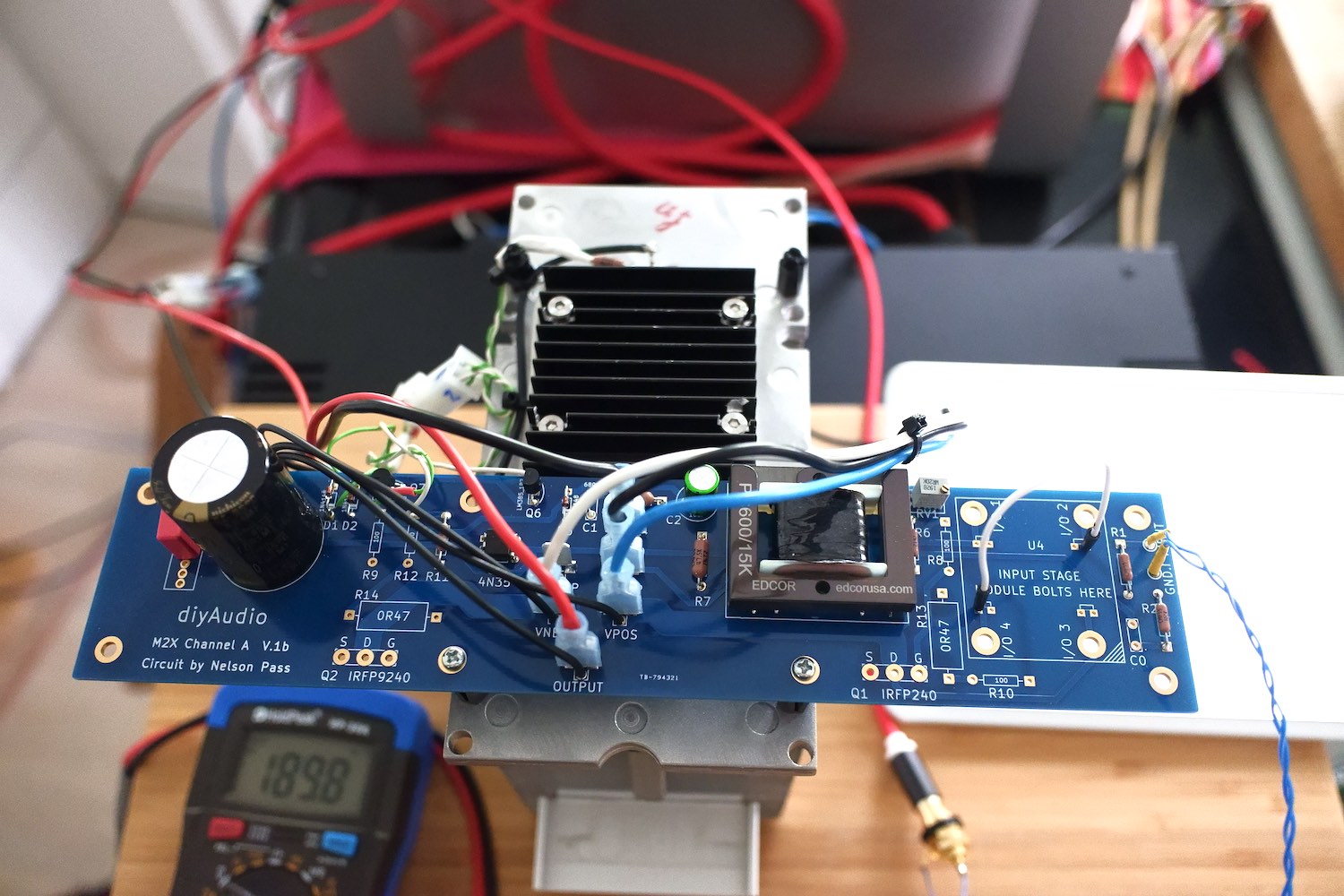

Hi all, I started building my M2X, in a dual-mono configuration, taking my time to try out things and see where I want to take this.
This morning I got the first channel to where it could play some music -- am very happy!
I connected my recent F6 build to the other speaker, in order to compare etc, and I noticed a significant gain difference: the M2X has about -7db less gain than the F6 (estimated by ear).
Do you guys think that is as expected, or do you think there's something wrong in my setup?
At the moment I'm just using a wire instead of the input buffer stage, both for the M2X and for the F6 -- I drive both from my Mesmerize B1DC buffer, and that works very well with the F6.
Please let me know your thoughts -- I had expected the M2X to actually have higher gain than the F6, given the 1:5 auto former!

I wouldn't freak out about that, I have the same thing from one amp to another in the PASS line, not the F6 as I don't have it. Speaker load could have something to do with it as well as the F6 is rated for 10W more into a 4ohm load.
First Watt M2 - 15dB gain
First Watt F6 - 14dB gain
I don't know if the DIYA clones vary from the factory specs for gain.
Someone please correct me if I'm wrong; I'm learning. I didn't think the max rated power output into load would affect the dBSPL all things remaining equal at a "lower" volume. Both amps at the same (let's say 1V) input signal - should be very close. I thought dBSPL was solely dependent on output voltage - assuming there is enough current available at the desired voltage. I can see the F6 having more oomph into a 4 ohm load at higher volumes, but at "testing" levels - that would surprise me.
tl;dr - your observation aligns with expectations...
Potential cause - You also don't have Q1 or Q2 hooked up
I'd start there.

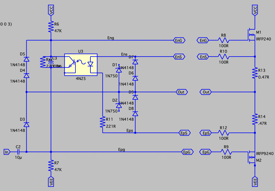

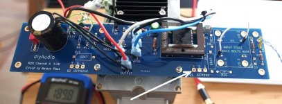

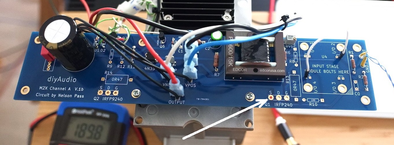

I think I see a red cable jacket through the empty PCB hole where Q1's Source pin will eventually be soldered (?). White arrowhead in attached image.
Does this mean that the circuit board is not connected to any Q1 or Q2, anywhere?
_
sorry, the picture is not so clear:
The whole output stage is done "point-to-point" on the heat sink, and the board provides the input stage and the bias regulator.
I'm going to use an old Mac G5 chassis, and to use the CPU cooler I need to move the MOSFETs off-board. I moved both MOSFETs, as well as R13/14, the gate stoppers R8/9 and also R10/11 off the board and to the heat sink. You can glimpse the negative half in the first picture, the positive half is on the other side of the sink. This way I can accommodate the two MOSFETs on the one sink -- well, I still have to see if this way I can safely remove the 80 Watt or so.
The connection to the board is then only Vcc/Vee/Output (the black wires), and the four lines for gate and "bias sensing" lines (the white/green twisted pairs).
Seems to work and is dead silent.
