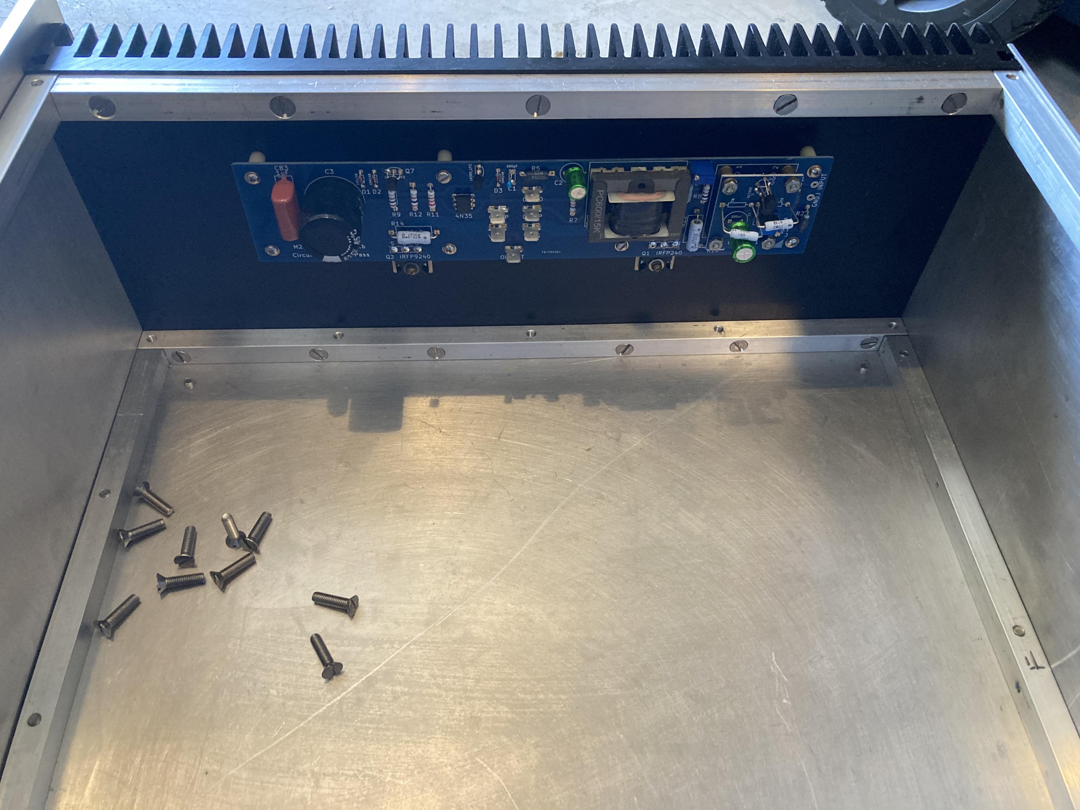

I had some nylon standoff for the mainboard and some brass ones I machined back in the day for the add-on card. Bought the Al ones but did not have M3 screws.

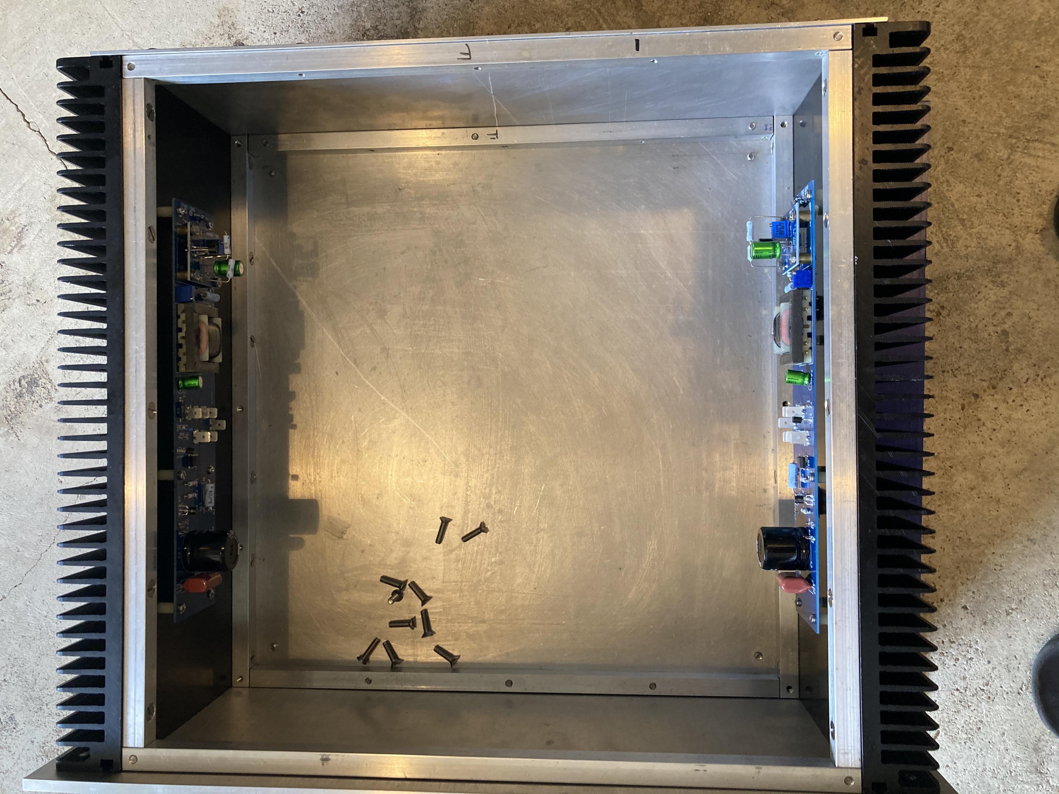

This is an enclosure I made circa 2006 overbuilt to hell. I think it should be able to handle 160W dissipation.

Ain't nobody got time for flimsy enclosures ;-)
I'm feeling a bit of inadequacy when admiring that fine piece of metal.

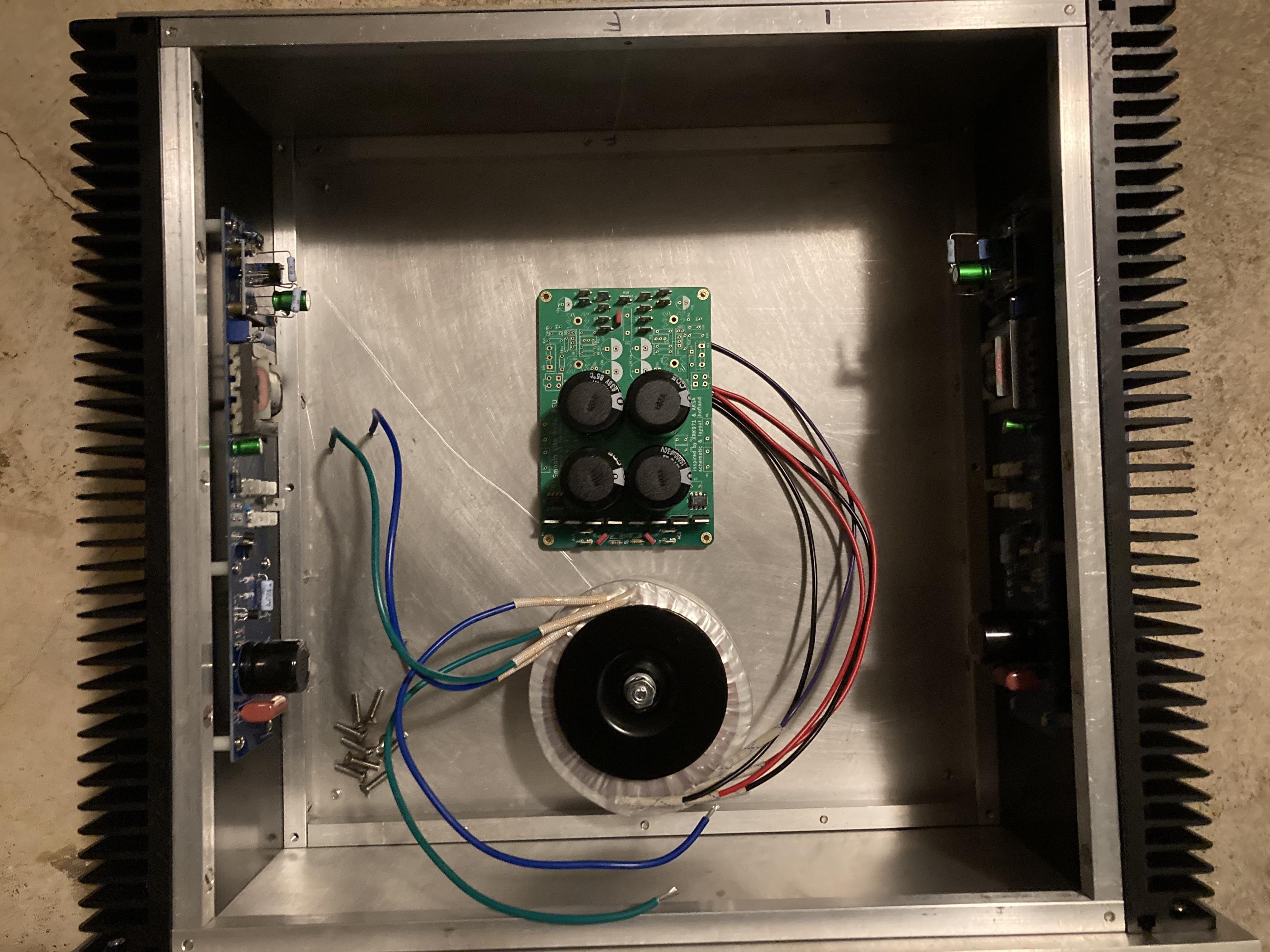

the case maybe wider than it appears. Here is a shot with the trafo and the butta' board.
I went for the mosfet position being centered onto the heatsink for optimal cooling. I can build something arounf the trafo if it needs it.
I am used to transformers outputting more Vs than needed and being undersized in Cu meaning they wind a whole bunch of extra coils so that the voltage settles to the rated V under full load. Historically, I always upsized my transformer chasing that deeper bass...
I decided to not do that this time.
I am using an antec 200VA 18+18 which looks plenty big enough to support the system. We'll see how that goes.

Unfortunately a single Antek AS-2218 will not be sufficient for that build. A pair would work if you were willing to go with a dual mono configuration, without the SLB CapMx boards. Due to the voltage dropout of the capacitance multiplier, you would need transformers with 20V secondary windings to get the preferred voltage on the rails.
We'll see. I don't plan to use the cap multiplier for now. Worse2worst I will get a new trafo but I will make this work.
I have a 3218 sitting on my bench, if ya need it, lemme know.
Thanks for the offer!
3218 is only 300VA and power is not the limiting factor here. IMO anything above 200VA is a complete waste for this amp. If I go with regulator I may need to notch it up to 20 or 22V.
Well, in that case, I have 2x22 sitting on the bench.
