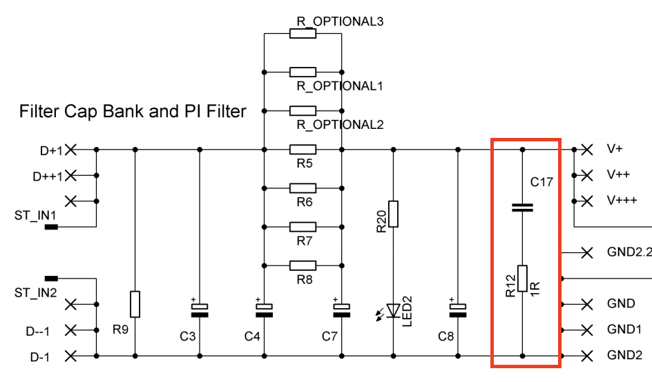

Hi. I also posted that in the PSU guide thread, but nobody comented yet there. Perhaps someone will be nice to give a word here?
I read half of the PSU guide thread to prepare for the PSU build for my M2X, and I think I am ready to make my choices.
Though I have one question about the Inrush Current Limiter (ICL). NP is using just one CL-60 on the 230V supply schematic for that, but the honourable AndrewT was commenting several times that it's not enough, and at least 2 CL-60 should be used in series on 230V live line, but something of 60-80 ohms "cold" resistance would be preferable (2 CL-60 have about 22 ohms).
I found this ICL that I would like to use (75 ohms), but could some experts comment if that is ok, or are there some reasons that I do not know that makes this choice unsuitable for his application.

And another small question: if I want to have 2 blue LEDs on the front pannel, where is the best place to wire them from? I would want to keep PSU LEDs as they are, as I consider them being a safety warnings. As I will not be using the output snubber, could I put the pannel LED resistors in the place of R11, R12 and wire LEDs in place of the capacitors C17, C18? That would look neat, but wouldn't it do any bad to the power supply?
Thanks to everyone who will be kind to comment!

And what about my idea for the front panel LEDs? Is is a good idea to wire them in the place of the output snubber resistor and capasitor (that I will not be using). Or would that spoil the PSU current somehow?
Why is it different from the LED included in the PSU circuit? BOM recommends 4.7-10K resistor. I think if I put it on the PCB instead of the snubbing capacitor it will get the same 24V as the power indicator LED, so it require the same resistor that I can put in the place of the snubbing resitor on the PCB. What don't I understand here, where's my error?
The 4.7k-10k recommendation is based on “normal” LEDs. Almost all LED in the last few years are very, very bright compared to LEDs made over the last few decades. Where an older inexpensive LED needed 2-5mA to light up brightly, a new LED might only need only 100-200uA, particularly when viewed on-axis.
Regardless, try it with what you have, if too bright make the resistor bigger, and vice-versa if too dim.
You can take power right from the VPos output of your PSU boards. You will need a significant resistor inline with the LED. I typically use 150K.
duh - 15K...
OK, 15K makes sense Overall, I think it's not so difficult to estimate the brightness if you have a datasheet of the LED you are going to use. I can do it, no problem.
But in general, I am a total newbie in electronics, so I would be happy if anyone could comment about my idea of wiring place of these front pannel diodes, as I really do not know if it's totaly fine to stick the diode and the resistor anywhere between the V+ or V- rail and the ground (observing the correct polarity, of course, anode getting "more possitive" side).
So, again, as I will not be using the output snubber, I will have a nice places left on the PCB that looks quite "ingenious" for me to be used for these diodes (R12, C17). OK?
