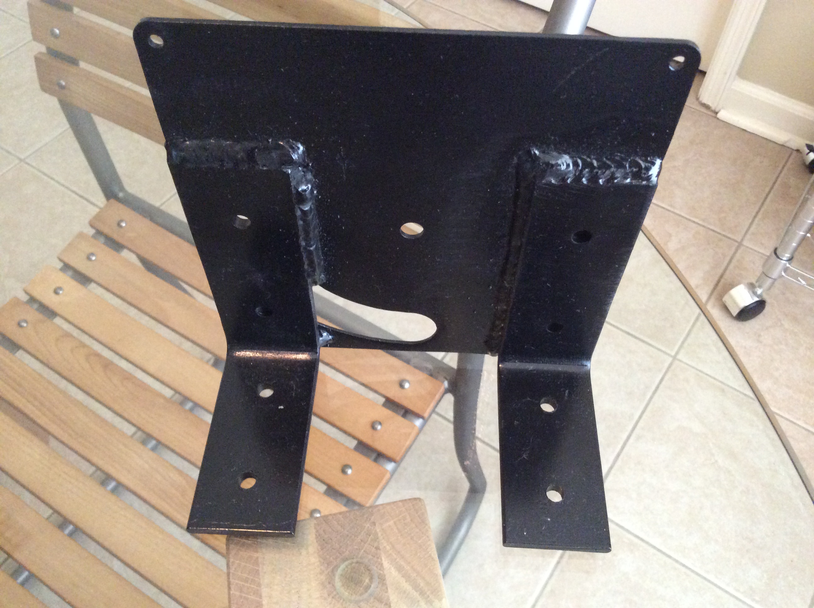

Congratulations! Nice to see another one built. I’ve got almost all of my main board parts, just need to figure out what I’m going to use for the daughter board standoff’s, then get a psu board and other bits at the diystore. What did you use for the toroid bracket?
I had a friend weld some L brackets to the stock Toroidy mounting plate
http://www.diyaudio.com/forums/pass-labs/281520-official-m2-schematic-271.html#post5451789
Very creative!
Very creative!
Here’s the raw pic if ever decide to do it
