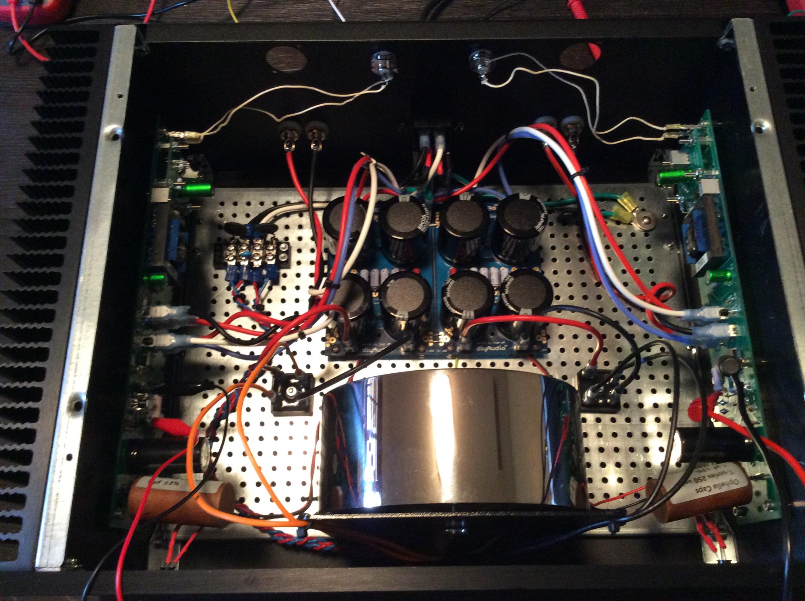

The GF is out of town so I finished the M2x with the Ishikawa front end. Letting it bake a bit, smoking some ribs, watching soccer and drinking beer. I’ll report on how it sounds. Bias at 620 cool?

Congratulations! Try the Mountain View daughter boards too, I think you'll be pleased. Compare to the sound you get from Ishikawa, which do you prefer?
I think I'd twist the pairs of wires together, that run from each RCA input jack to each PCB's input pins. I'd do this to reduce hum, and also to feel good that I did something, I took active steps, toward reducing hum.
M2 uses Nelson Pass's patented autobias; as long as you stuffed and soldered his exact choice of optoisolator and his exact choice of resistor values, you'll get the same bias current he got, and it'll work great. Put the amp on a "Kill A Watt" $20 household wattmeter, it ought to draw 135-160 watts with input signal jacks shorted, if everything's assembled correctly.

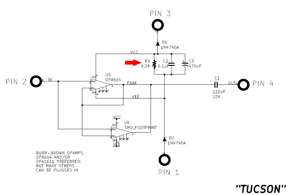

Looking at the Tuscon schematic I am thinking that the 10V zeners reduce the supply voltage by 10V. So if using a standard Pass PSU with 18V transformer the voltage at the op amp should be +/-(23V-10V) = +/-13V.
I am asking because I would like to try Muses03 and/or Sparkos single op amps.
Congratulations! Nice to see another one built. I’ve got almost all of my main board parts, just need to figure out what I’m going to use for the daughter board standoff’s, then get a psu board and other bits at the diystore. What did you use for the toroid bracket?
Whoops, you left out one step: the Antek AN-3218 transformer has dual 18VAC (RMS) secondaries. After converting AC_RMS to DC, and then smoothing out the DC via the CRC filter in the standard First Watt power supply, the final DC voltage applied to the M2x amplifier boards is ±23V DC to ±25V DC. It's some number between ±23 and ±25 depending on which rectifier bridge you picked, and a host of other second-order details.
If you install an X volt zener in series between each supply and an opamp (like the M2x Tucson boards do), then that opamp's power pins will be somewhere between (±23-X) volts, and (±25-X) volts. The official Tucson Bill Of Materials calls for an X=10 volt zener diode {1N4740A}, so the opamp on a Tucson board receives somewhere between ±13 volts and ±15 volts. But nobody can stop you from stuffing and soldering whatever diode you like. Might be a totally different diode with a different Zener voltage.
I could always measure the voltage at the IC socket [of my Tucson board] before inserting op amp.
That is a shrewd observation: yes you could. It works because bias resistor R1 is in the circuit. Even when the opamp is removed from its socket, R1 guarantees there are a few mA of bias current flowing in both zener diodes, and so the voltages at the opamp power pins, nodes "VCC" and "VEE", will be their correct and final values (plus or minus a wee little ooch).
