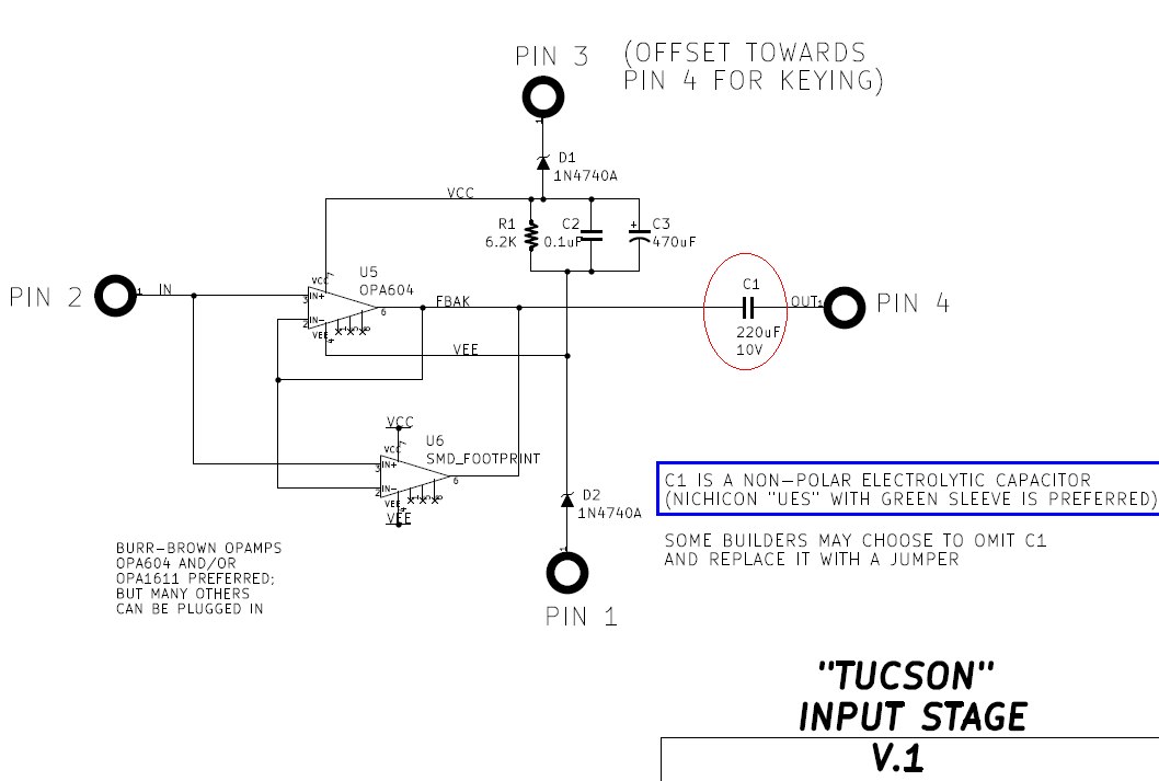

Tucson board polar capacitor for C1?
Hello, and thanks for these amazing boards.
I already have some Nichicon 220uF polar capacitors that I would like to use for C1.
Would the square on the board still represent positive? Would seem consistent with the other marking, but somehow seems backwards. I know non polar is recommended, but is there a problem with polar (other than not knowing which way to install it)?
The last time somebody asked this question, 6L6 suggested that if the UES greensleeve capacitors were not an option, these bipolar capacitors from Panasonic (Mouser link) would be a suitable replacement. The Tucson daughterboard uses bipolar electrolytic capacitors because the offset voltage could be either positive or negative; there's no way to predict. Fortunately, bipolar caps don't care, they work equally well either way.
I recommend reading pages 5 and 6 from the Electrolytic Capacitor Application guide published by Cornell Dubilier link to pdf, especially the part about reverse bias voltage leading to the production of hydrogen gas. That's what you really, really want to avoid.
I've attached a .csv formatted "spreadsheet" from Digikey, showing the 220uF bipolar electrolytic capacitors they have in stock. Maybe one or more of them is available from your favorite distributor, whether that be DigiKey or Mouser or Arrow or Newark or whoever.

...The Tucson daughterboard uses bipolar electrolytic capacitors because the offset voltage could be either positive or negative; there's no way to predict...
There are two capacitors in the signal path already, adding a third won't make a lot of differance; ac couple the MX2 input, add an asymetric potential divider across the Tuscon psu, tap off the centre with 1M and connect to the input of the OPA604.
You now have a guaranteed offset and can use a polerised cap instead.
Or you could use the old trick, two polar caps connectec in series (-++- or +--+), connect the centre to the apropriate supply rail via a high value resistor; the caviat is Ct=1/(1/C1+1/C2)

Hmm, 3 new resistors and 1 new capacitor, bodged onto a little 35 x 40mm PCB? Much scraping off soldermask and non-thru-hole soldering will occur. (times two amp channels). The end result might require new, longer bolts which affix daughterboard to motherboard. You may need to increase the daughter's spacing above the mother board, allowing extra height for new bodge components on the bottom side of the daughterboard. Be certain to buy some additional threaded spacers on your next parts order. (a good time to buy bipolar caps too?)
If you become nervous that your across-the-supplies bias network might ruin the PSRR of the input stage, since it injects power supply noise straight onto the amplifier input (attenuated by 100K/1.1Meg), please recall: The Tucson daughter card has only four I/O terminals: PosSupply, NegSupply, In, and Out. None of them are Ground. Ain't no place to connect the second terminal of a filter capacitor. If you connect it to NegSupply you get direct injection of supply noise onto the bias node, which I don't think is your primary objective.
Three ring tags, three 'in air' resistors mounted top side, C1 replacement on long legs, only two solder joints to redo when the specified cap is installed, (the third cap could be left permanantatly at the input P1) not really much of a challange, and it was only ment to be temporary.
The main point was 'We are FAB', don't let a mear thing like the lack of the exact component stop you, there are ways and means... obviously there are limmits :smash:

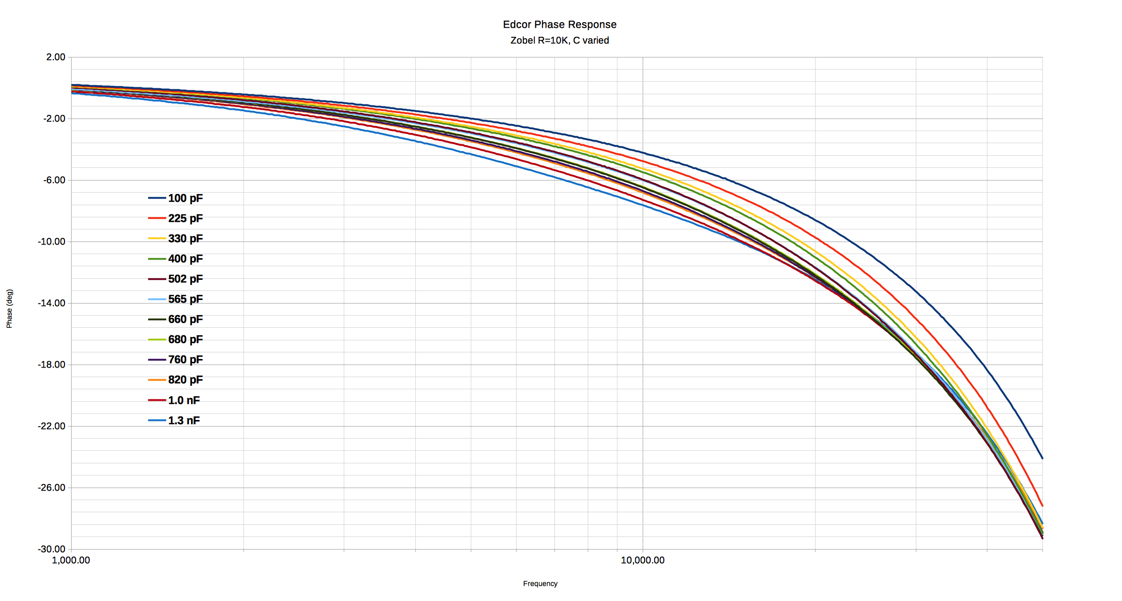

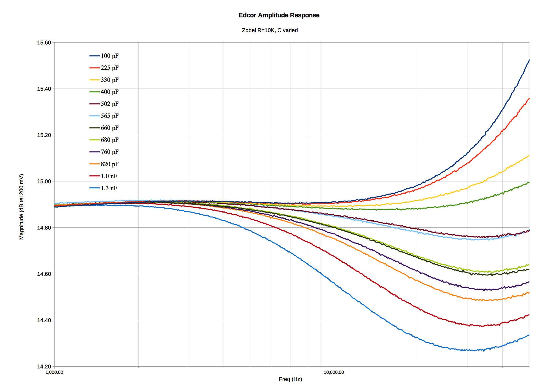

A bit more data on the Edcor Zobel. The measurement set-up is shown in post #716. I used Edcor transformer #3. R5 is kept at 10K, C1 is varied from 100pF to 1300pF, values shown as measured. The first plot is freq response from 1kHz - 50kHz, the second is the Bode phase plot. I haven't tried and of these values in a completed amplifier. I think measuring square wave response as Mark discusses in post #717 and shown in Whitlock's publication are my next step.

I think I prefer (10K series 502pF) but ... will wait to see whether the frequency response is more sensitive or less sensitive to changes in the resistor value, than changes in the capacitor value. Will also wait to see whether the transient response (output damping with unit step input) has a different sweet spot than frequency response. If so then a compromise may be called for.
