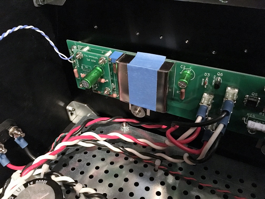

Hi Claas,
Thank you also for the info. For the belly band, is that some kind of copper foil tape?
Would you have a reference/part for that?
Thanks,
Dennis
Ebay, copper foil tape | eBay
Yes, that should work well.
I used 3M type 1181 copper foil tape. Important is the conductive adhesive. Most of the tapes in the link above feature that.
Even better would be 3M type 1345, especially made for this purpose.
(sample link: https://www.ebay.com/itm/TapeCase-3...960165&hash=item54463fd62a:g:HewAAOSwIWVY88UN )
... but that felt too expensive for me
Best regards,
Claas

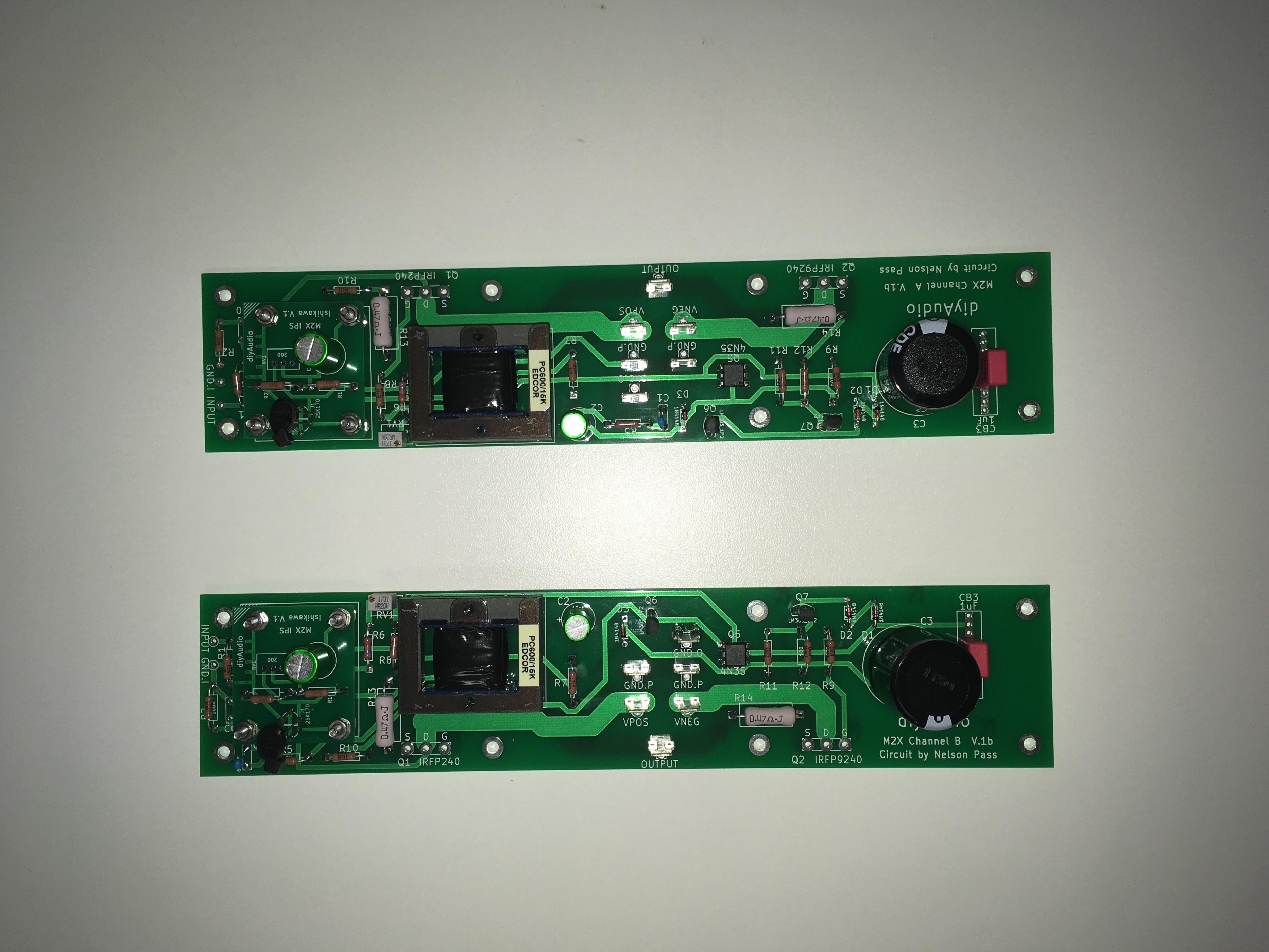

My parts for the M2X are starting to show up
I got my M2X PCB boards yesterday, and all the necessary transistors to build the amplifier main boards and the Ishikawa input stage today. I already had the Universal PSU PCB boards and a set of soft start/speaker protection boards on hand (I ordered the soft start/speaker protection boards a couples month ago to use for an Aleph J build, but this thread convinced me to try the M2X instead).
I will create an order for all of the parts to populate the amplifier and power supply boards, but can't afford to place the order until the end of the month. I will be placing an order for those Edcor autoformers then too.
As this is my first full DIY project (I have modified a few things in the past), I am taking my time, and ensuring I have everything on hand before I actually start building. This will also give me time to see what others here are choosing for their input stages, and how things are working out.
Someone mentioned having extras of those red "do not substitute" LED's on this thread. I have forgotten who that was, but if they can contact me, I will gladly buy a set at the end of the month (PM me with PayPal information).

Where can one get the cover for edcor trafo?

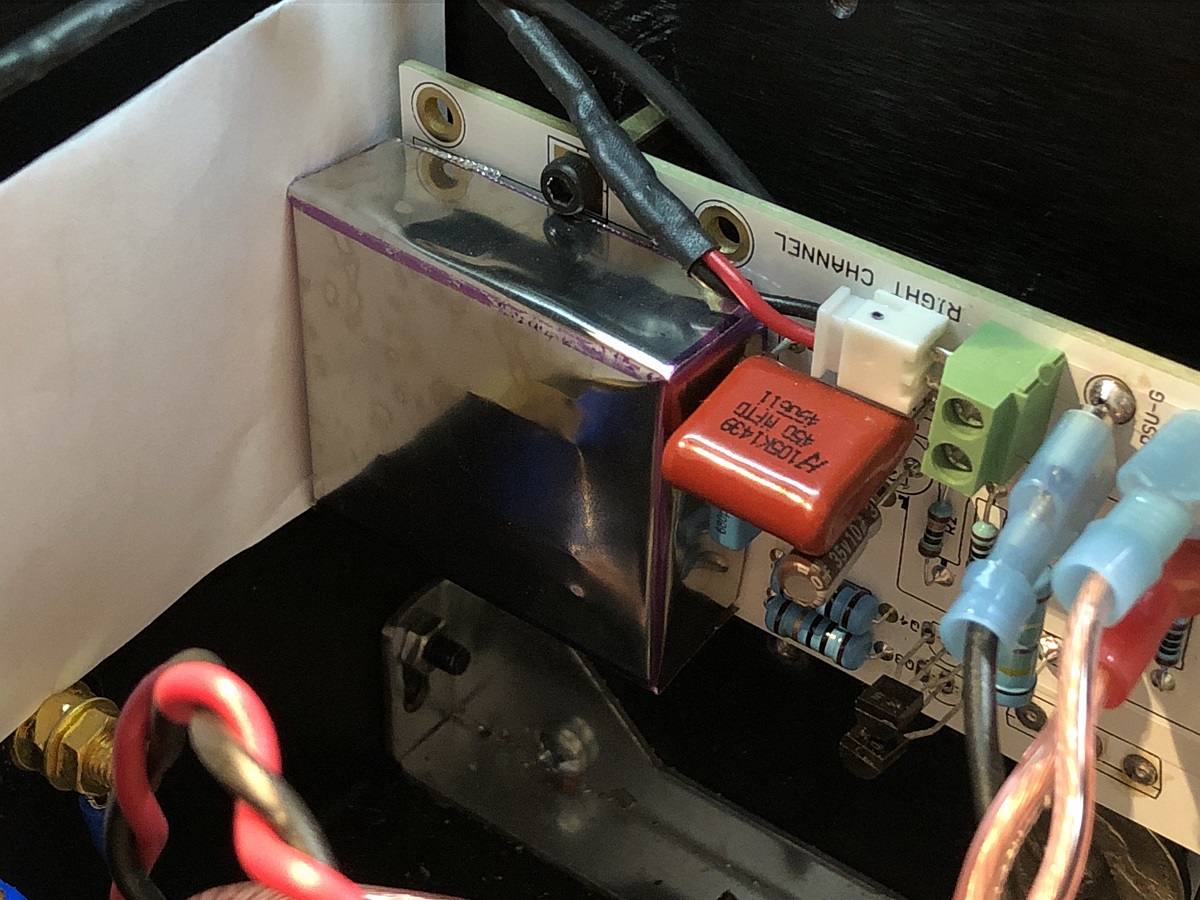

You can fold your own from mu-metal.
https://www.diyaudio.com/forums/pass-labs/281520-official-m2-schematic-311.html#post5569239
This reduced the noise down to 0.1mV on one channel and 0.3mV on the other.
Where do you get "cheap" mu-metal?
It may also be possible to use mu-metal tape. I know this company sell it (but expensive). But tape may be easier to "apply":
3200 to 4700 - EMI shielding tape | Holland Shielding Systems BV
May also be possible to find it on ebay.

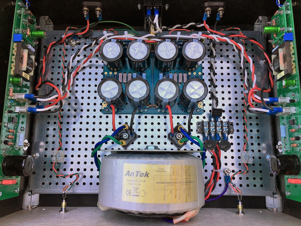

I don't think that there is any "cheap" Mu-Metal. I paid $122 for a 2' x 4" x 0.01" piece of Mu-Metal foil from McMaster Carr.
Before the Mu-Metal shielding, I was seeing noise levels of around the 500 uV, which is the First Watt specification for the production version. After shielding, I measure around 100 uV (0.1 mV), which is quite an improvement and the limit of my test equipment.
I'm sure there will be more feedback for builders regarding shielding techniques as more people build the M2x.
One more thing: To reduce hum, try to separate the power transformer from the input transformer as far as possible. A deeper case than I used would be better to maximize the distance.
Nice neat build! Where did you get the mounting bracket for the toroid? Or is it a DIY homemade bracket? If so, what metal did you use?
Thanks!
Thanks!
Bracket is an L-300 from Toroid Corporation. The L-300 is a good fit for the AnTek AS-3218. I have also used the L-625 L-bracket which is a good fit for the Antek AS-4218.
VERTICAL MOUNTING BRACKET FOR TOROIDAL TRANSFORMERS
Thank you, WKCox! Here are the sales pages for those mounting brackets:
Thanks WKCox! I’ve sent them an email for pricing.
