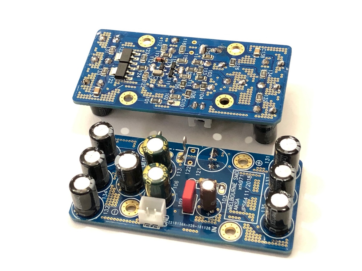

Progress on verifying the Melbourne SMT version.
722236d1544888253-melbourne-class-headphone-amp-pre-amp-melbourne-smt-v1-build-02-jpg

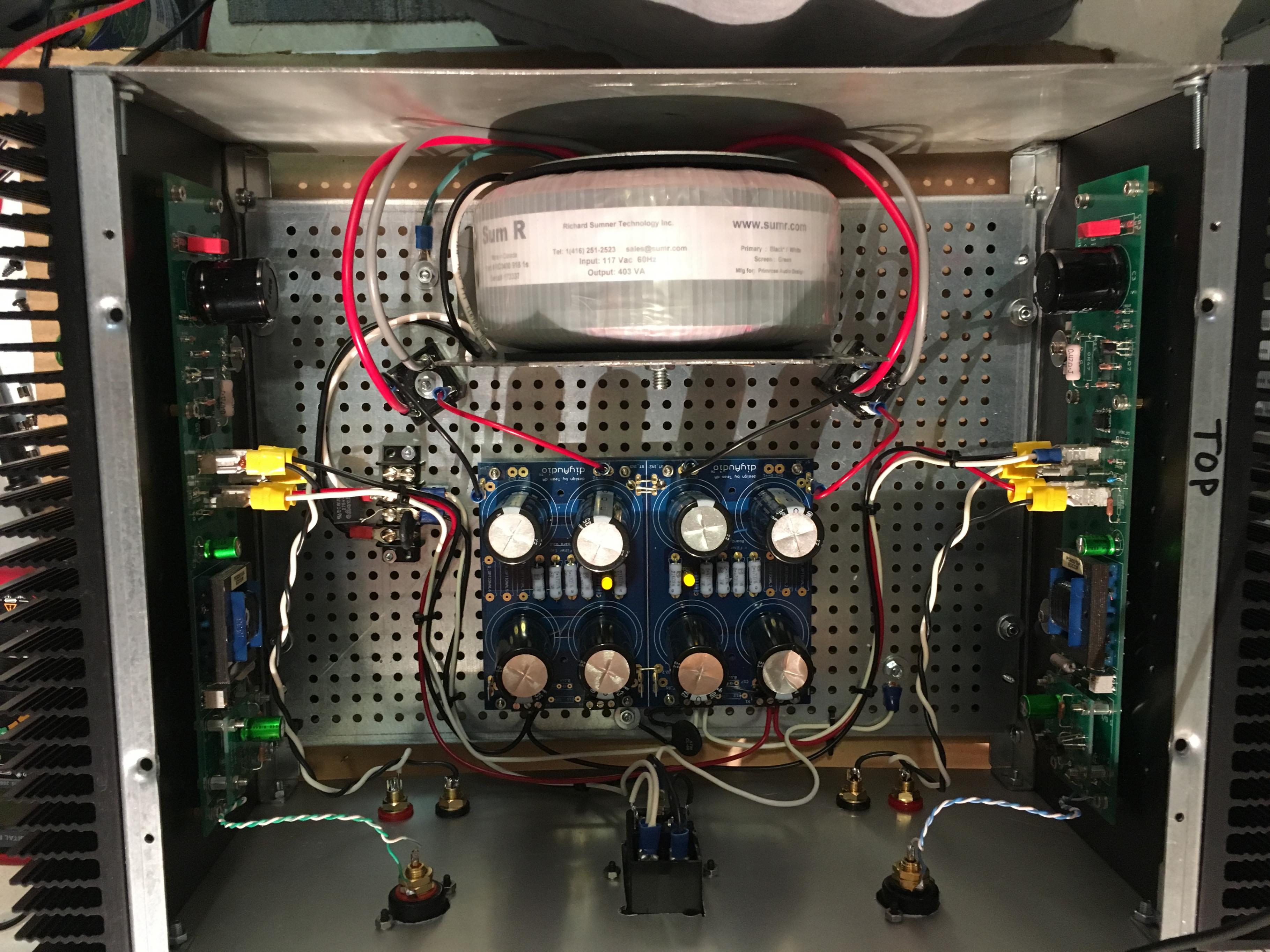

This is my first power amp build and with all the help and guidance here it has been a very pleasurable build, my main concerns are the power supply. I bought a 240V transformer to make life a little easier, I have a couple of bridge rectifer blocks and I bought the v3 psu pcb and am using the filter from that. It should all go to plan, I recently ordered some of the risers for the 4u deluxe case I was thinking of mounting the filter on those. Is the best place to mount the TXFMR at the front? I was thinking of placing it where it balances the weight of the front panel to make lifting easier for balance.
So many questions, sorry.
Joined 2016
Hi Batty, I believe it has been mentioned in a few places on this thread as well as the M2 build thread that the transformer should go at the front as far away from the Edcor transformers as possible to eliminate any electrical interference that may result in a hum on the input of the amp. Some others, including myself have had great success mounting the transformer vertically with the mains and secondary wires facing the front of the case. My M2 is very very quiet with zero buzz coming through the speakers, and it’s a 300mm depth 4u case. Hope this helps, have fun with your build, the M2 sounds great!
