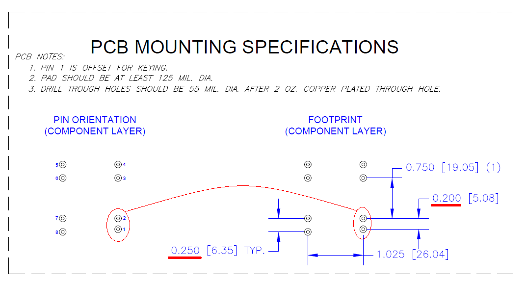

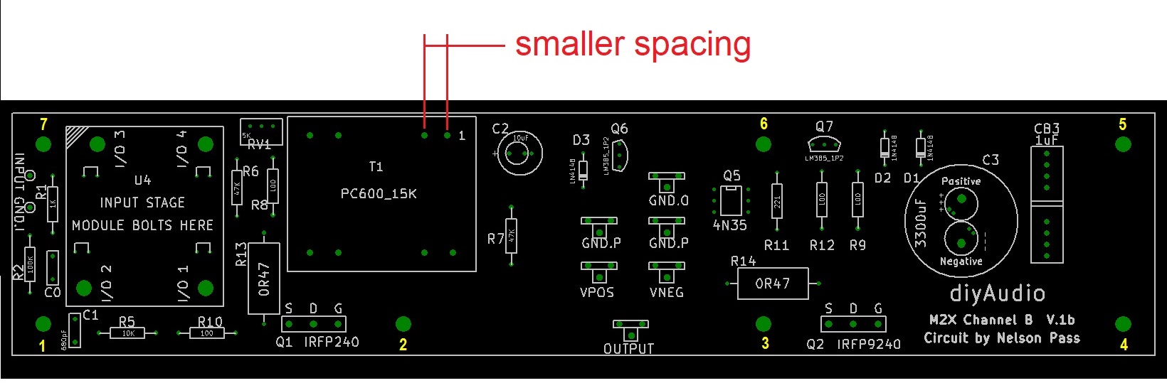

How do I mount the Edcor trafos on the PCB boards, is there any specific orientation? I see that there is nothing mentioned like '1' on the transformer but I see that listed on the PCB board.
It only fits one way.

It fits both ways as I tried and I think you are talking about the daughter boards when you say fits only one way. Thats true with the small daughter (input stage) boards but not with Edcor transformer. Pin spacing is exact and hence fits both ways. I saw a comment somewhere in the thread that try and see which side it fits and go for it but was not sure.

Be more careful, do not force the leads, something may break.It fits both ways as I tried ...

It only fits one way. If you got it to fit the wrong way, then you forced it.

Correct.
Edcor has downloadable mechanical drawings on their website. Here is a .pdf LINK

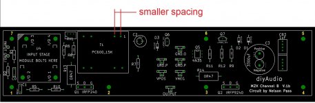

The relevant portion is shown below. Notice how pins 1 and 2 are spaced closer together, than any other pair of adjacent pins. The M2x PCBoards match this asymmetrical pin arrangement.
