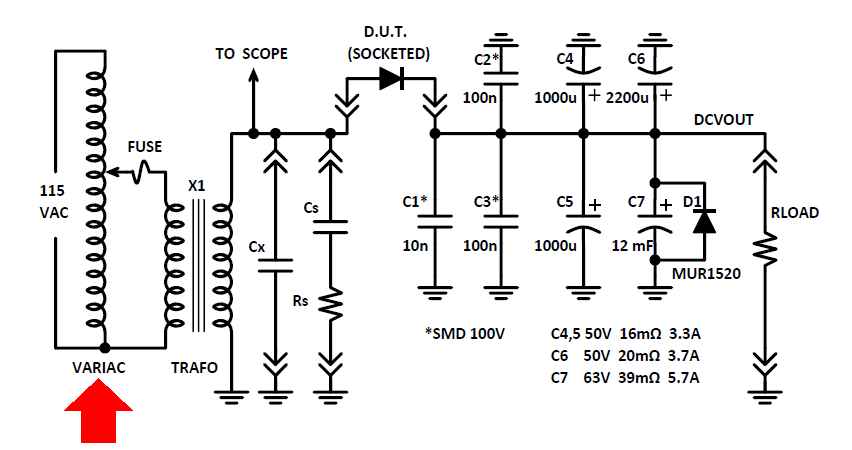

A variac was an essential, integral component of my Soft Recovery Diode test jig, for the article in Linear Audio magazine.
I bought mine from a local store, but Amazon sells the very same unit: (sales link)

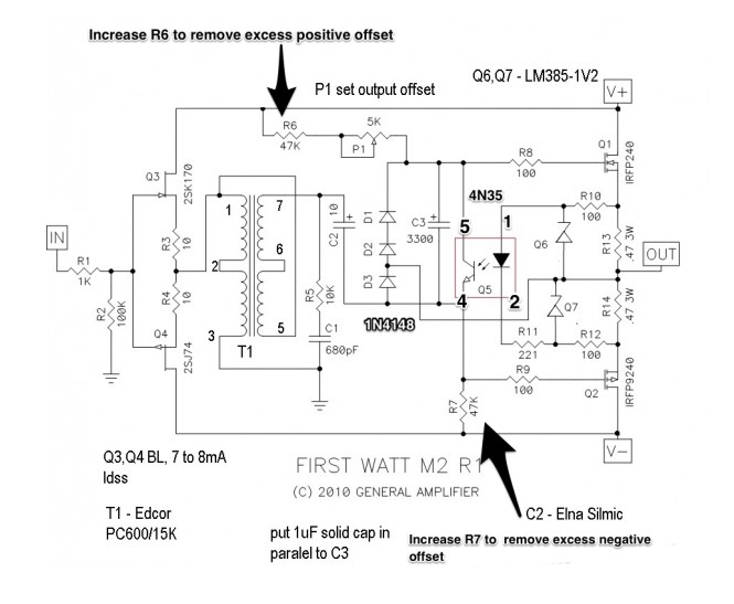

First a GREAT BIG THANK YOU to all the support and help - I completed the M2 which is now playing music! YEAH. There is one item of note though. One of the channel bias was zeroed without problem. The other has RV1 turned all the way down to 0 and the reading on the DDM goes no lower than 13 mV. Is this acceptable? Is this where I should consider the 3. WARNING: BLASPHEMOUS HERESY! DO NOT READ THIS! from post #3? If so, should I do it to both channels to be consistent or just the one without ability to reach zero?
My M2 sits at about 20mV or so. If you REALLY want to get it to zero (which is difficult- adding or removing the lid changes things) here is a diagram that someone posted a while ago. As Zen said, this adjustment won't make any practical difference at your levels of offset.
