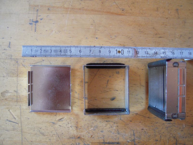

Shielding case for EDCOR.
Greets Dirk

So you build your own little metal box shield.
It seems Edcor shields some of their transformers using a thin copper shield like this:
EDCOR - MXLcs Series
It looks like tape. I wonder if it is "enough" just to apply the tape like on the picture and not cover the whole transformer. It would be easy to do. Mu-metal tape is a bit expensive but does not need much…..just a small sheet.
If the shield is for not picking up noise it is probably enough just to cover the windings.
I just read the 6moons review of M2. He had the top off the amplifier:
6moons audio reviews: FirstWatt M2
Was the shields on the Edcor's "handmade" or something the factory makes? ….is it mu-metal or "just" steel?
Pass uses mu-metal. I believe Nelson posted earlier in this thread. I tried steel but that didn’t work well, so I purchased some mu-metal foil. Expensive but effective.
I will get a small sheet of mu-metal tape. It would be most easy just to cover the windings with tape. One piece of 17mm all the way round like they do at the Edcor factory (where they use copper...if must be for RF shielding not magnetic).
I know that the steel used for magnetic shielding has a special grain structure. They write a bit about it at Don-audio as they sell shielding for e.g. toroid transformers.
EDCOR shielding
MU-metal, selfadhesive shield sounds very good to me (yes, expensive).
I did not want to cut those cases into 2 halves, make them smaller and soldering/welding back together. A lot of work.
And then the metal case was very close to the pins / contacts of the EDCOR.
Because of this I tried the rubber-welting.
Greets Dirk

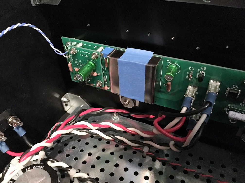

I bought a 2' x 4" x 0.01" piece of non-adhesive Mu-Metal foil from McMaster Carr.
Before the Mu-Metal shielding, I was seeing noise levels of around the 500 - 600 uV, which is close to the First Watt specification for the production version. After shielding, I measure around 250 - 300 uV (0.25 - 0.3 mV), which is quite an improvement and the limit of my test equipment.
Multiple layers of 0.01" Mu-Metal showed no additional improvement. Note that I used a 5-sided cover with no shielding between the transformer and the PC board.
