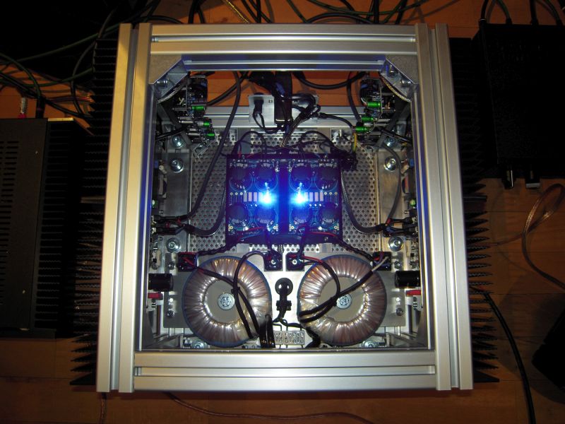

I built my case for the M2X with the 5U heatsinks
this means 4 heatsinks
200 mm x 210 mm x 40 mm (fins)
each heatsink gives you 0,28 C/W
After 1 hour of listening in a room with 24 C (temp.) I measure around 45 -
52 C at the outside of the heatsinks (between the fins where the MosFet is
mounted).
Only some experiences from me. But I think the 4 U heatsinks should work.
And if you build monoblocks you put 1 M2X pcb into 1 case - so you need the
heatsinks only on one side of the case.
PSU case doesn't need heatsinks. But for sure : 4 cases = more cases =
more costs....
Greets
Dirk

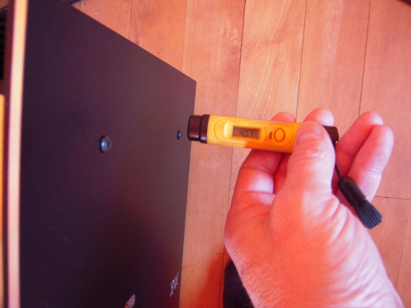

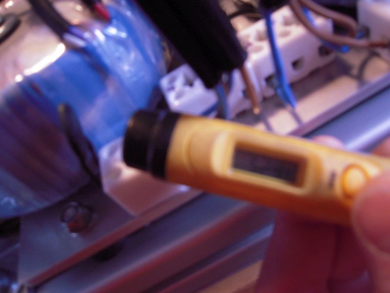

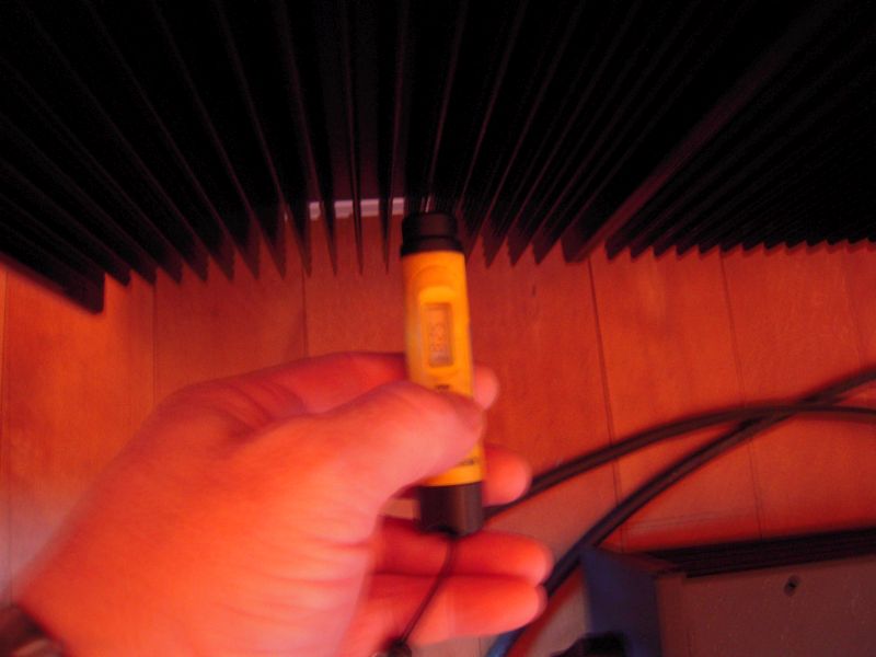

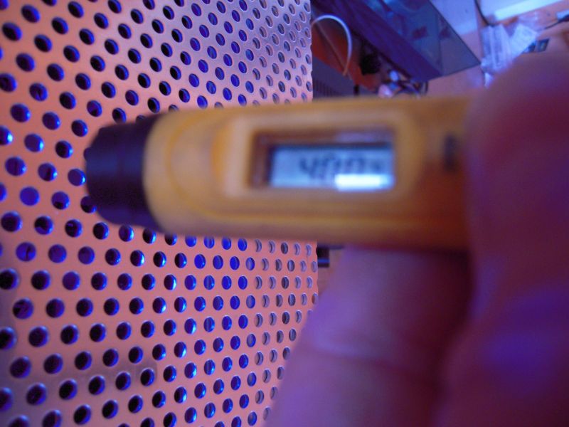

M2X temperatures
Some temperature measurements at my M2X (after 1 hour running):
heatsink temp. between fins (where MosFet is inside): 52 C
temp. topcover of case: 40 C
temp. frontpanel: 40.7 C
temp. of the CL60: 52.4 C
So, this baby is![hot :hot: :hot:](https://files.diyaudio.com/forums/images/smilies/hot.gif)
