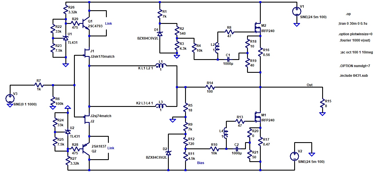

@ColinA123: link to the PCF mod?
@2 picoDumbs:
- trimpots type (standard?) and value?
- cascode option sketch, please use my PDF schematics (transistor type, values and so on)

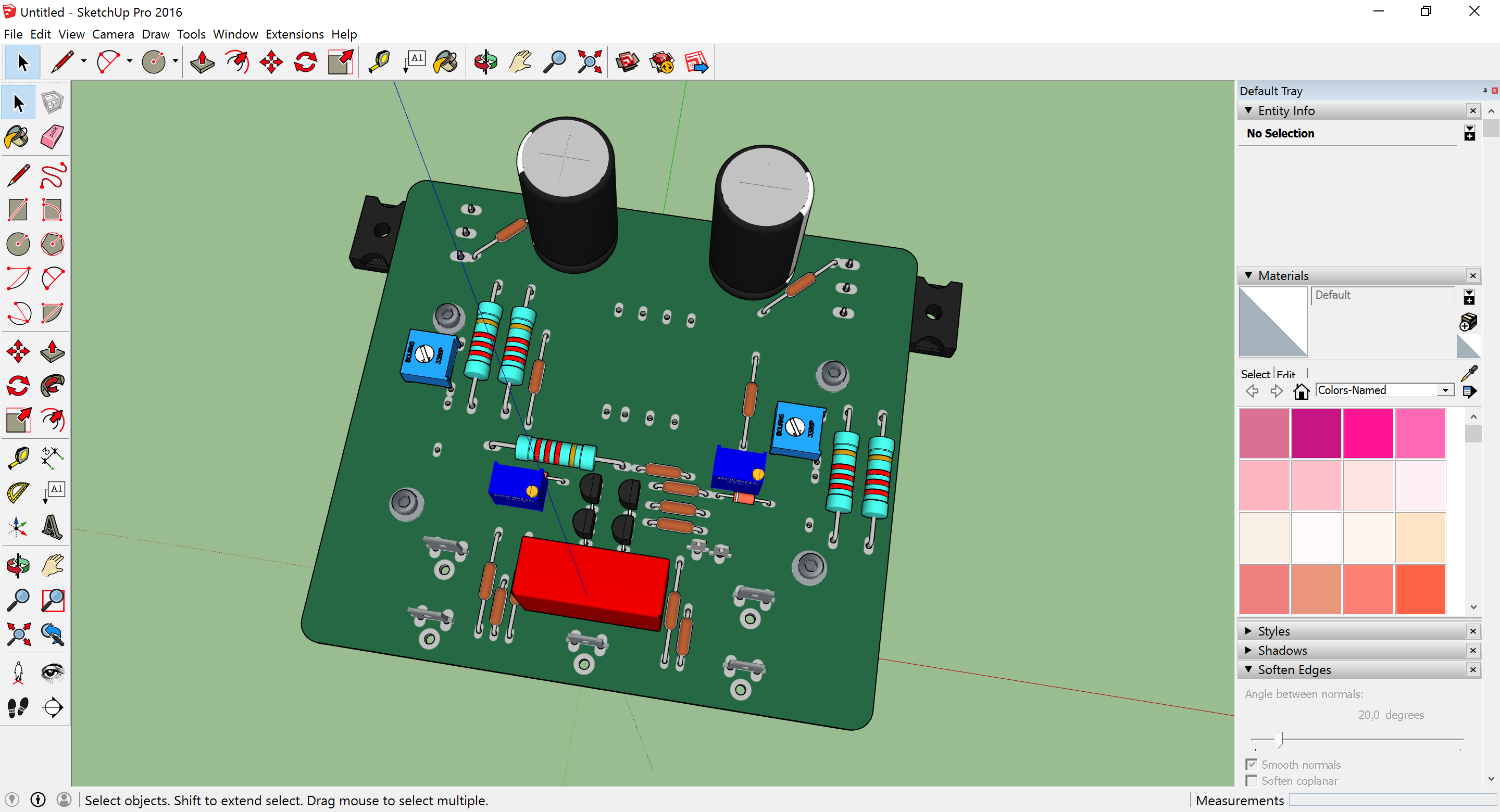

Thinking about transformer daughter board, but not very happy about "Eier liegende Vollmich Sau", but only idiots never change mind!
I´ve found provider for custom Mu-Metal shielding, will request quotation for Jensen shielding can.
Mounting holes in the middle of UMS definition revision 2.0 don´t exists: would be nice, so revision 3.0?
First placement without improvement ready, will post soon...
JP

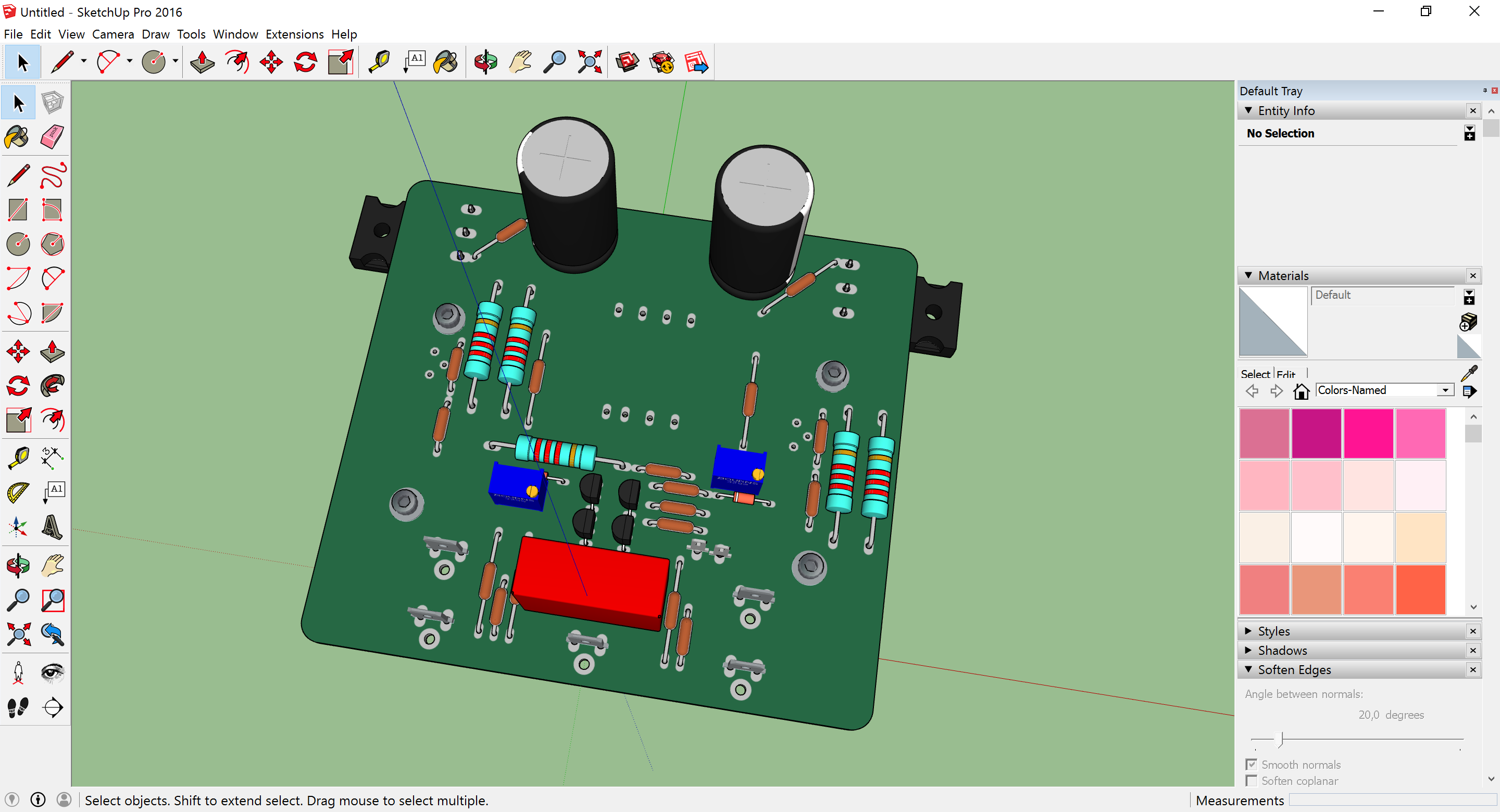

First placement.
JP
JP
Not sure exactly what you mean by middle, but many amp chassis are made using split heat sinks, so having mounting holes in middle won't work for quite a few people (me included).

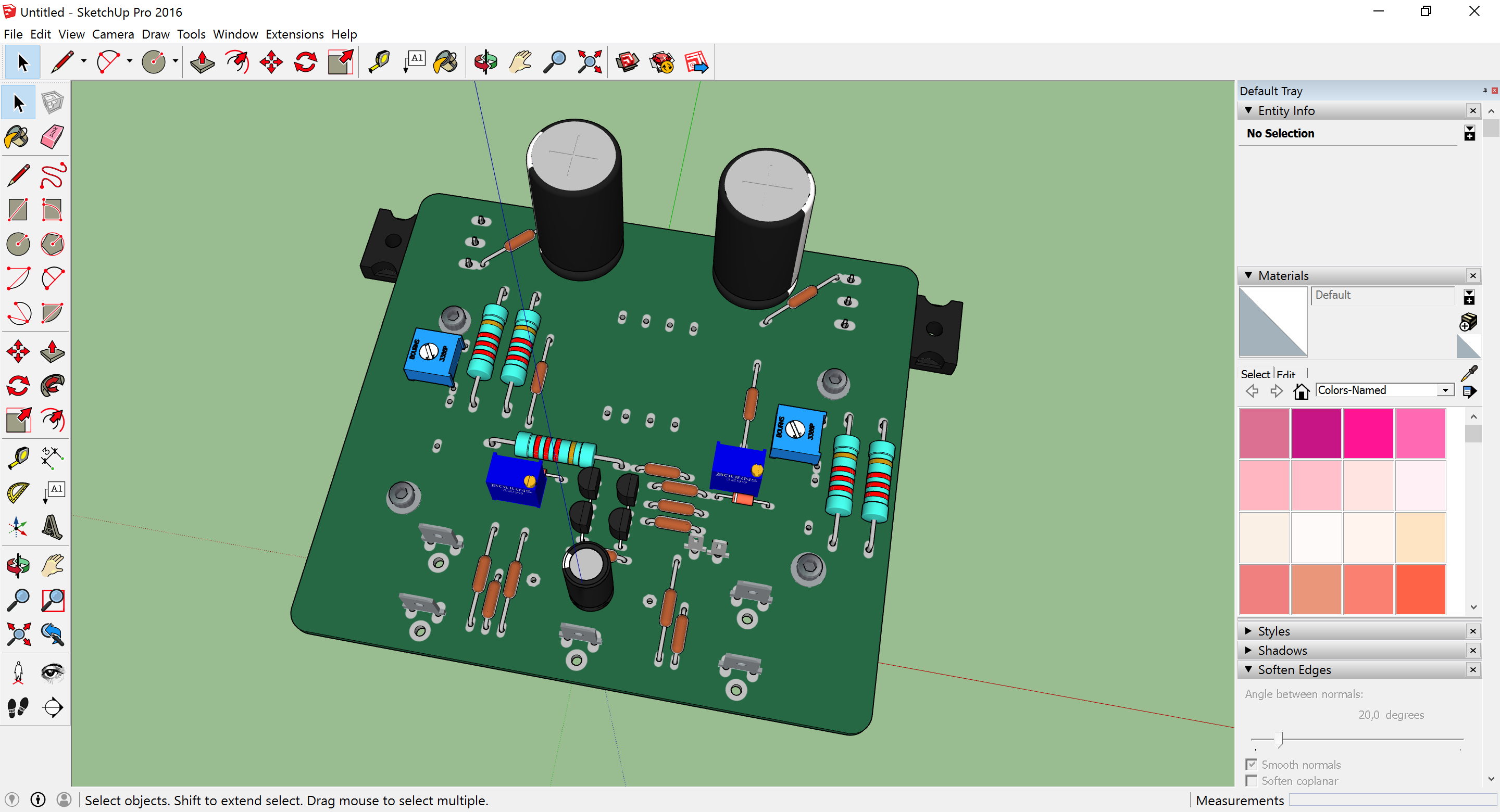

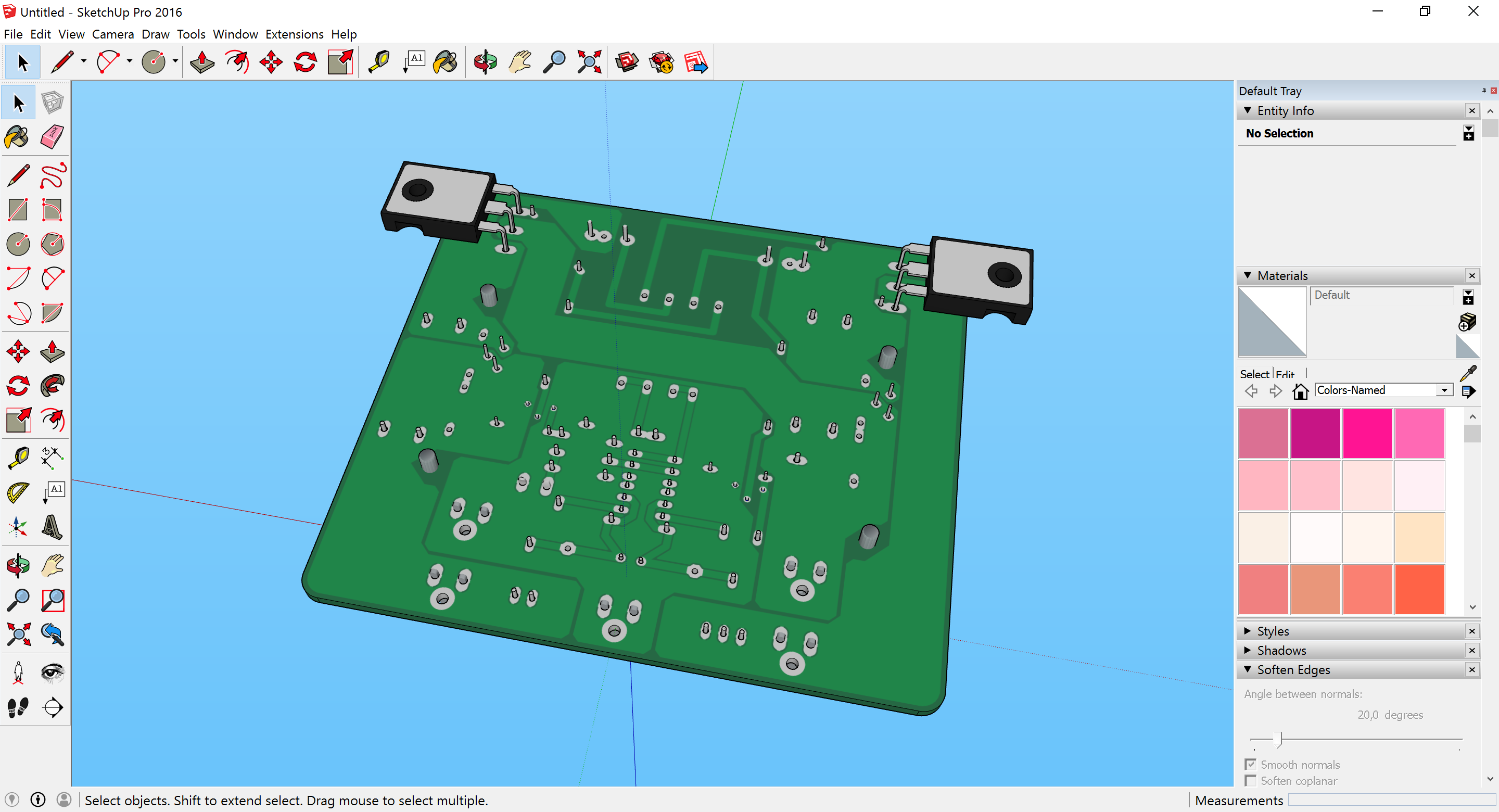

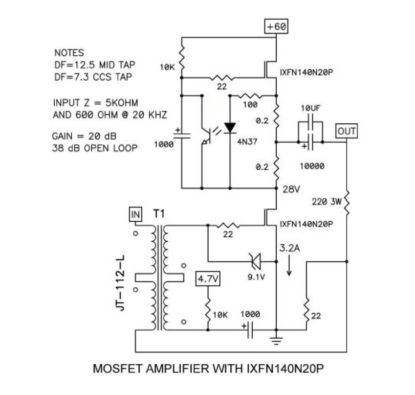

@2 picoDumbs working on cascode suggestion.
Still waiting for PCF modification!
JP

R18 R19 R20 R21 are to indicate cmf55 resistors, but some people might prefer a trimpot, there is probably plenty of room for both options. Anything between 50 Ohms and 100 Ohms is appropriate. For people wanting the original circuit just place links across R18, R20.
Add links across q1 q2 for people who don't want cascode.
I'm intending to use D grade LSK170/J74, so intend to use these heatsinks WA-T247-101E Ohmite | Fans, Thermal Management | DigiKey
I will test first to make sure they are appropriate.
