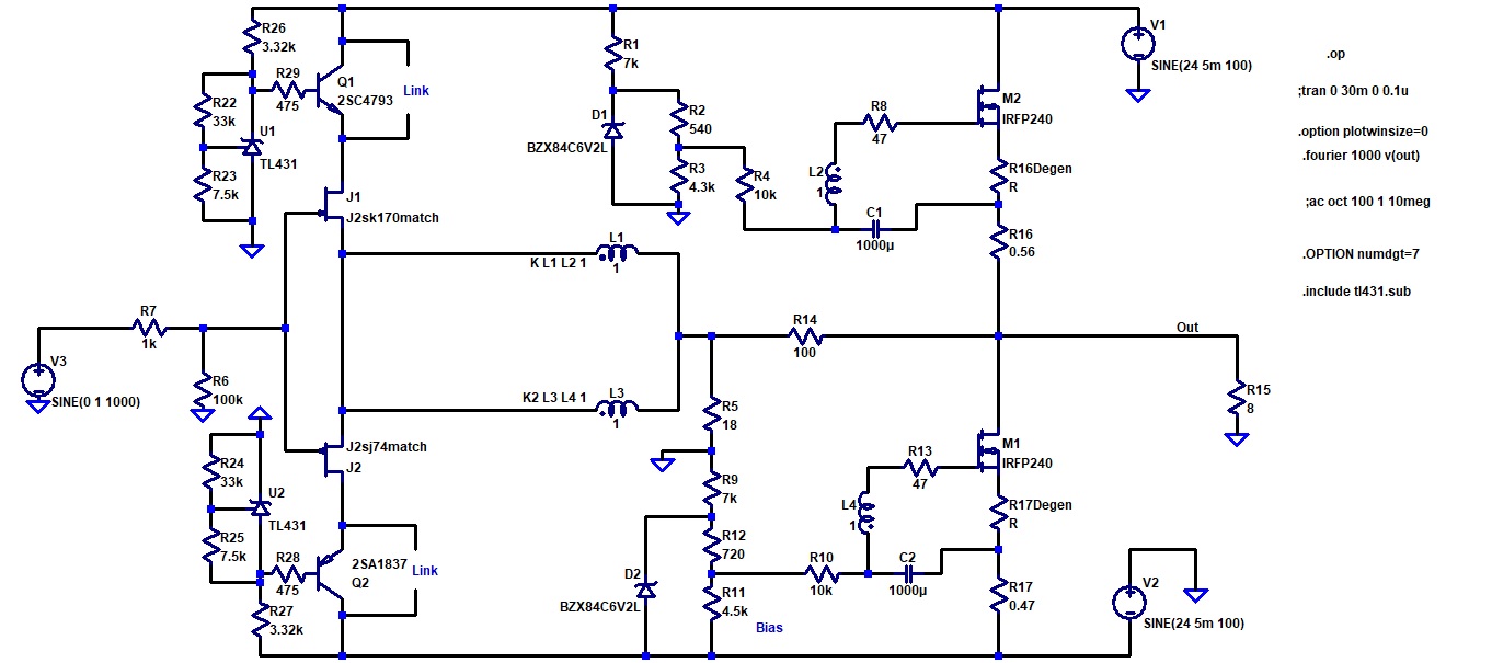

I think I prefer this option for degenerating at the output, it's simpler.

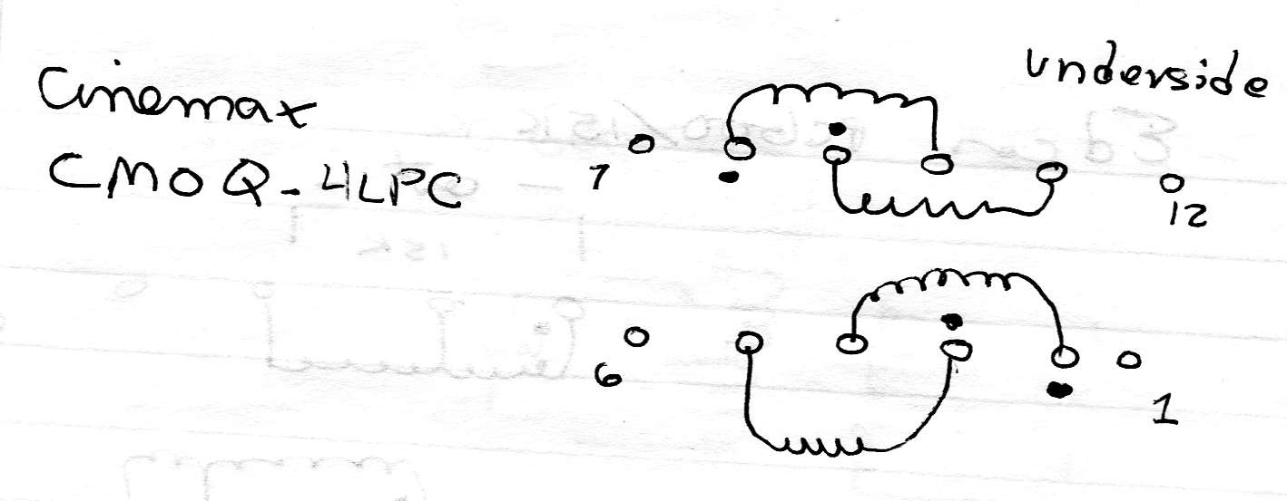

Schematics, placement.

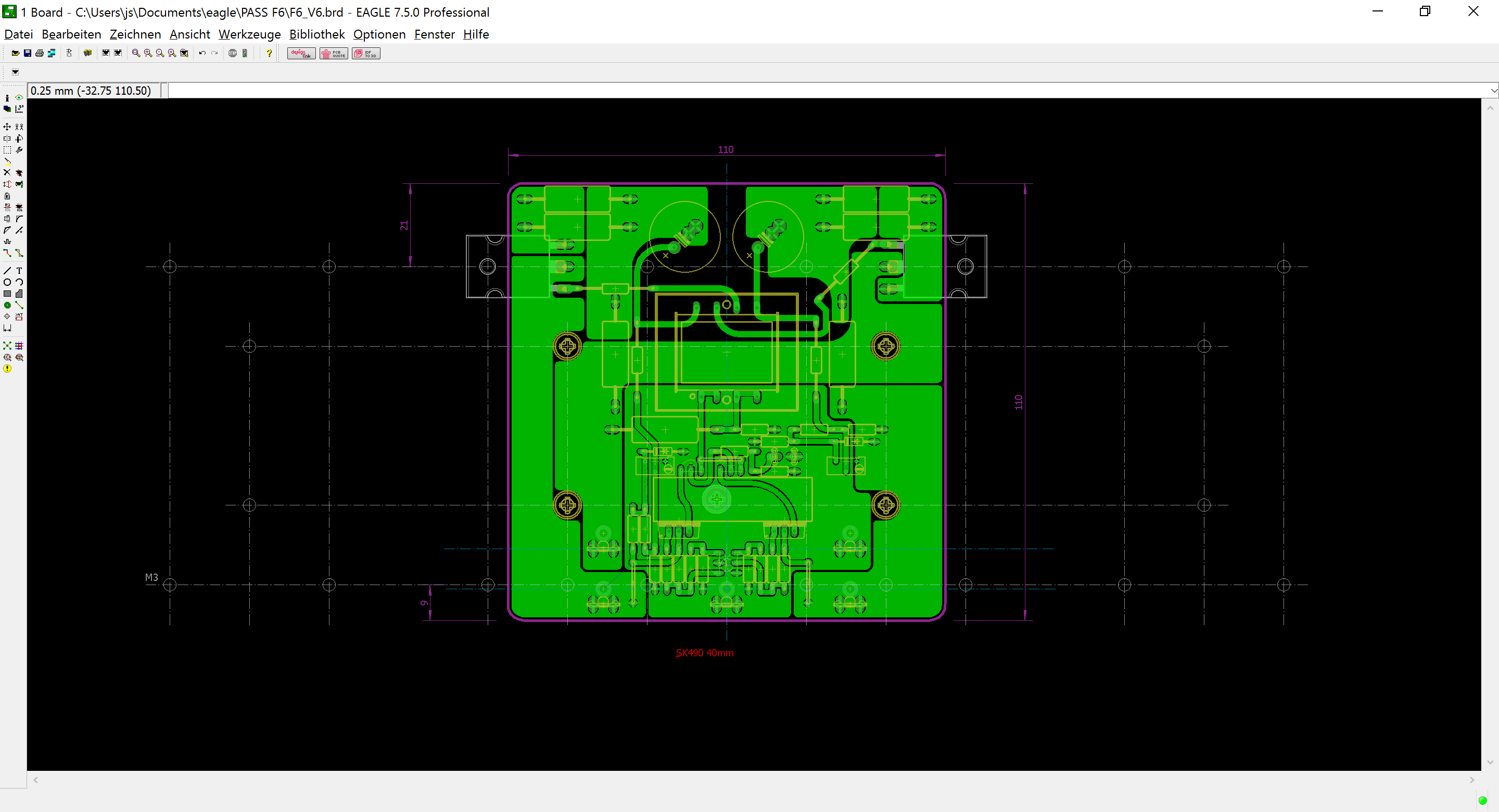

I´m using Fischer Elektronik SK490 40mm for TO92 and TO220 transistor mounting using clip.
Still no information about pinning Cinemag transformer in PCB version (E24 core transformer 3D model)!
JP

R133 R134 R124 R125 are unnecessary, although someone may prefer to set bias with fixed resistors, and use trimpot for dc offset.
If there is room you can leave them in, if you're struggling for space it would be ok to remove them.
I haven't checked pinout of jt123 flpch.
Are you sure it is pin 1 and 3 and pin 2 and 4 and not 1 and 2 and pin 3 and 4.
Looking very nice.

Thanks you Mr. Pass but only colours for wired version defined. Missing winding allocation to PCB pins 1 to 12.
This is the underside view from my notebook, pin 1 being on the corner
where the two pins are closer together and numbering in rotation around
the transformer so that pin 12 is across from pin 1.

Thank you Mr.Pass, PDF document corrected by CineMag.

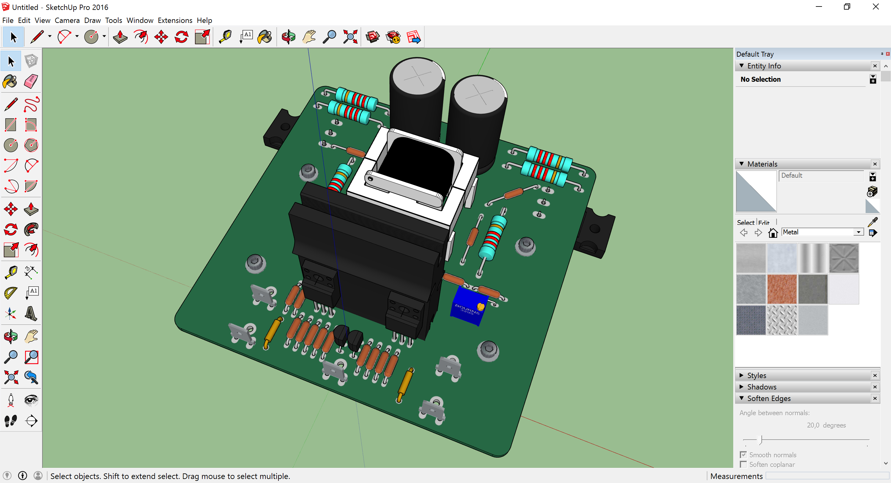

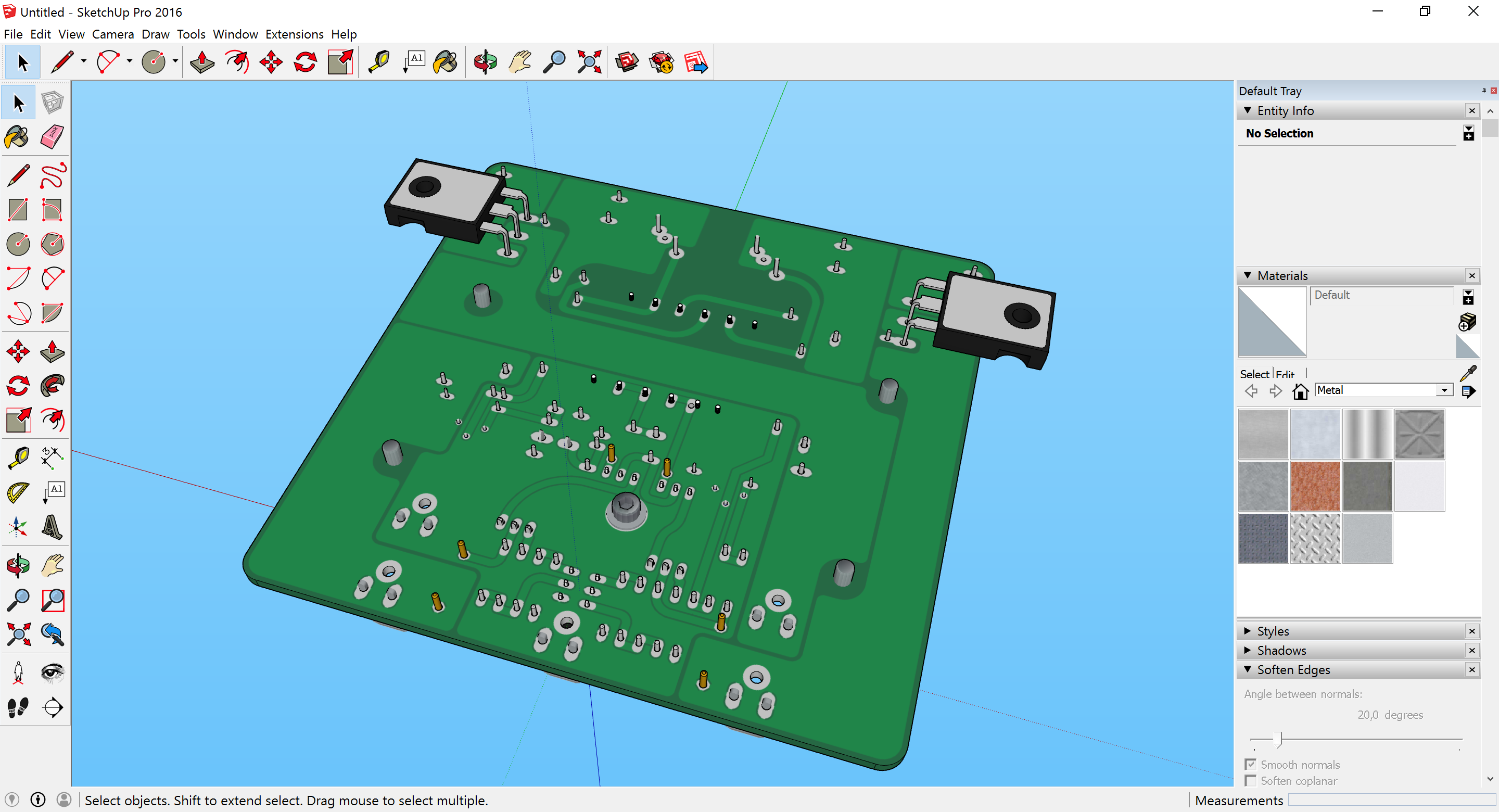

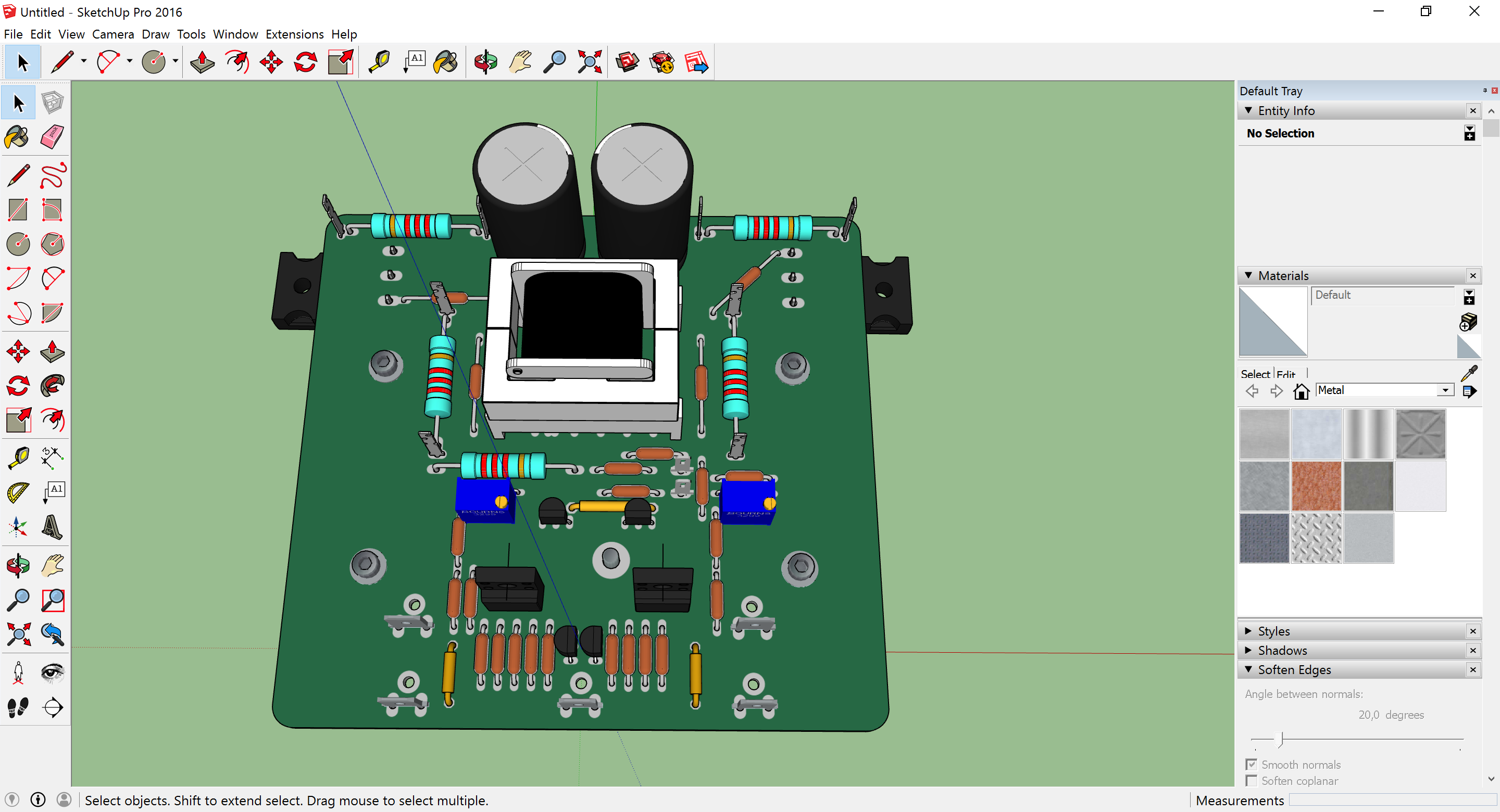

I´ve create a part wich fits both Jensen and CineMag.
Power resistors could be paralleled, PCB dimensions are 110x103x2mm.
Attached last version, heatsink omitted.
Waiting for comments.
JP
only 7.5mm lead space?
Will check trimpot placement, I´m not sure using SK490 (too high) but definitely screwed retaining springs.
http://www.fischerelektronik.de/web_fischer/en_GB/heatsinks/A06/Retaining%20springs%20for%20transistors/PR/THFM_/$productCard/dimensionParameters/index.xhtml
JP
