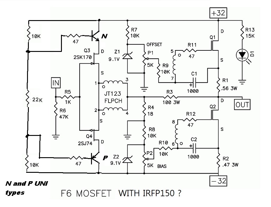

Is this "new" F6 been tested "musicaly" and "sonically" and mesured before , or it is one more F6 on the road , and what 's Nitrous for , I did not follow the entire story !!!
just wonder if it's a step forward
You can make it sound anyway you want.
You can build it exactly like the original circuit or any of the variations in the F6 article or even with 40V rails if you wanted, that's the reason for adding nitrous.

here it goes
BC546/556 ,BC547/557 , BC550/560 , ZTX450/550
also - increase mosfet gate resistors to , say, 220R
