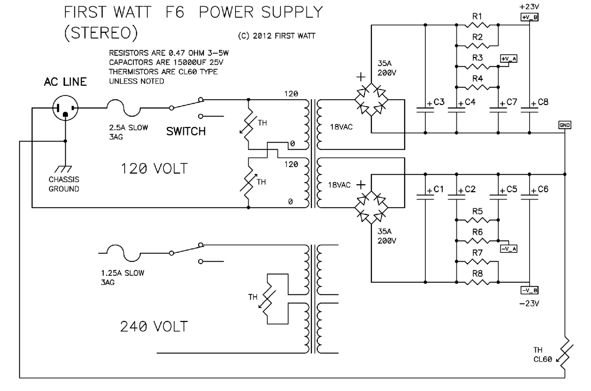

Hi has anyone implementet the stereo version of the FW powersupply presented in the F6 burning amp notes (see attachement)?
I find it interesting as half of the Rs and the last Cs are dedicated to each channel. Does this in any way benefit e.g. with regards to channel separation (stereo perspective, which is good on the F6 already

Thanks ZM I´ll leave this issue
. I was looking for the reason/intent behind this design.
Ill try dual mono in my M2 build (2x200 VA would be enough?), I already have the std supply working well in my F6 using a 400VA toroid.
just go for it
or go dual mono ; several examples on my blog
in short -one channel :mains fuse, 250VA Donut , two bridges , 4 pcs 33mF/25Vdc
each channel having own CL60 from audio gnd to case
so , just power cord, IEC and switch are common for both channels
Sleep is overratedintent is better channel separation , better dynamic behavior , smaller ripple , etc.
M2 , being on cooler side - 200VA per channel should be enough
ignore fact that I chose 250VA as lowest value I use , mostly better sleep being the reason
However my persistence regarding the schematic (see +V_A, +V_B and -V_A, -V_B in my earlier attachment ) was the nagging feeling/hope that one could get 70-80% of the benefits of mono supplies from this single stereo supply with no additional cost.

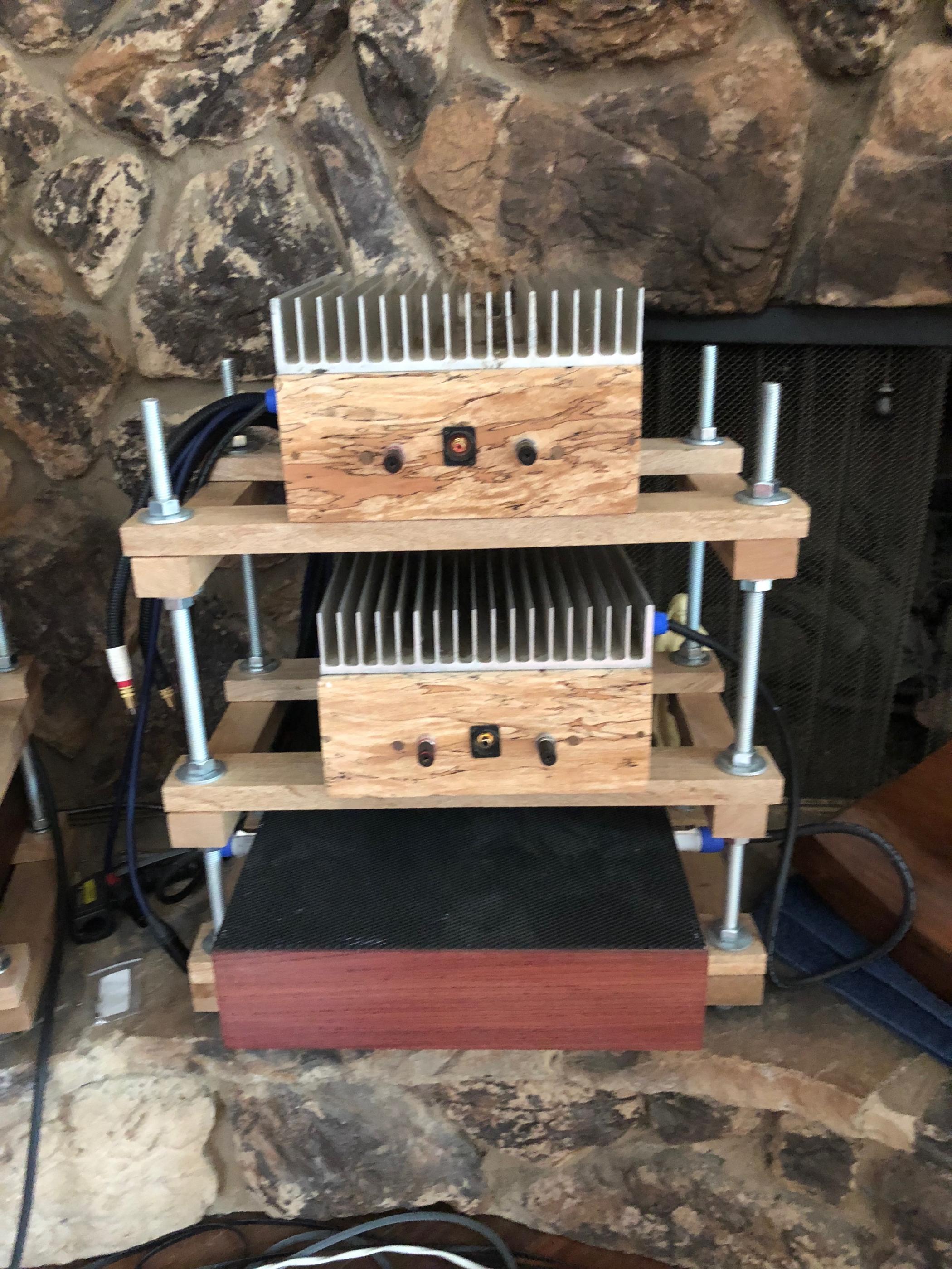

I have both +/-23V and +/-29V umbilical power supplies. Both are dual mono. The 23V supply is CLC while the 29V is CRC. Standard NP supplies
In attached pics the 23V is used for my SUSY F6 and M2. The 29V is for VFeT2.
M2x will be tried with both.
I think the real advantage is that you can build different amps without having to replicate power supplies.
