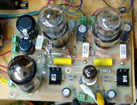

I created a PC board for the 12AT7- 6L6 (or others) amp design. One amplifier is playing nicely. I have been at work 50 to 60 hours / week for the last month. This will continue for at least 3 more weeks. Little time for tube stuff!

What happened to tubelab.com's Ultimate El Cheapo SE? I thought it was a great idea.
It is ALIVE!
I decided to leave the 6AV5's for the push pull project, since some of them tend to glow brightly when pushed by the constant dissipation of SE mode. The new amp design uses 6L6's, EL-34's or KT-88's. I run them at 410 volts across the tube, and get as much as 14 watts (KT-88) in UL mode. I plan to send this board out for duplication later this week.

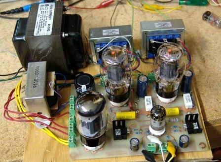

Another picture of the completed prototype amp. It is assembled on the piece of plywood that the Edcor transformers came on.
Some more info is available on the web page.
http://www.tubelab.com/SimpleSE.htm

Looks good Tublab,
I like the plywood! I think it was the model T... Henry Ford had his engineers design and specify the crate that 2nd party suppliers had to use to ship starter motors to the Ford plant. The crates were then dissambled and used in the construction of the coil box assembly.

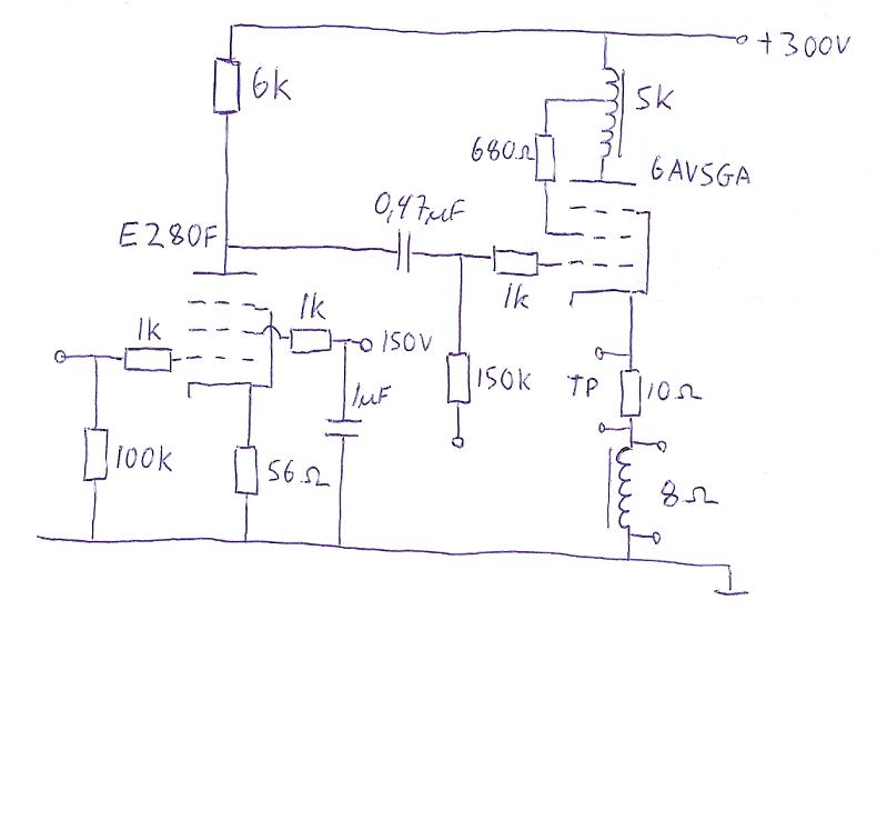

I´m about to begin a 6AV5/Edcor project soon, not that I don´t have enough valve amps already but most of them are rather experimental and more or less unsafe to handle...
What I need is a compact, low cost amp capable of producing great sound and a decent amount of power, so Sylvania 6AV5GA in UL with CFB seems to be a good choice.
My ambition is to add switches for the CFB and for UL/triode operation, but if (when) I get lazy during the construction they will be the first to go...

Try tying the 1uF E280F screen bypass cap to the top of the cathode resistor instead of ground.
If you have gain to spare, you could try connecting the E280F plate resistor to the opt screen tap instead of B+ to give an E-Linear type arrangment. This will reduce distortion, increase bandwith, and improve the amps driving ability by lowering its output impedance.

Yes, there might be some changes around the G2 arrangements of the input tubes. My first idea was to use a capacitance multiplier to drop the rail voltage to 150V, but at a closer look the HV winding is centertapped and in it´s original application the CT was used to supply half the B+ to the screen grids of the output tubes.
If the cathode feedback is not enough the next step will be E-linear.
