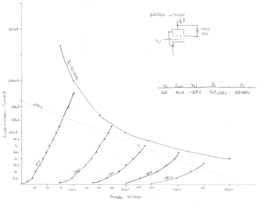

Hi, quick question. I've got my hands on some of the older GE type 6AV5's and am considering a Mikael style SET/UL amp, but was wondering if a 6N1P with a gain of 30 could drive the 6AV5 to full power. I'd like to use fixed bias. What kind of range should I have for bias adjustment? Up to -40V or so? This would be using an XSE15-16-5K with 8 ohm speakers.

It has been too long since I did all of the 6AV5 experiments, and I wasn't smart enough to write everything down. I wired the 6AV5 into a TubelabSE which uses a single 5842 for a driver. I had no problem driving the 6AV5 to clipping. The 5842 has a Mu of 40 or 44 depending on whose data sheet you read. I am also using a CCS load so the stage gain is about 40. I think that the 6N1P with a resistor load may be a bit low on gain. As mentioned, the 12AT7 should be OK.
When I tested the 6AV5's I found that some could handle 350 volts, but most could not. 300 volts is safe for most of them. The plate voltage is not the issue, the screen voltage is. Check carefully for any signs of glowing grid wires. If the screen grid wires are glowing the tube will not live long.
I don't have the exact bias readings written down, but my guess is that you will need more than -40 volts. My amp goes from -10 to -60 volts.

Did some experiments the other day and decided to do triode curves of a 6AV5, and now to share it with you all
I may regret this later when these tubes all go for mad $.
Pardon the slight sloppyness...I don't own a curve tracer beyond that of a few meters and power supplies.
