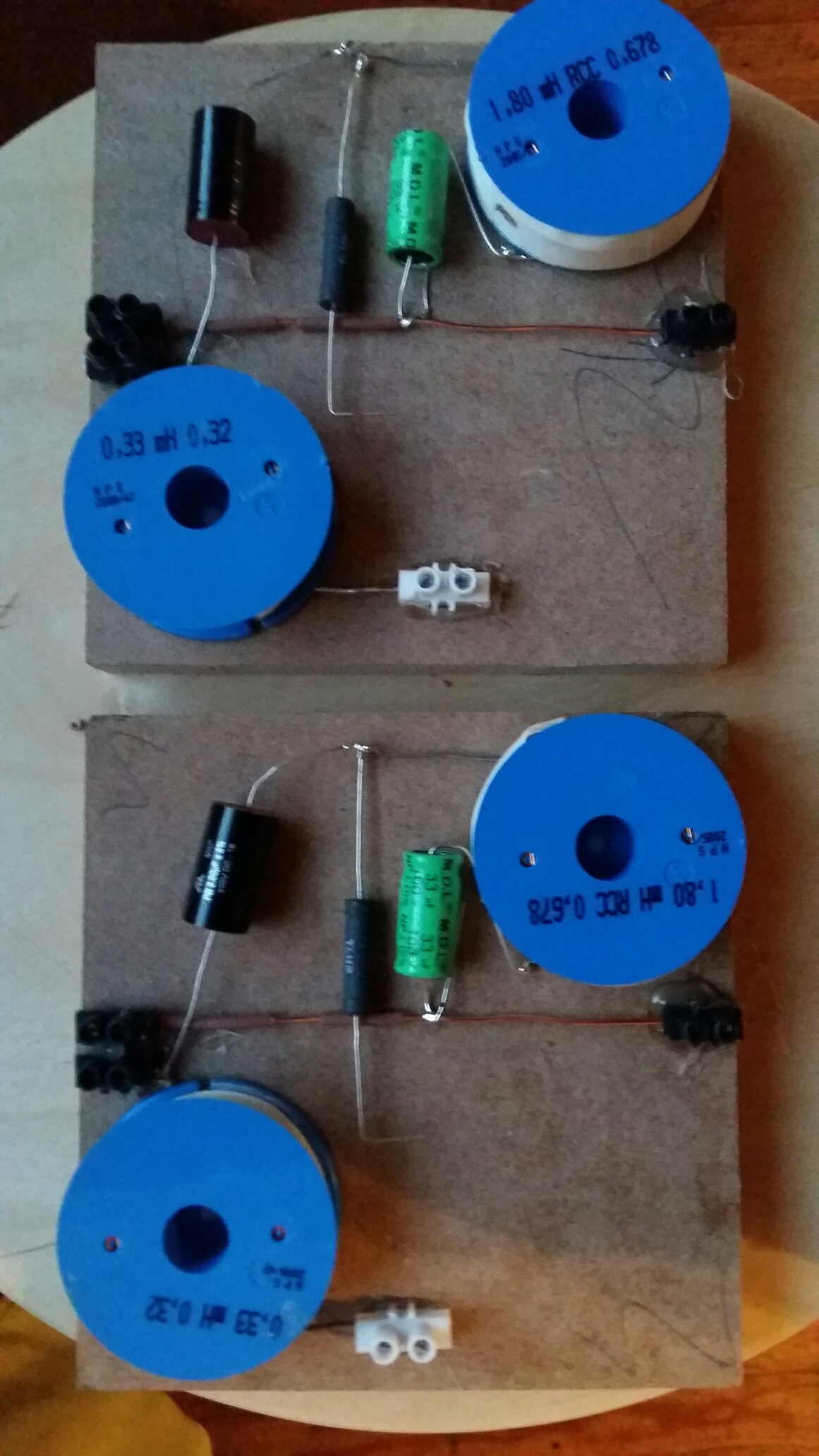

If you go back through this thread you will see that I realized my error and corrected it by re orientating all the inductors on this pcb. I have since made two pcb's for the crossover with the HF and LF sections on separate boards with all inductors separated and orientated for minimum cross coupling. the original was my first attempt but since then I have learned a great deal from wise people on this forum.

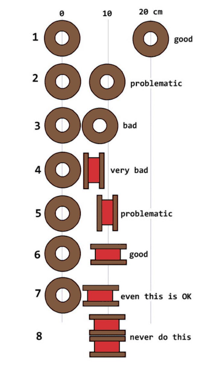

I don't mean to seem harsh, but, this is a good example of how not to place inductors - it's better to space them apart more, but particularly important when they're this closely space is to have each inductor perpendicular to the ones near it.
Here is an often replicated image illustrating the point:
